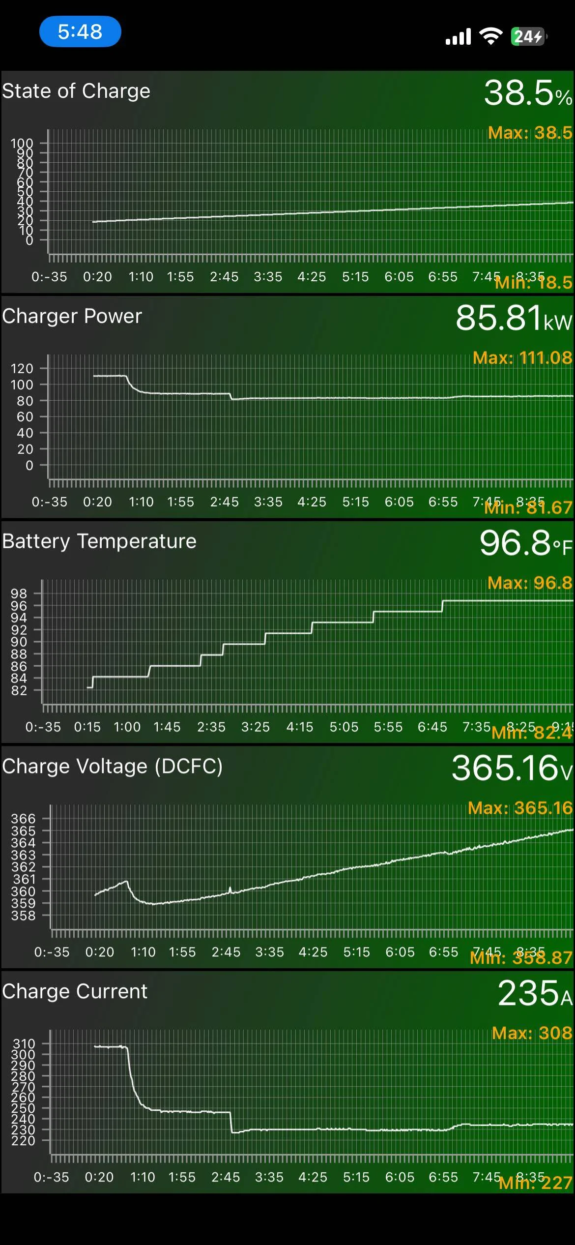

Make sure you precondition en route to a charger (at least 20 min, especially if it’s cold). I have a 2021 Select and when I precondition, I would say 9 out of 10 times I instantly peak at 115 kW when below 30ish percent and then its pretty stable at 80-90 kW on EA chargers.
