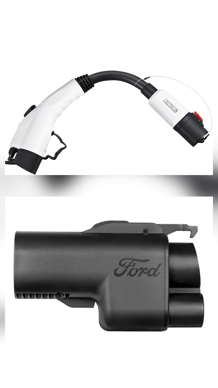

A Tesla to J1772 charging adapter is available from Walmart. It's marked down from $100 to only $17. The adapter gets outstanding reviews, to boot! Also, I use a $22 "no-name" adapter purchased from Ebay and it has worked perfectly for every charge. Search the forum for reports on the Lectron and the A2Z adapters and then decide for yourself.

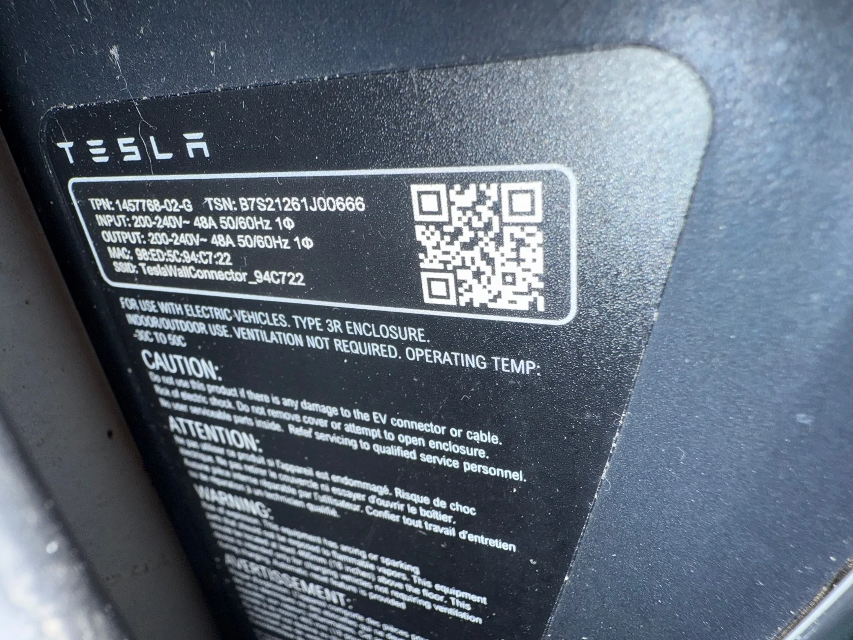

Thanks all for your responses. We knew our first trip charging would contain some adventures - headed out in a bit to a supercharger and breakfast to top up before heading home. For insight - we are in NC - this was a white small charger at a Holiday Inn - I used my Lechtron adapter recommended on here and it fit in that (https://a.co/d/9XxjbHs) It is in fact a supercharger adapter, but it fit and activated the wall unit to cycle to blue and then green and then blue and then it failed on my side. I took a picture of the side so I could reference later to see how I would know it wouldn’t work (The QR code didn’t work)
Looking back this wasn’t in the FordPass - so perhaps that should have been my clue?
Looking forward to mastery of charging but for now excited to drive again.

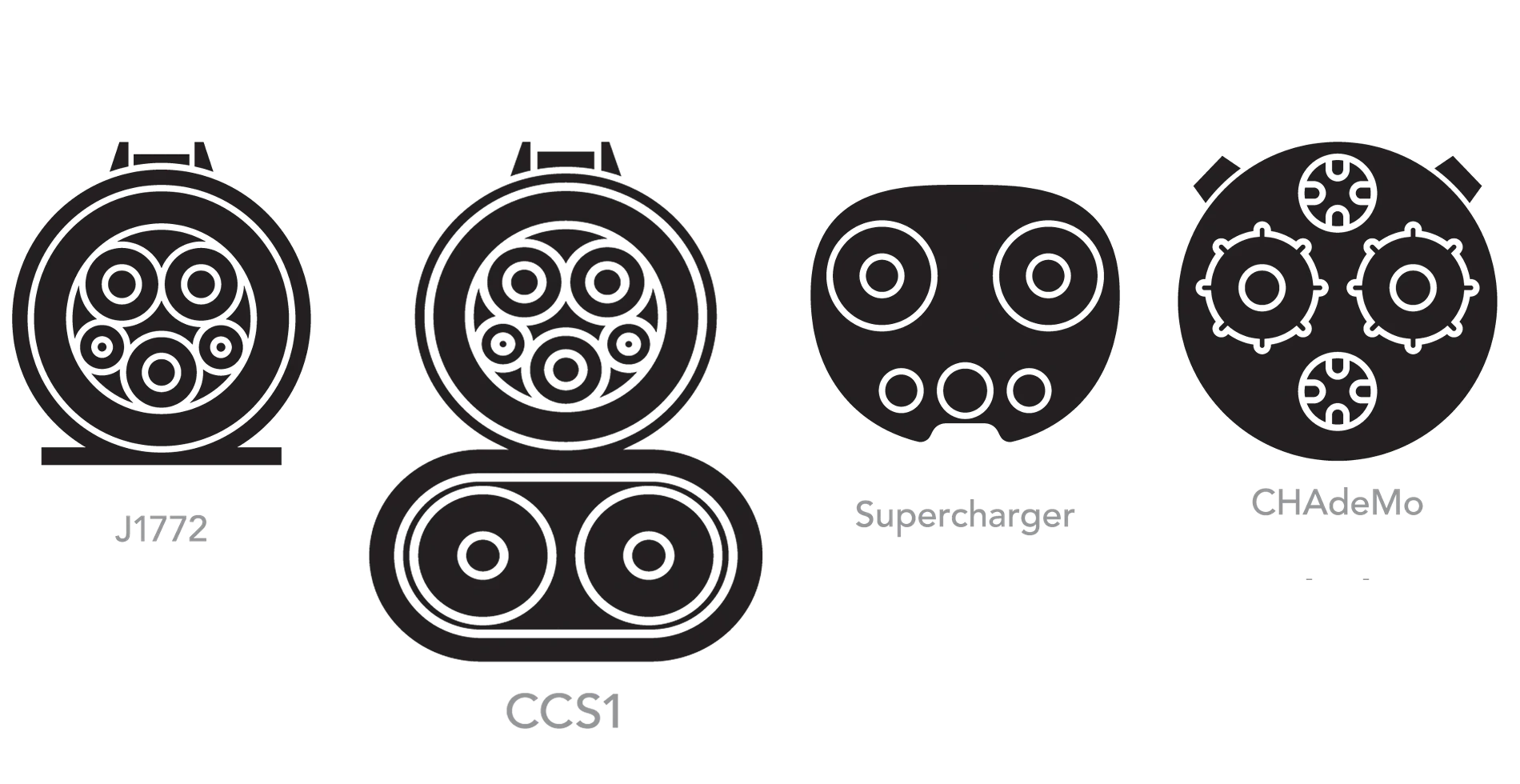

Tesla has a unique connector on their hoses. The same connector is used on Tesla SuperChargers as on Tesla Destination Chargers.
On our vehicles, there are two ports. The top round port is called J1772. Then, when you open the flap, the entire port is called CCS1.
To convert Tesla to J1772 requires a special adapter, which is NOT the one you have. So, yes, the Tesla plug fits in your SuperCharger adapter, but the pins it's powering are the bottom CCS1 pins, which are not used by level 2 charging. Hence, your failure to charge.
As I stated in my first reply, you need to buy a Stellar adapter. 10% off with code FORDFORUM. https://a2zevshop.com/collections/charging-adapters/products/a2z-stellar-plug?ref=Typhoon
