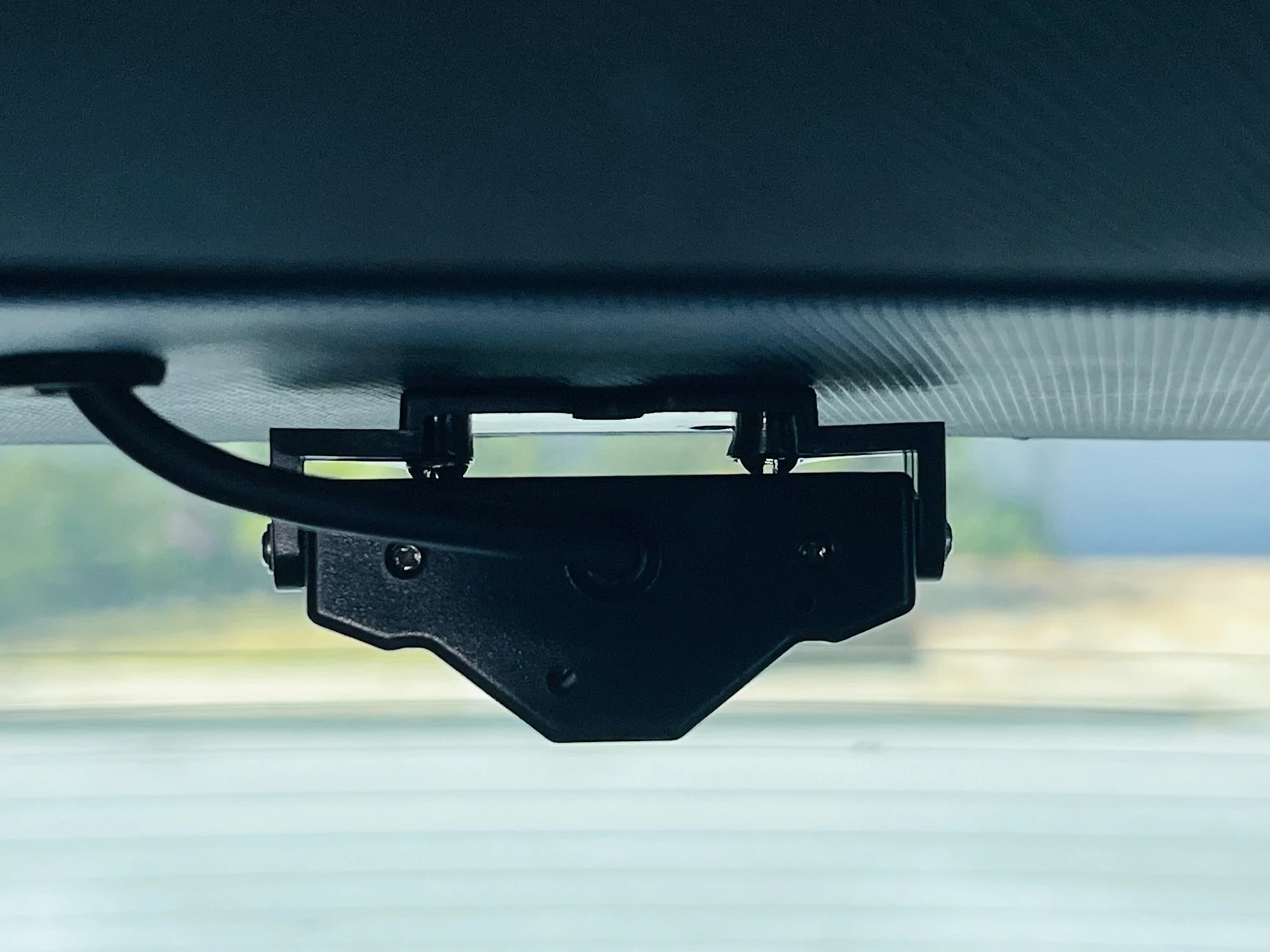

I have installed a couple of these in my 2021 and my 2024. Not a big deal. I do not believe that a front/rear setup should be powered through the mirror circuit so I also hard wired the power to the fuse box in the footwell. The worst thing was mounting the rear camera in my 2024 since they changed the design and I did not want to mount the thing to my tinted rear glass. I ended up fabricating a cantilever bracket so that I could mount the camera to the plastic trim. My older rear setup I could mount directly to the plastic trim. 😁🐩

I also have a '24 with front and rear dash cams (Viofo, not FitCam) and would love to see your cantilever bracket. I initially wanted to do an off-glass bracket thing for the rear cam but couldn't figure out a good design.

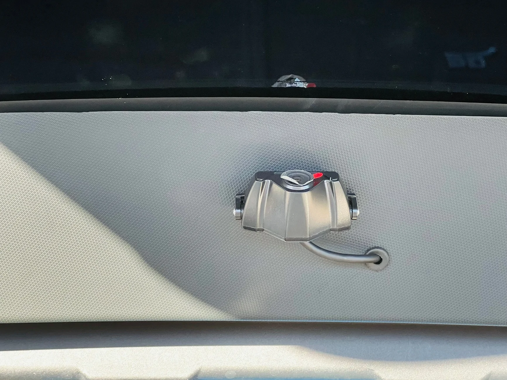

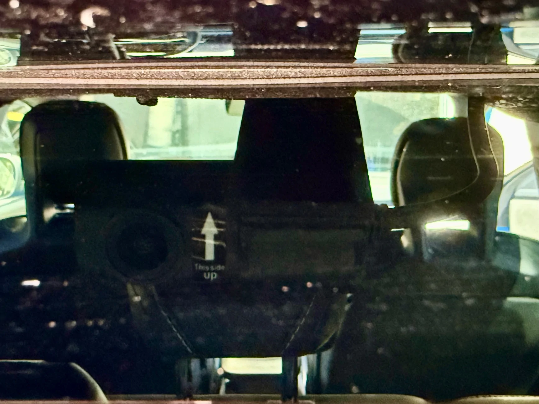

Here is the old setup, which I like better. 😁🐩

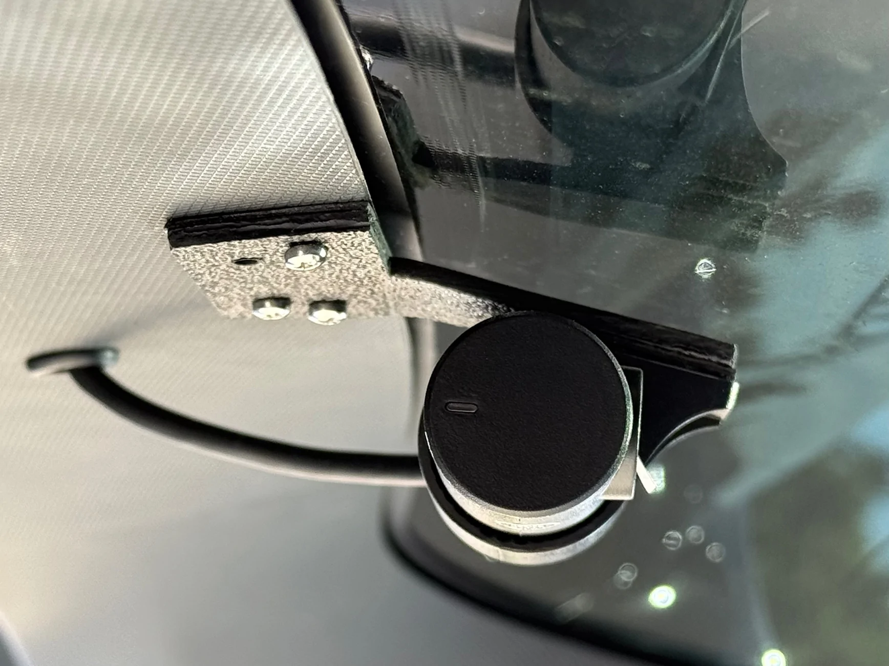

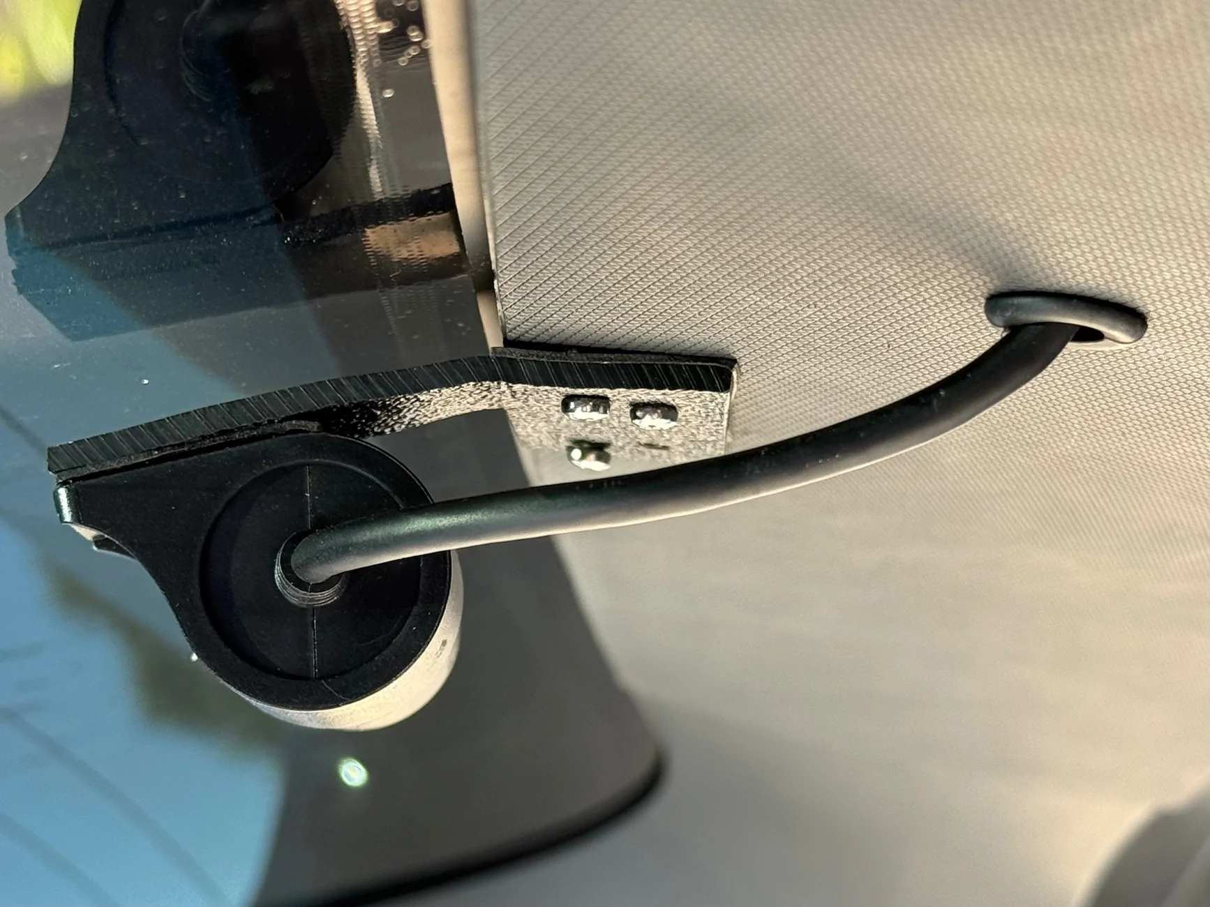

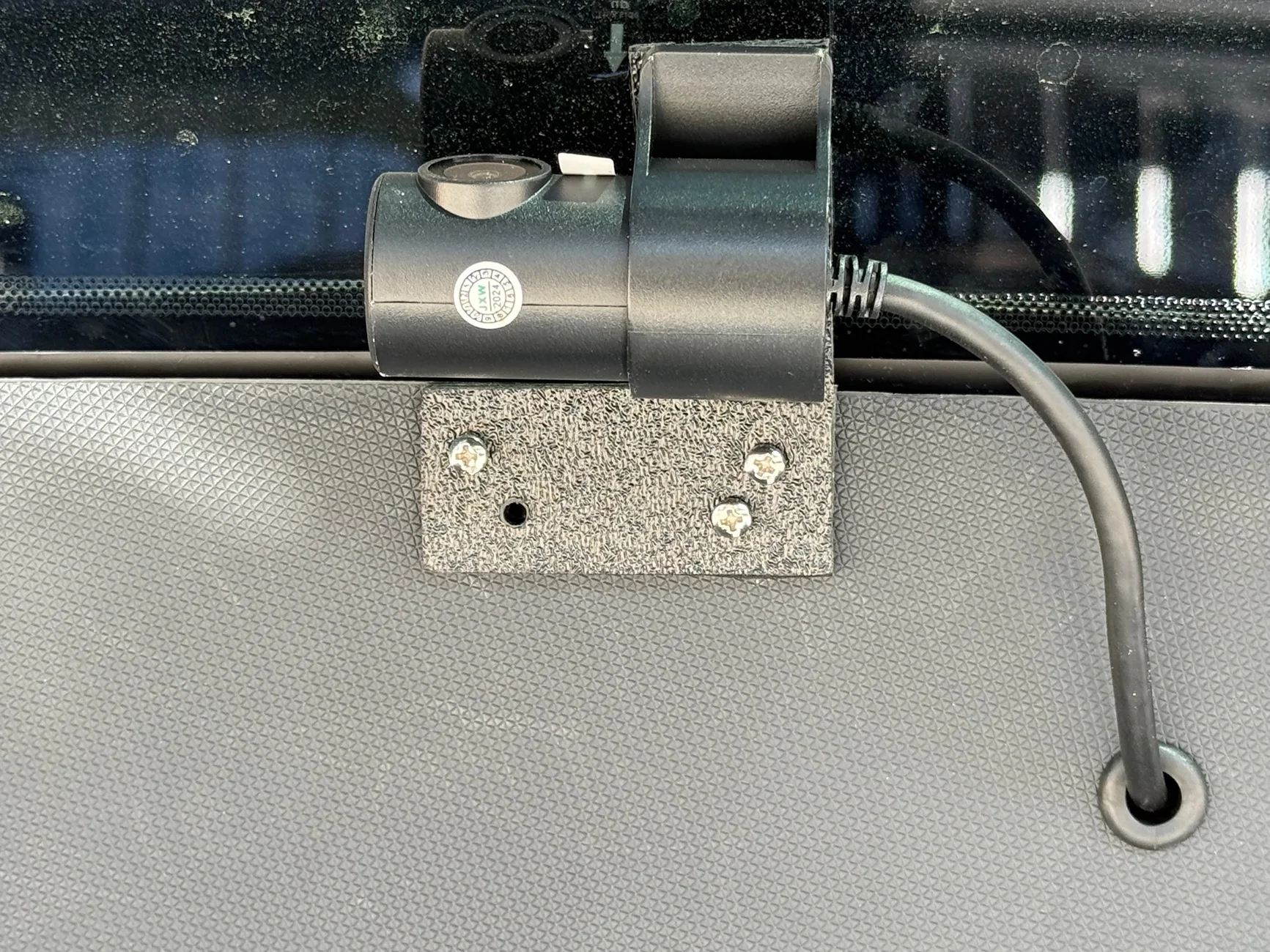

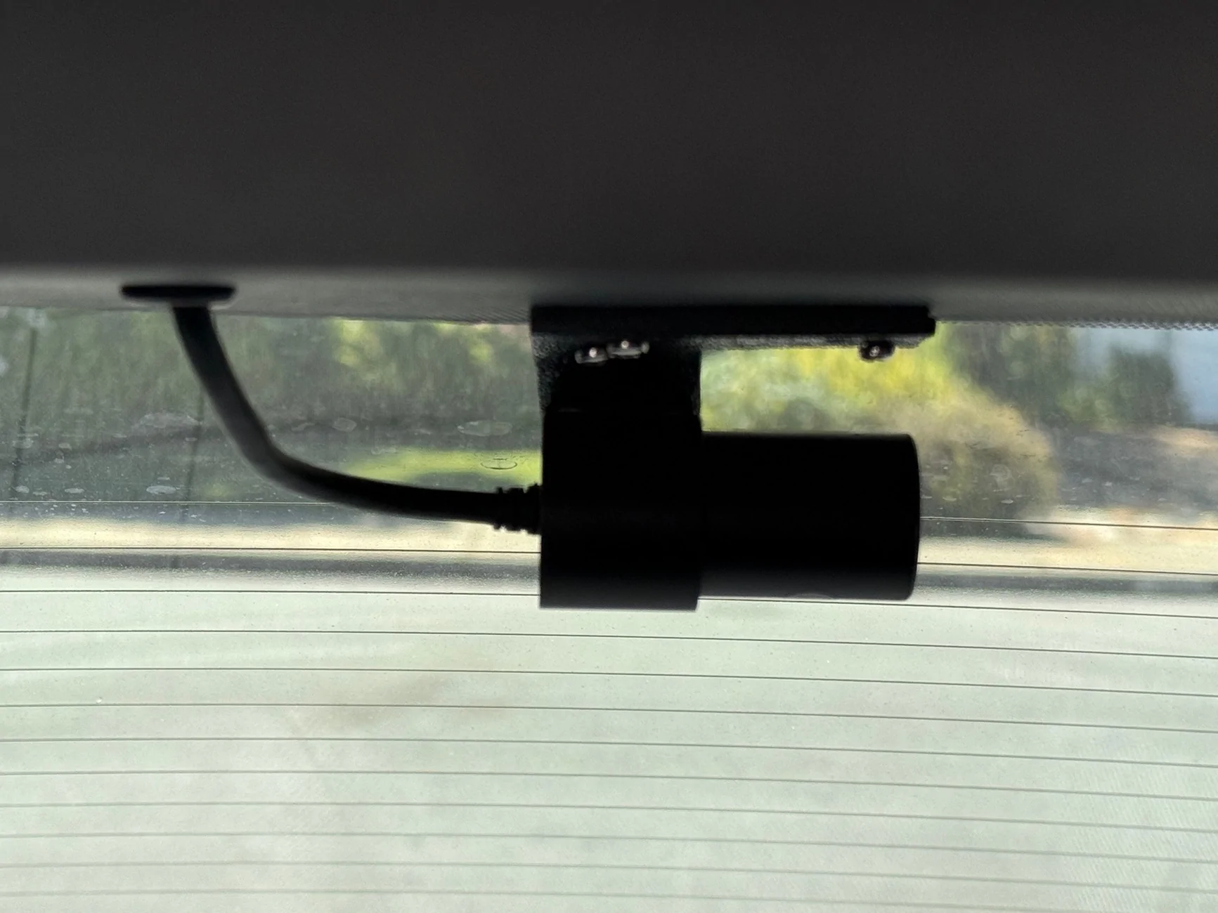

And a few photos of the new. 😊🐩
Ford Mustang Mach-E FitCamX Dash Cam installation? IMG_5540
Ford Mustang Mach-E FitCamX Dash Cam installation? IMG_5539
Ford Mustang Mach-E FitCamX Dash Cam installation? IMG_5541
Ford Mustang Mach-E FitCamX Dash Cam installation? IMG_5542
Ford Mustang Mach-E FitCamX Dash Cam installation? IMG_5543
Since the rear window has a curvature to it and the bracket is mounted off center so that the lens is centered, the bracket has a slight twist to it to keep the camera level-ish. I think it’s a few minutes of angle off. Bad sniper here. 🤣🐩
EDIT: In both cases I ran the rear camera cable through the flexible conduit on the passenger side, down the C-pillar, through the gutter on the passenger side, merged with the power cable near the fuse box, then up the A-pillar (behind the air bag), then through the headliner to the front camera. 😁🐩
