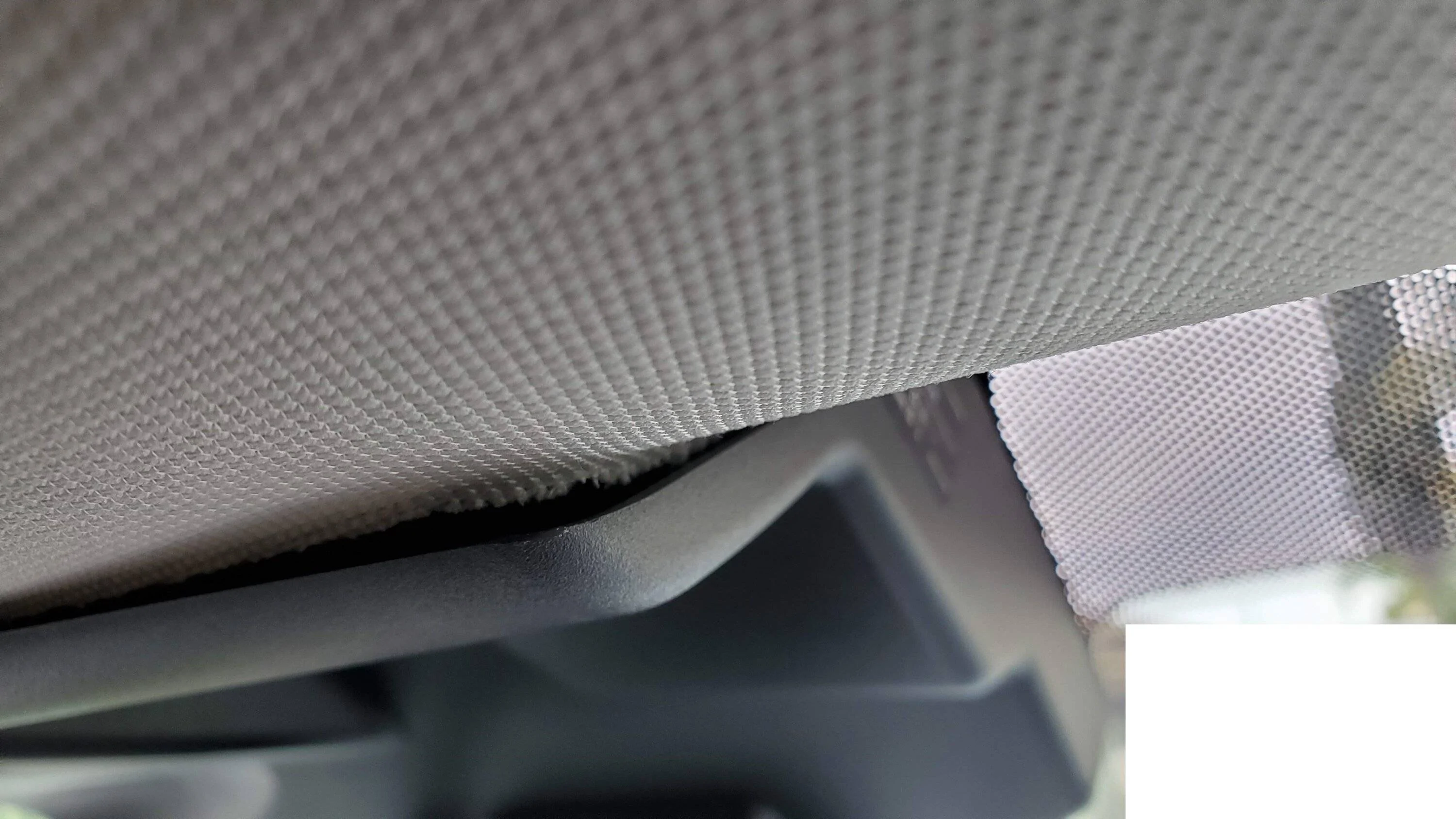

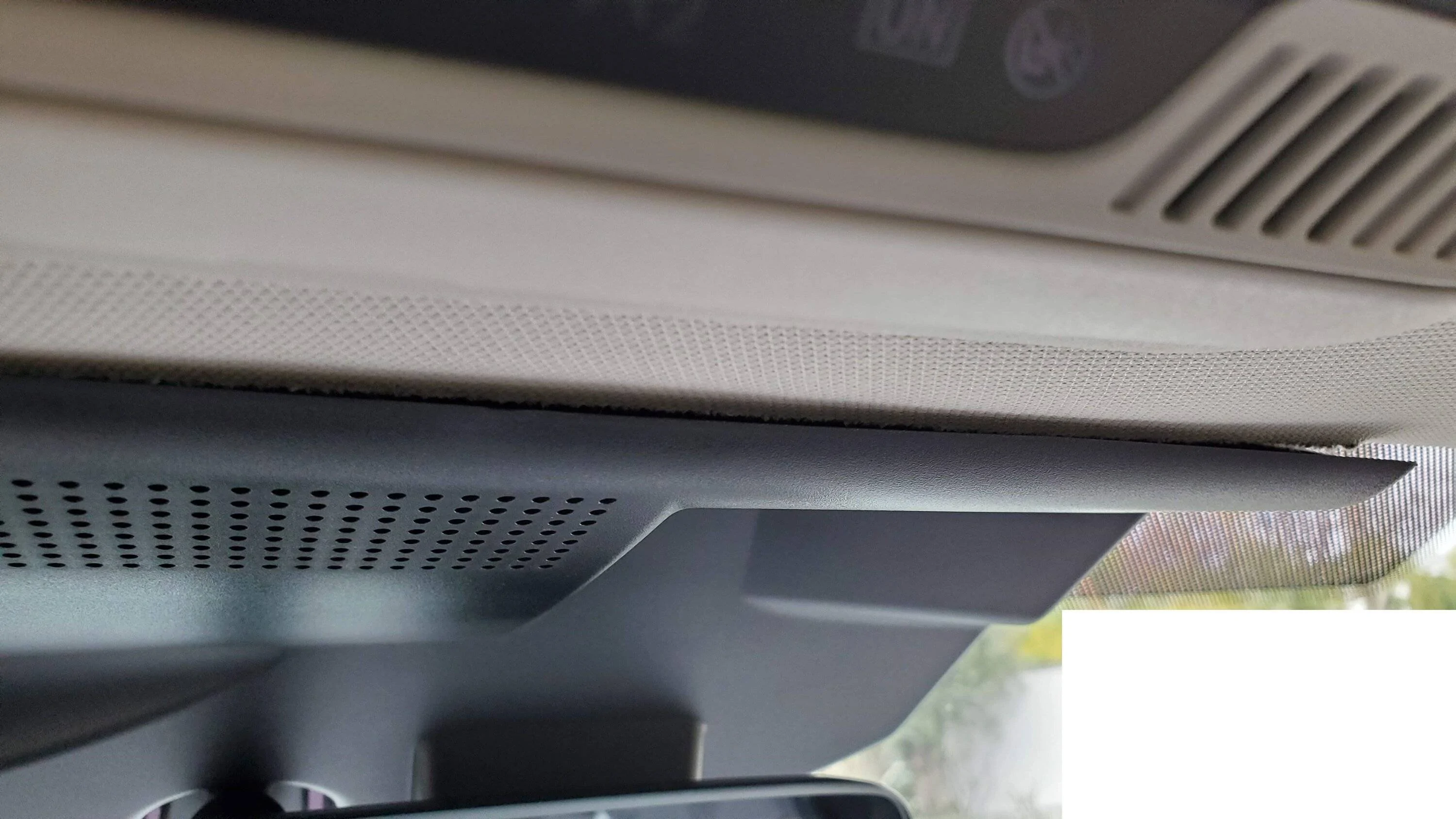

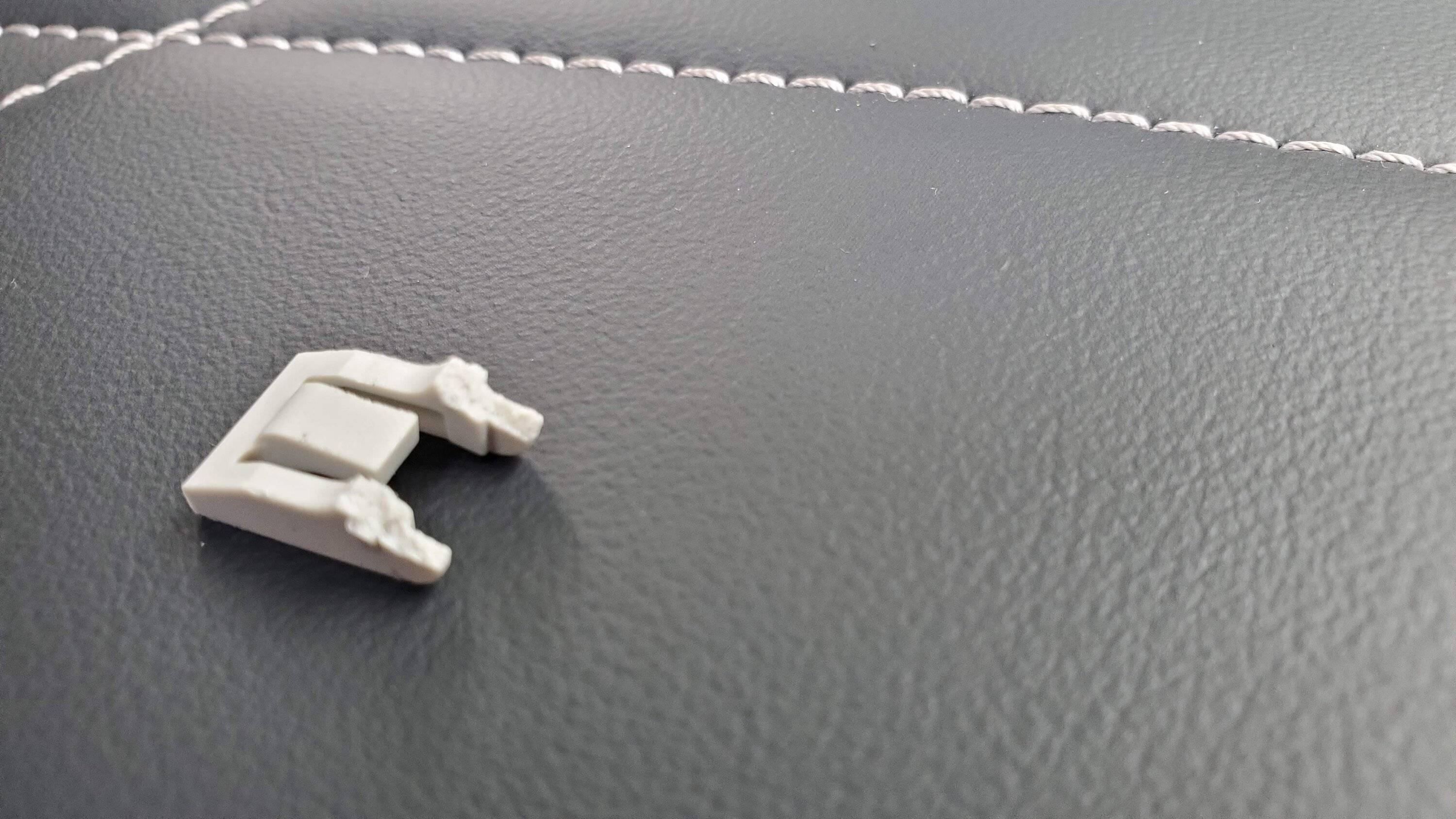

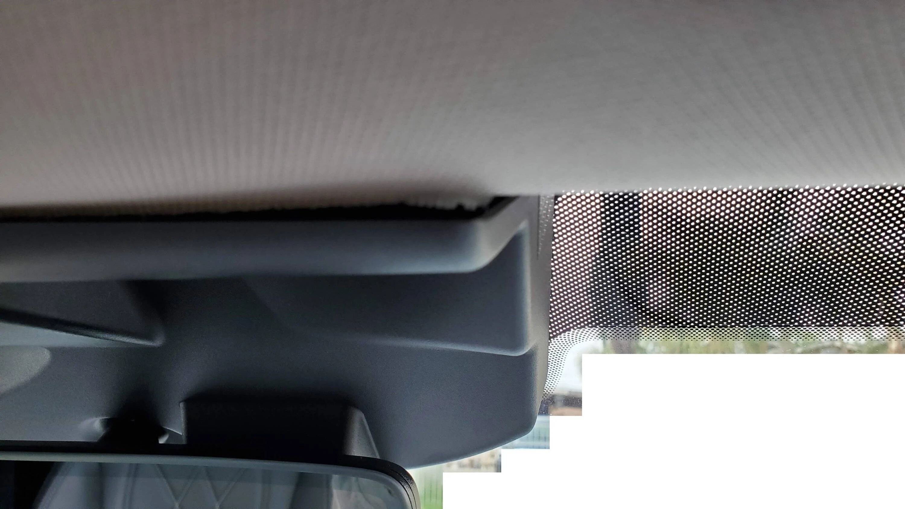

Just installed the Cam. When I was prying off the original plastic piece some plastic clip fell off from inside :( . How bad is it?
After installation all tabs seem to snap all the way in but there is still a gap between the plastic piece and the roof :(
See the original FitcamX thread. This is a known fitment issue. i used a heat gun to bend my plastic work and went too far. I relieved it some, but not enough. Nobody but can tell other than me. ?‍♂?

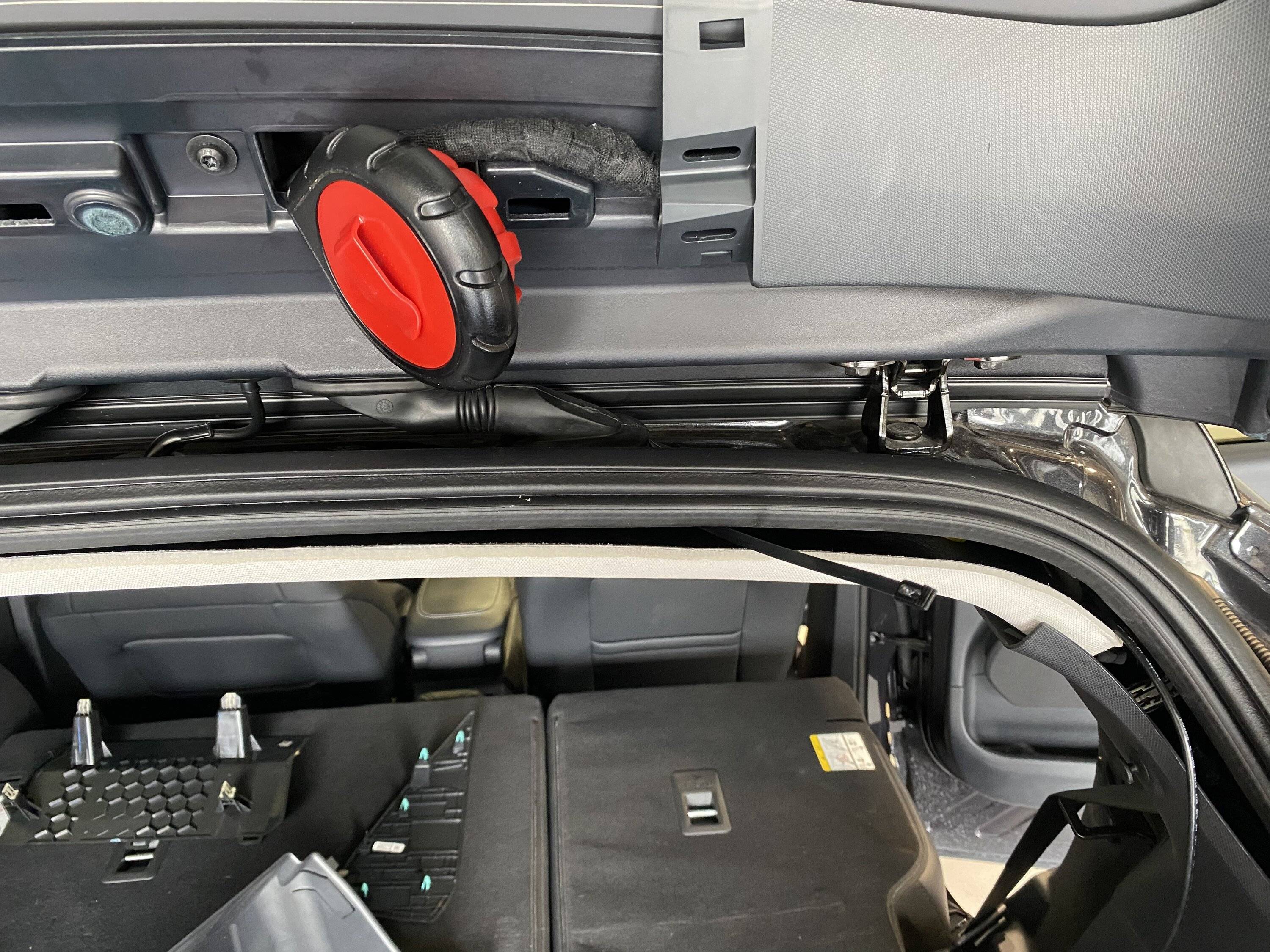

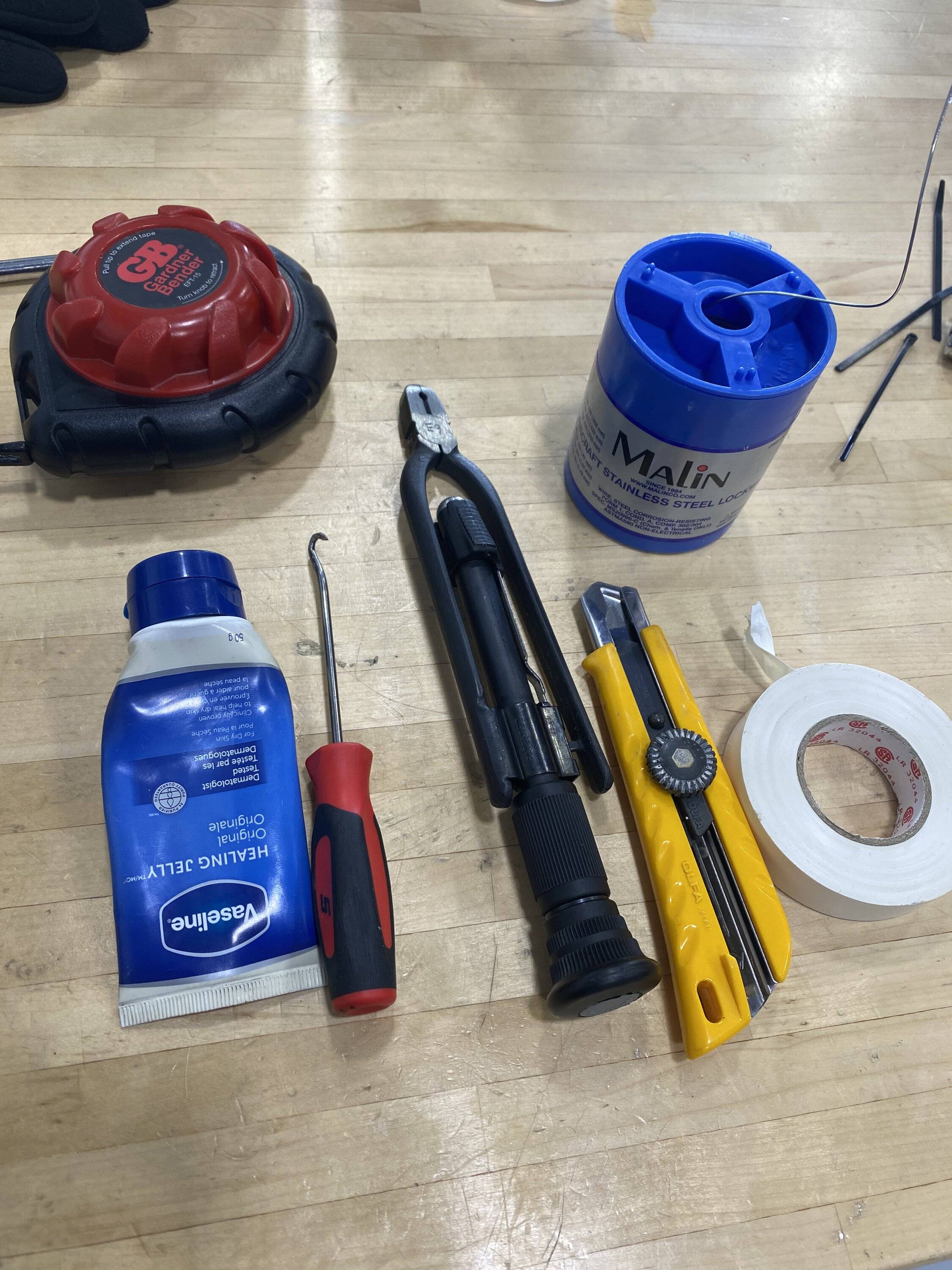

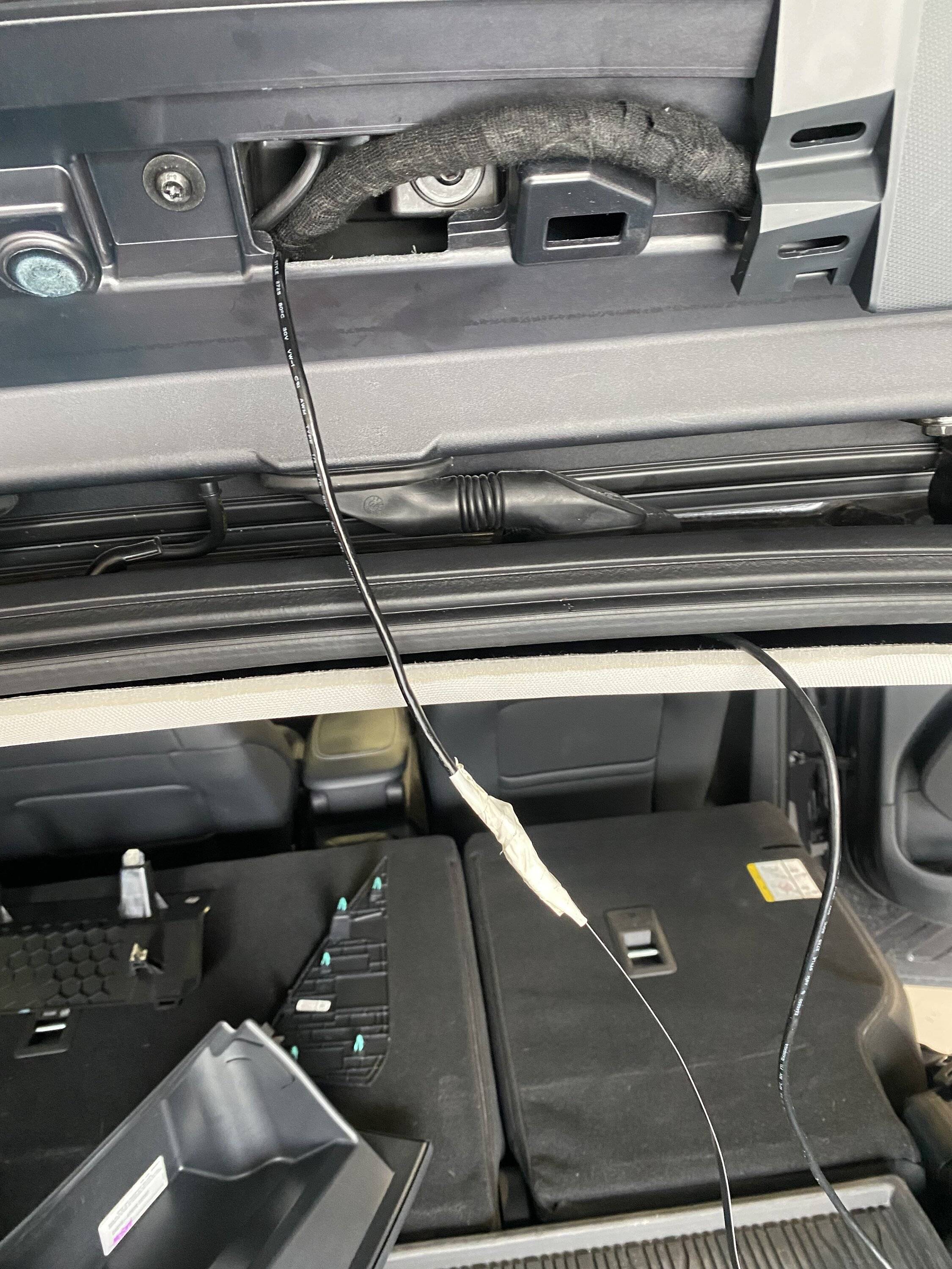

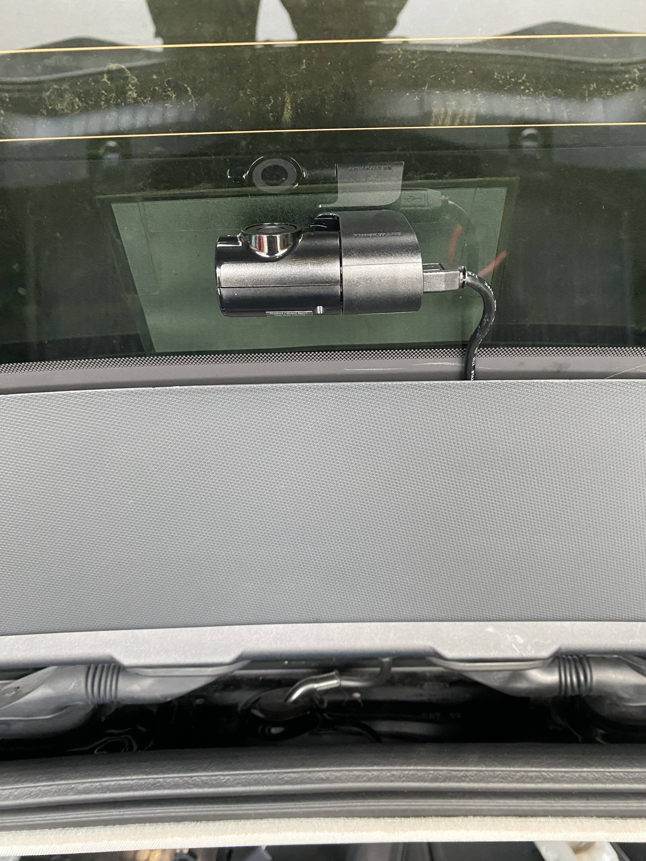

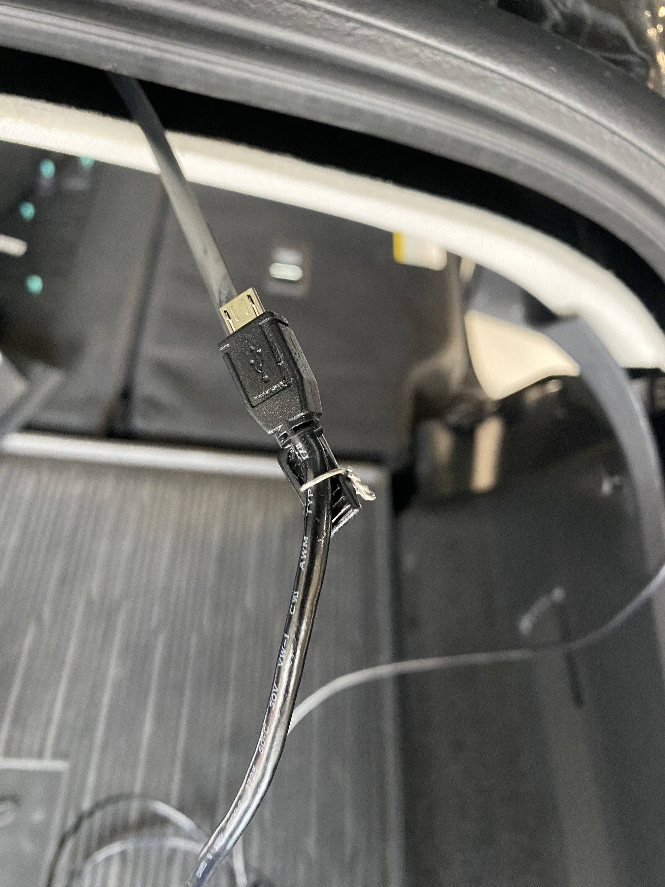

I finally got my Thinkware U1000 hard wired in. I used micro fuse 3 tap at fuse location 1-2 for ACC power, and micro fuse 2 tap at fuse location 24 for BATT. I found a good 10mm bolt for Ground at the structure just to the right of the cabin air filter. I tucked the rear camera wires under the trim at the floor.
My biggest pain, was trying to fish the wire through the rubber conduit at the rear lift gate. I used a Fish Tape lubed up with petroleum jelly and worked it beside the wiring bundle until it popped out the other side. Then I used lockwire to secure the rear cam cable to the fish tape end, wrapped it in electrical tape, lubed it up, and pulled it through. The rear camera peeks out just underneath my "EV OK" HOV sticker on the rear window. Works perfect with my new 16" wiper. Turned out good.
