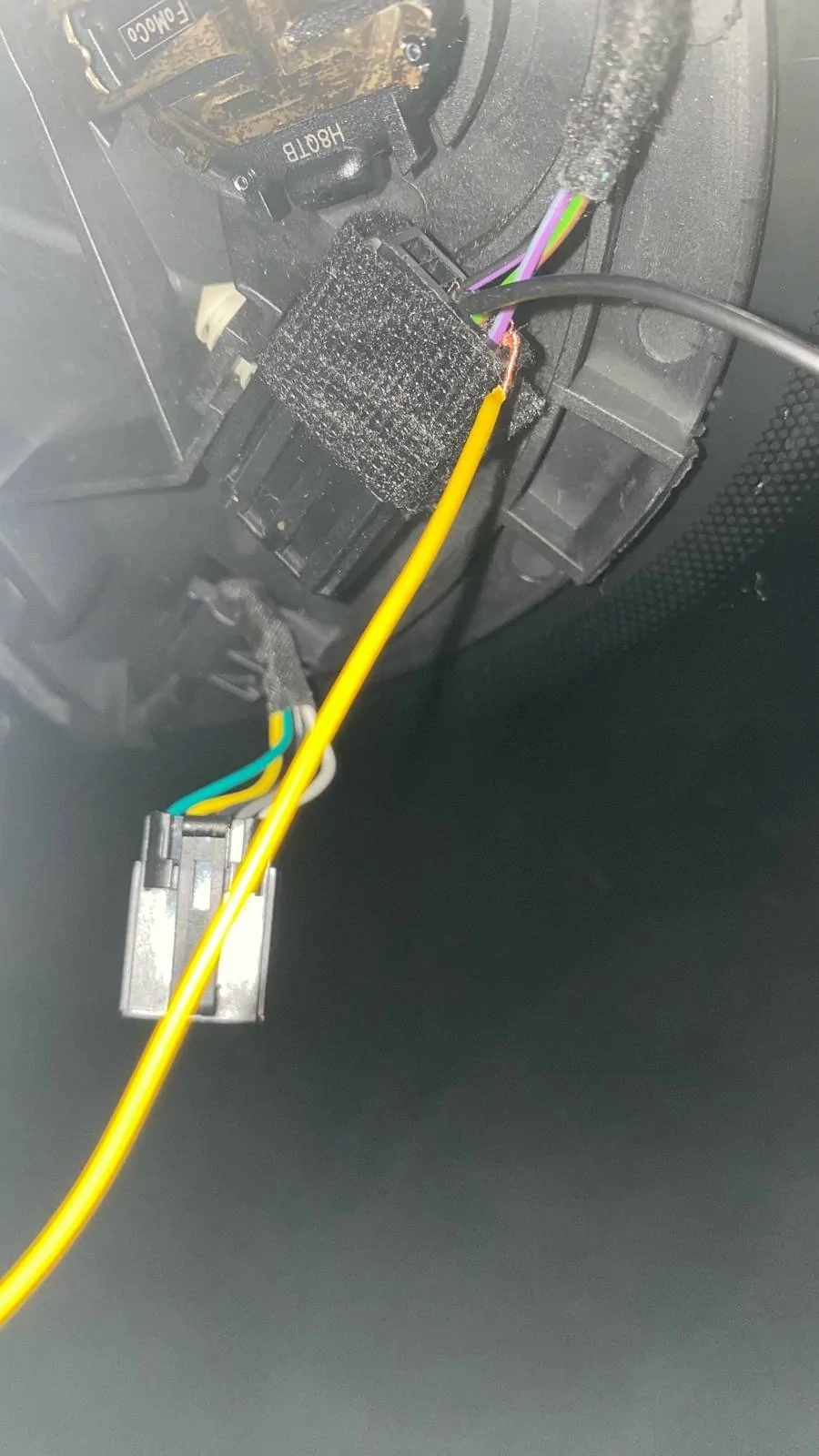

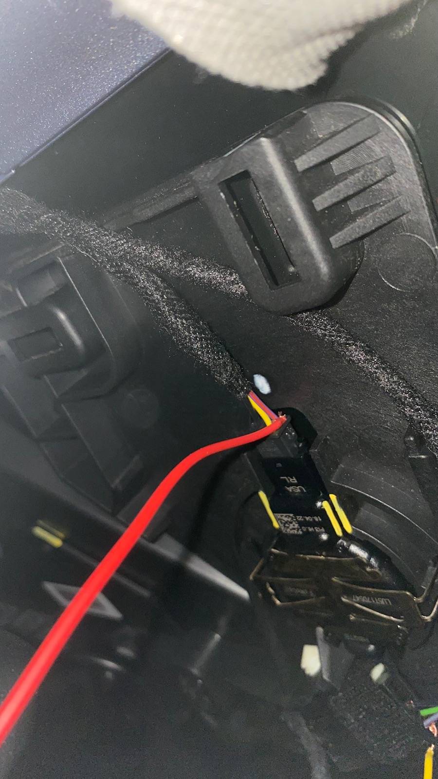

Then tapthe red acc wire of the dash cam into the rain sensor terminal, the yellow battery wire into whatever the socket which has 12v as long as the power is on, the black ground wire to the first left wire

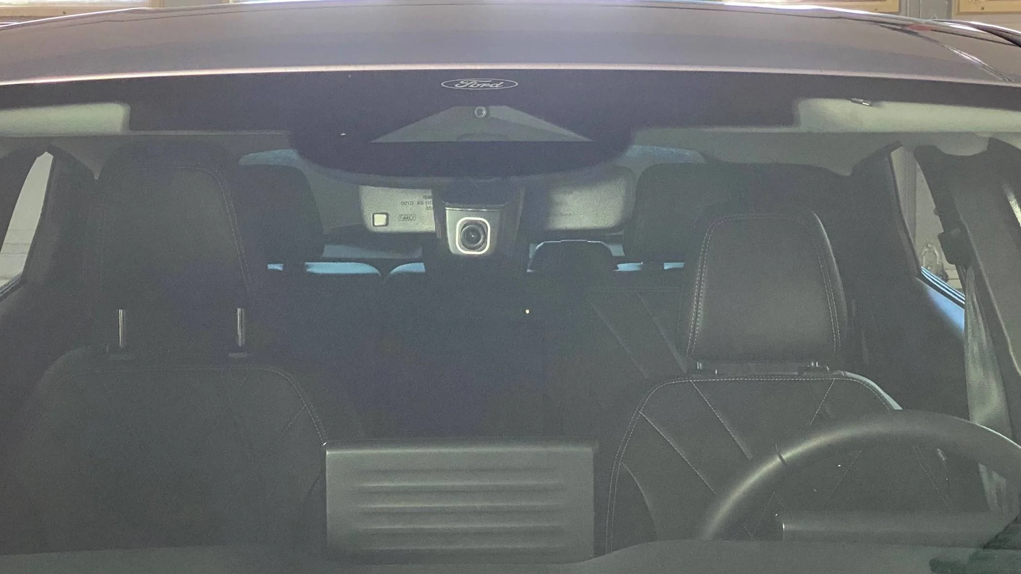

then fasten the power cord on the ceiling, put the cover back, stick the cam on the cover in front of the mirror. As long as Mack e power switch off there is no current goes to the cam. The quality of the cam wasn’t bad.
Twisting the wires and shoving them into the connectors with strands everywhere is a really poor way of wiring something in. If any of those strands touch you could get a short circuit. It's also not a reliable connection, so it may stop working.
I'd strongly recommend you use a legit way of wiring in a dashcam with a T-splice or a hardness adapter.

The photos shown were not the final tap. The final result are not the best but are much secured than what they looked in the photos. None of the wires is under any pulling force. So I’ll leave it as is. If it get loose I’ll try this way to save the space inside the cover. Thank you for the suggestion.
