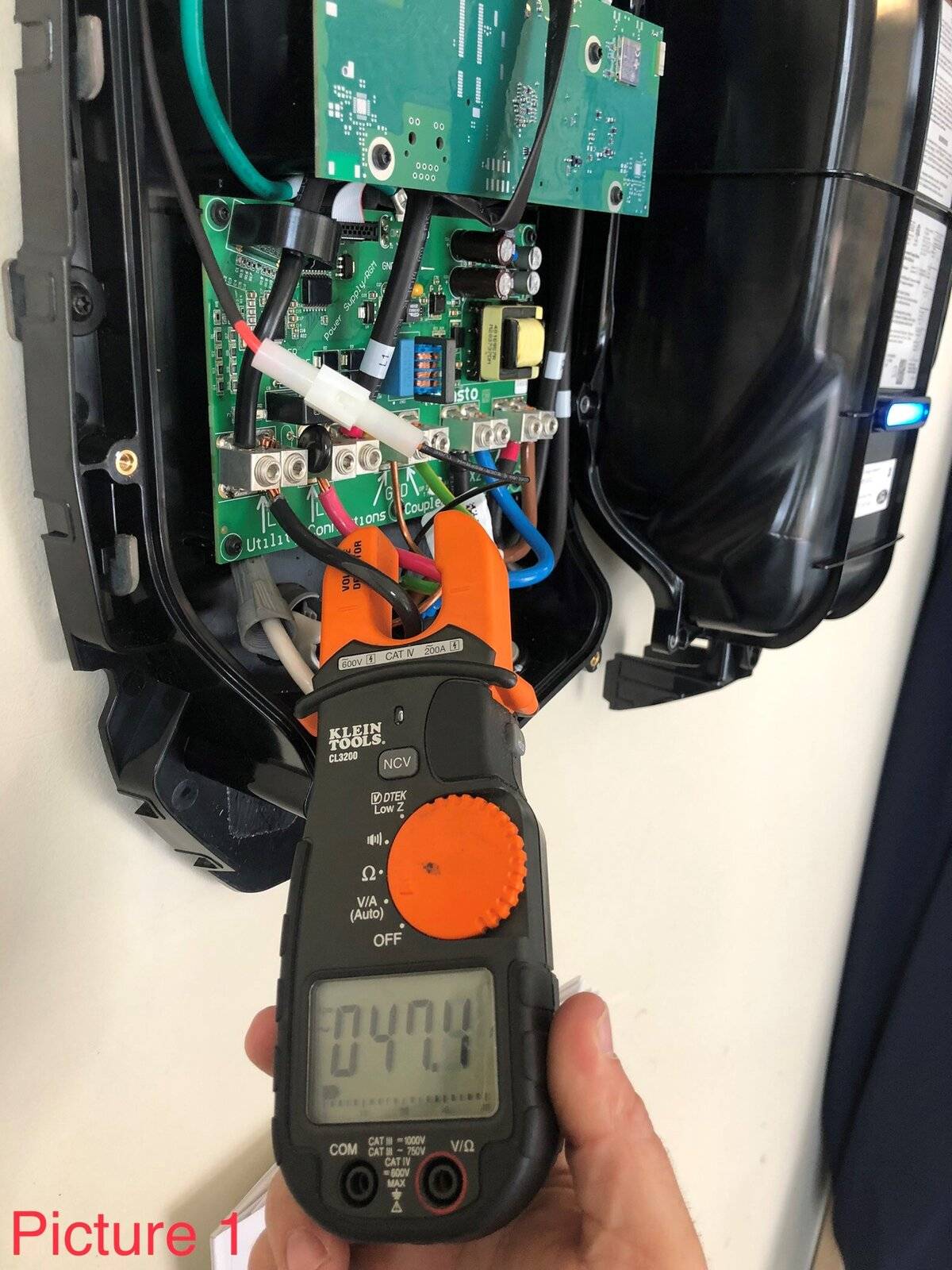

Having the same issue with another charger. Seems the 50a CB setting works and the 60a CB setting works. But the 40a CB setting doesnt work in either charger. It reverts to default 60a CB.
Even had another electrician look at it and we cant figure it out. Tried dip switches both ways as Jimrpa suggested to no avail.

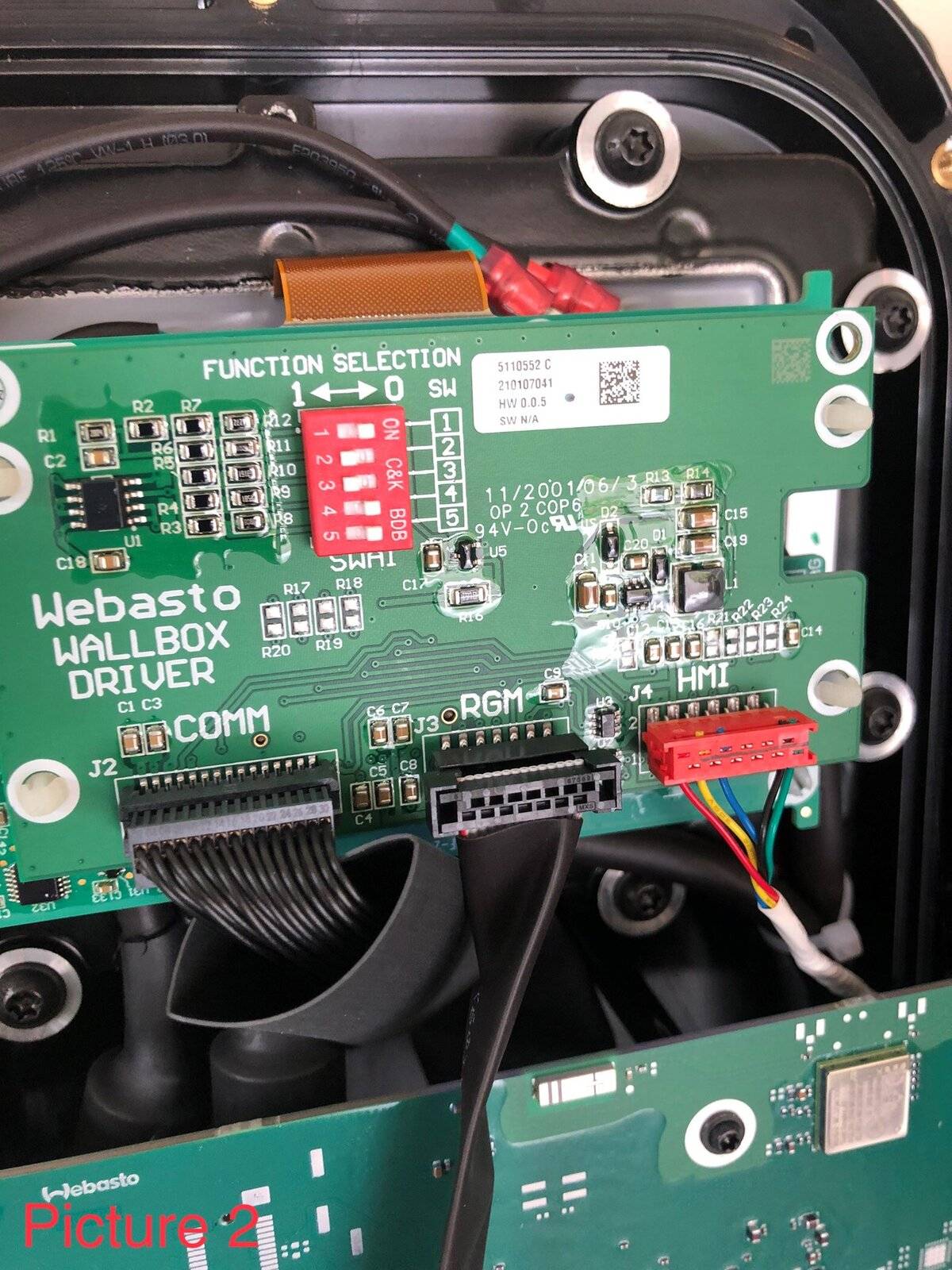

I thought someone posted on here before to ignore the 1 -0 printed on the circuit board and to use the ON indicator on the switch assembly itself.
Close but it's the opposite. The silk-screen on the green circuit board is what you should follow. Ignore the printing on the red block.
When I spoke with the Ford Engineer on the charger project he told me the original samples came back with the green circuit board printed correct and the red block didn't hav the "ON" label. But when they went into production ... they noticed the "ON" printed on the red block (which is not what they approved ... it wasn't supposed to say that).
SO... ignore the printing on the red block (other than the switch numbers) and follow printing on the green PCB.
Switch 5 should always be in the zero position position (opposite what is shown here).
According to the documentation ... If it is in the left position (as shown in this photo) then it is invalid and will result in the EVSE defaulting to 48 amps for the car ... requiring a 60 amp circuit breaker.

This is how I understand it as well. unfortunately on 2 seperate chargers the 40a CB setting doesnt work. Must be an issue with the units themselves. Has anyone else set theirs to 40a CB and it not revert to default 60a?
TheVirtualTim
Oct 11, 2020
1,366
2,470
Dearborn, MI
When I installed my Ford Connected Charge Station (FCC) and had issues ... the engineer who handles the chargers actually came out to my house to inspect and test my FCCS (I happen to live very close to Ford HQ). He personally set the DIP switches on my EVSE and told me to take a photo of it. He also pointed out the issue with the instructions on the green printed-circuit-board vs. the red DIP-switch block (the conflicting instructions on the green PCB vs the red DIP switch block was NOT intended and not what was approved for production.) This is why I am confident that you should only follow the instructions on the green PCB (he made that very clear).
If you configured the EVSE per the green PCB and it isn't working as expected then ... my guess is there may be an issue with the EVESE (these are made for Ford by Webasto).

I did use the screen printed labels initially. Did not work. i guess we have 2 bad chargers here, as odd as that seems.
