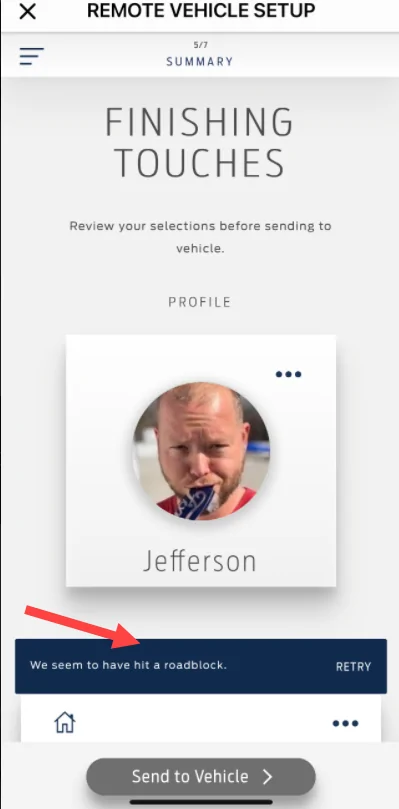

After picking up my car last night, I attempted to send my profile from the Ford Pass app on my phone to the vehicle and it would never take. Tried deleting the app, deleting the profile, starting from scratch and it would never work. Bigger issue is when I got to active the Ford Pass Charging Network trial it errors out connecting the my "wallet". Even though my wallet has a valid CC in it and I've even removed and re-added one, still no luck. Been on the phone for almost two hours with Ford Pass support (after being dropped three times) and still no luck. Even the support reps that I have spoken with said that this is all new to them and they have no clue how to support. They did gather all of my information and they will be elevating this to higher support.

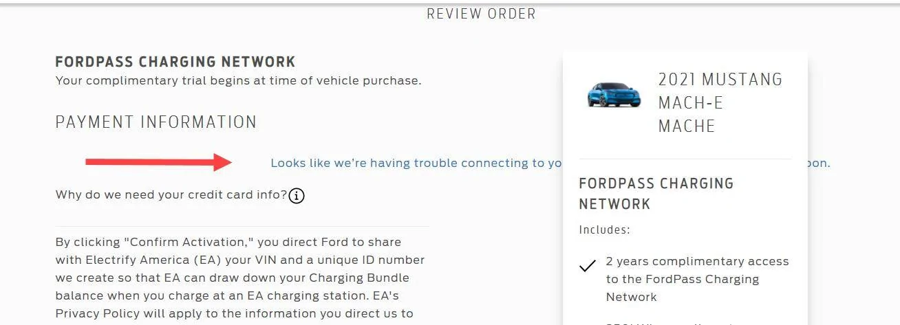

I also had the credit card error when trying to activate Connected Services (Ford Network charging). It didn't like my Apple Card (MasterCard). It seemed to take my AmEx ... but then I had problems continuing.
