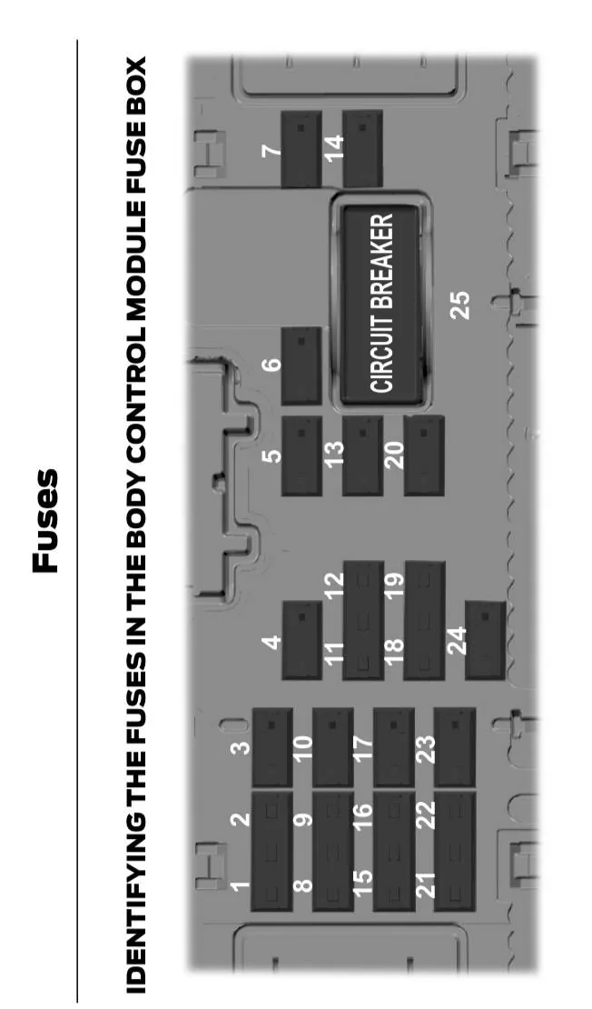

In the meantime, I've read lots of information on the forums. I've disconnected fuses 11, 18/19 and 20/21... to no avail. (BTW, after one of these fuse resets, I now have the "stop safely" warning appearing on the dash. Not sure what that's about; hopefully it goes away) I've reset the Ford Pass Connect and even done a factory reset. Sirius XM still works, as does Blue Cruise.

If you don’t feel like pulling the negative cable off the battery you can do like I did when I had this issue. You can just open up the fuse panel on the passenger foot well and pull out the 19 and the 11 fuse.

I've already tried pulling both fuse 11 and 19 and left untouched for 30 minutes; no dice. I'm wondering if leaving them out for even longer might help? Doesn't make sense to me, but you never know.

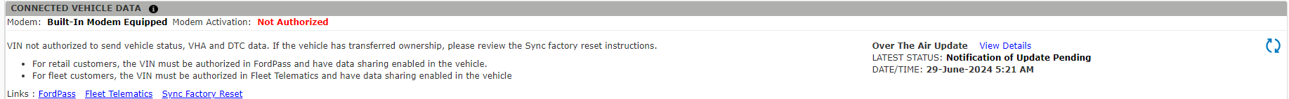

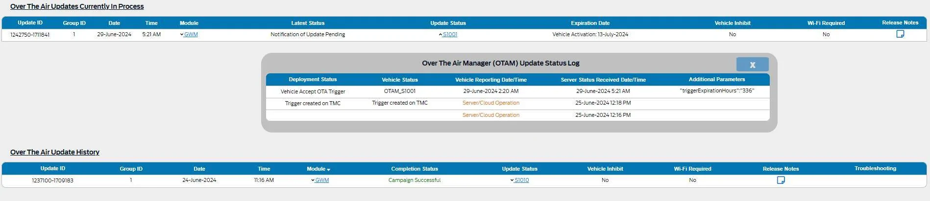

Your modem shows as not authorized. You have an OTA sitting in your queue now that was sent early this morning, but your car is not pinging back the mothership to accept it. Because of this, I am unable to pull any codes your car is reporting.
Ford Mustang Mach-E Ford Pass/Modem issues 1719678373446-9b
About a week ago, you got GWM update ECG-24.2.4.9 sent to you. I can't say for sure that somehow this update messed up your connectivity, but the timing lines up. The update in your queue now is ECG-24.2.4.9.1.

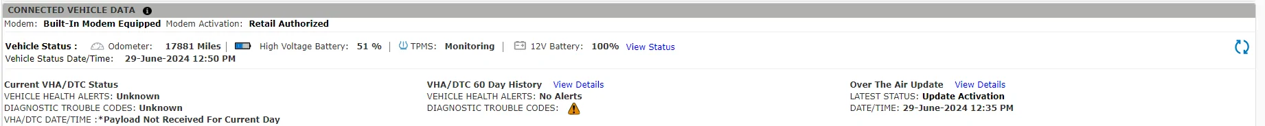

The update fixed your connectivity issue! Congrats! Your modem is online now and all connected data seems to be working.
Ford Mustang Mach-E Ford Pass/Modem issues 1719679858386-a7
Edit: Wait, PTS shows it is still pending to install. Idk what's going on, but your modem is online now.
