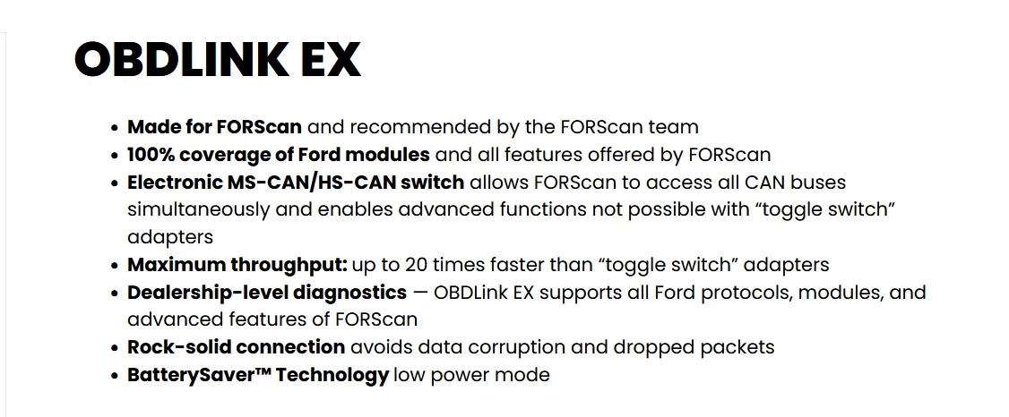

I think when OP is saying 'Just Forscan', he is saying that he has ForScan installed on a Windows PC and he has an OBDLink EX, and wants to know if the USB based EX will work on the Mach-E...
Yes, this combination will work just fine! :cool:
