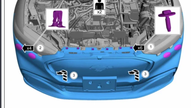

I’m in the process of removing my front bumper to address an issue with the active grille shutters. I’m following the instructions document that was shared here, and when I get to Step 10, I don’t see any clips under the headlights.
What I do see are plastic clips/inserts coming from the headlight housing that go into the bumper. Are these the clips being referred to in the instructions?
Yes they are. Those clips are permanent and stay below the headlights. The bumper just slides into them. You just pull the bumper cover out of the clips. They are not especially tight. Just there to keep it aligned properly.
