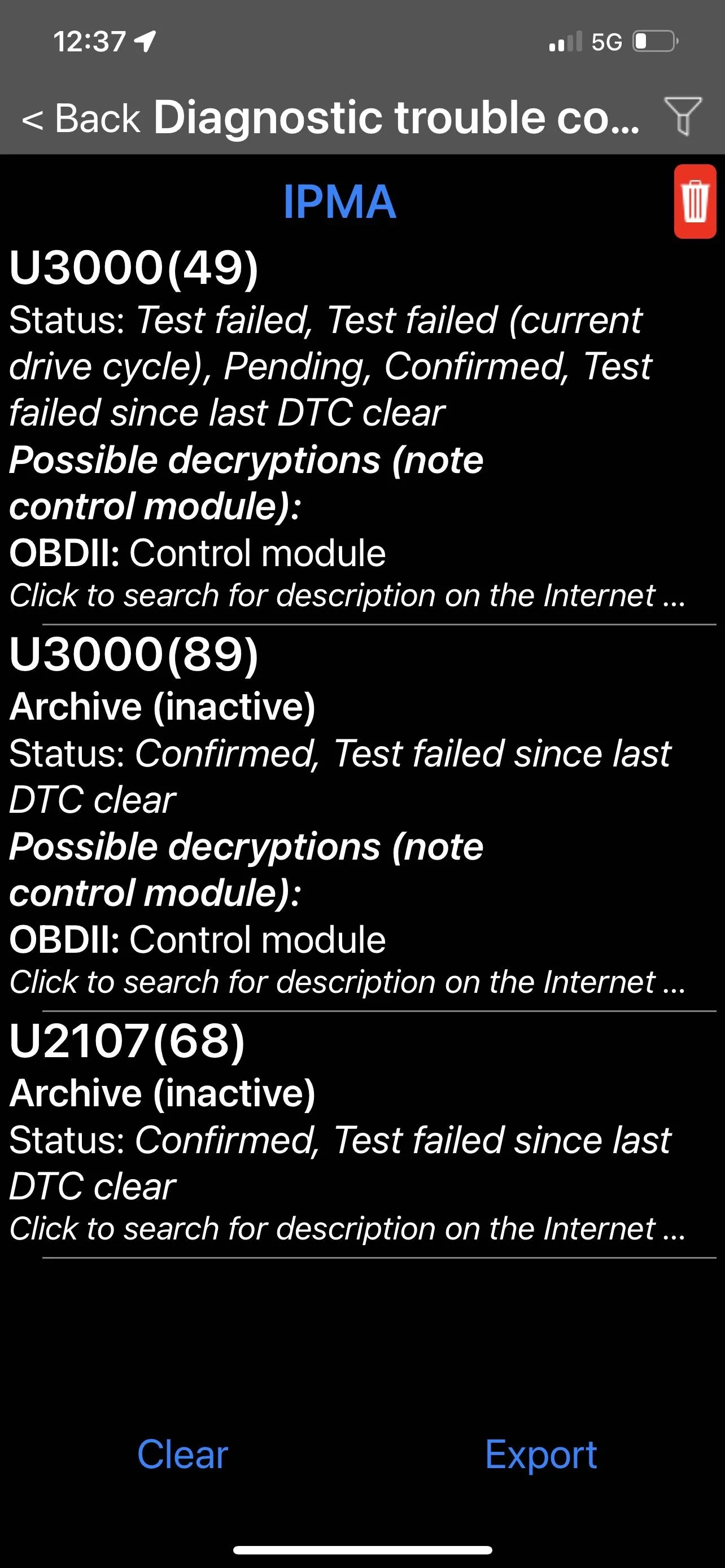

This is probably a stupid question but has anyone tried clearing the error codes (U3000?) with car scanner or something like that? Wondering if it will make it functional until it stops working again. Or if there is something else that can be done to reset it so it works even for a little while before it errors out again. It’s frustrating when you are traveling on the freeway. I agree this started happening when Blue Cruse updates were sent out.
That would be great. A workaround to least get it somewhat working would be nice. Unfortunately, I don’t have any of the equipment to actually do anything with the electronics on my car. I remember seeing someone on YouTube who applies their own updates to their MME GT. I was thinking of buying some of the stuff after my warranty period but didn’t think I would need it so soon. It sucks because the car has been amazing it’s just these camera faults kill it.
