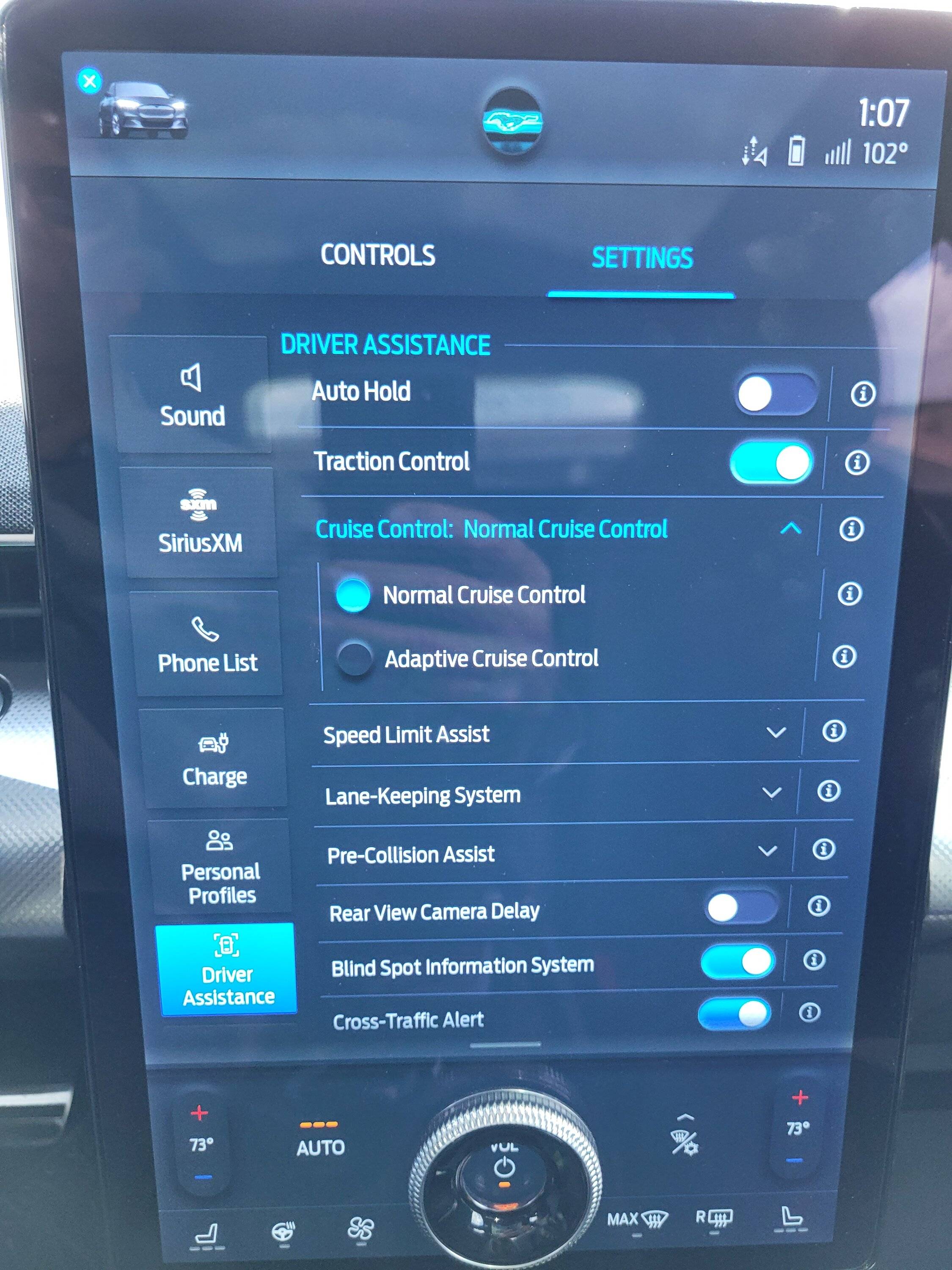

You can use normal cruise control with the camera failure. Go into the Sync menu and enable Normal Cruise and that should work. Not ideal of course but at least CC will work.
I tried it before and it didn’t work on my car. Tried again today and nothing as well. So I guess yours works, which means I have two issues now.
Same here. I cannot activate cruise control with this fault, regardless of the "Normal" vs. "Adaptive" setting. Similarly, auto high-beam headlights, lane centering, and pre-collision do not work.

Agreed, normal cruise still does not work. I’ve been having the same issue since around the time of the contactor overheat recall update. It’s really annoying not even being able to use normal cruise, especially on long trips in areas I would regularly use blue cruise.
Interesting. I’m going to open up the hood and do a sanity check on fuse 33. It looks like it’s in charge of the ā€œAdvanced driver assistance system.ā€ I didn’t see one for normal cruise control. So I’d imagine all the driving assist features pass thru there. Unless our cars have different hardware that doesn’t permit it.
