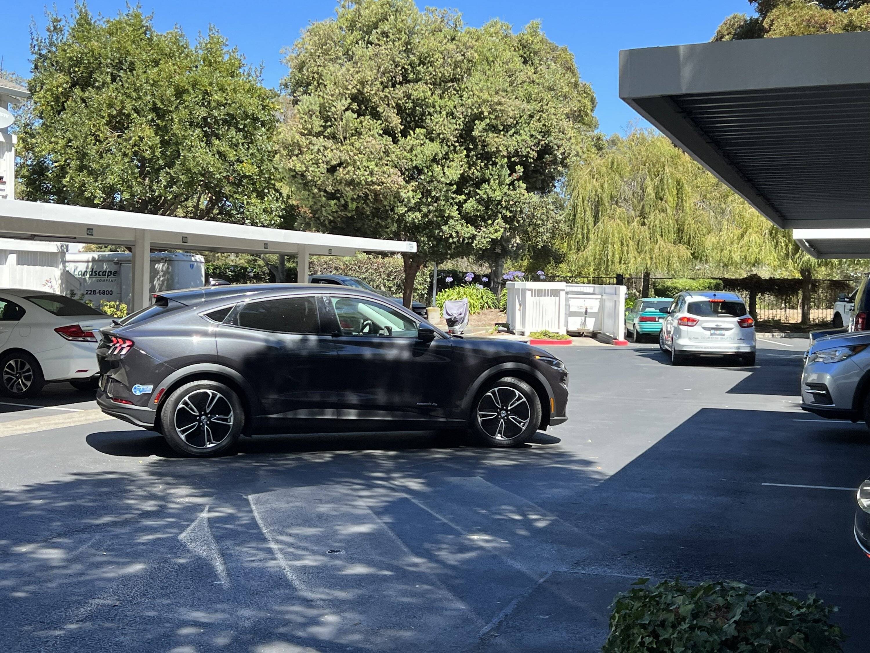

Well, Walnut Creek Ford has picked up my MachE from my home for Front Camera Fault repair #3. Wish me luck!
