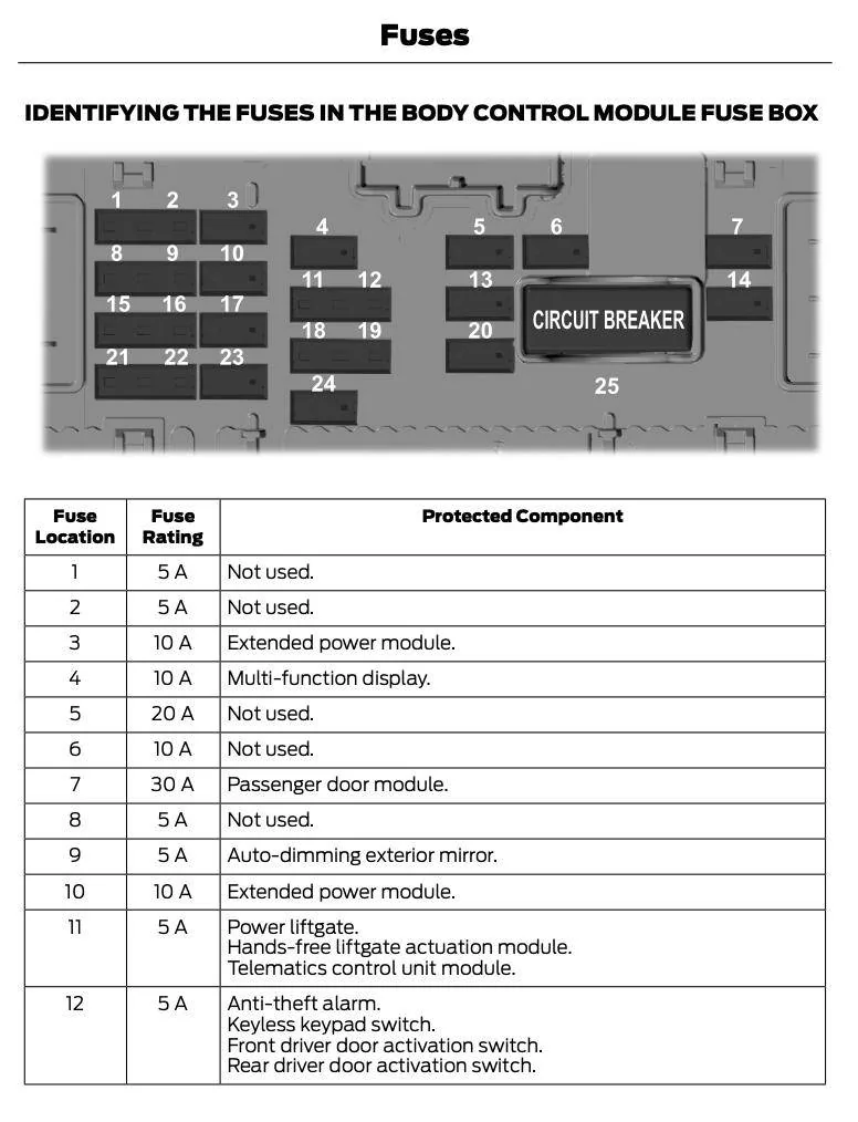

Hi guys, following a video on YouTube I managed to hardwire a dash cam (Viofo A139 Pro) to the fuse box under the glove box. The ACC cable was connected using a fuse adapter to fuse 3, and in the manual it says this is an “extended power module”. I tried to find information on the web about this but I had no success so far, there’s no mention of this even in the manual. Does someone know what this “extended power module” is and how bad it would be if that fuse doesn’t work anymore?
