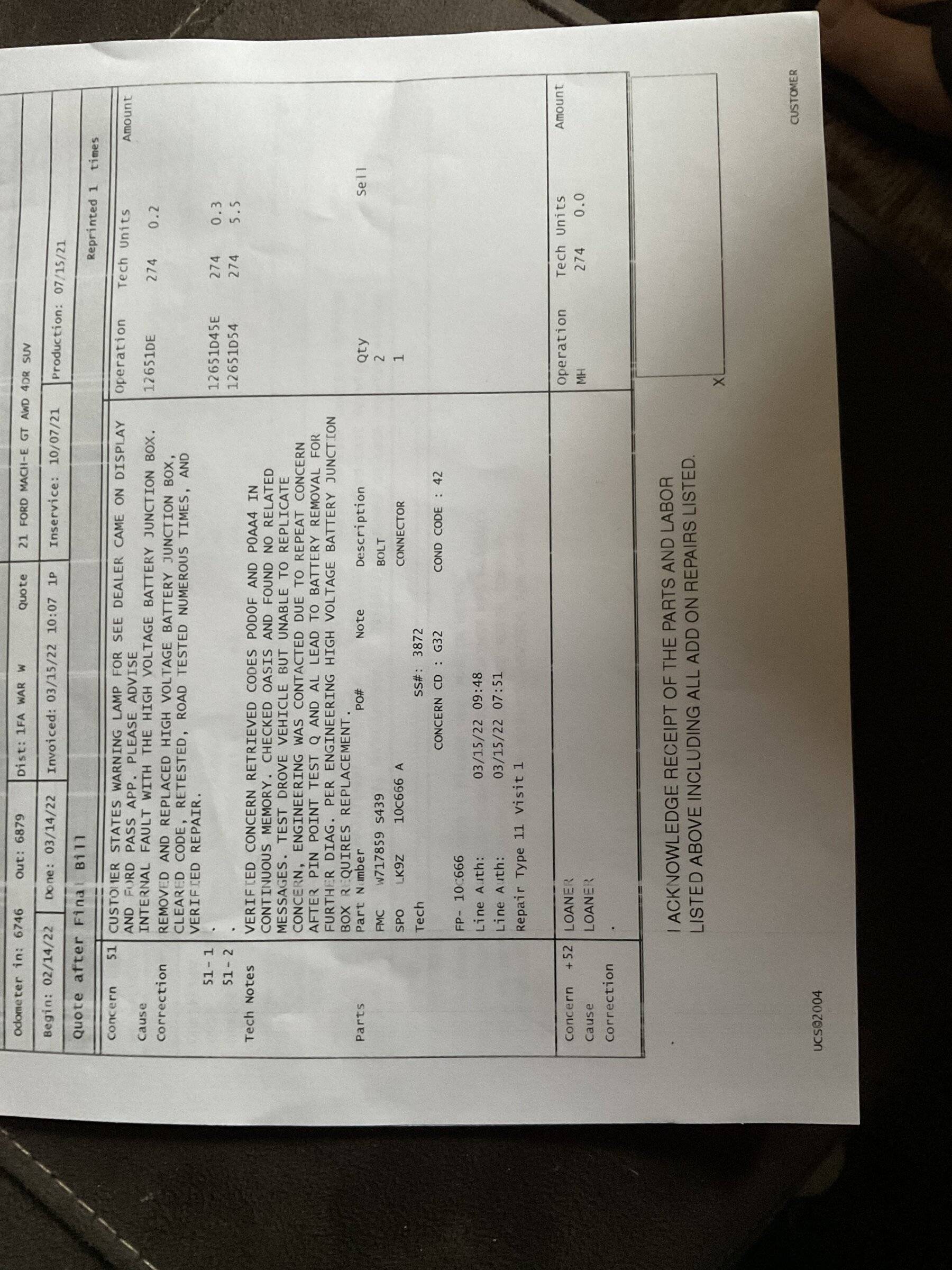

Well got her back today. We shall see. Only problem now is PAAK AND MY Bluetooth is not connecting. I verified it working in the car. As my music and everything is showing on the screen in the car. But nothing on the app is working now. Maybe it will update soon.
And what did it say on the sheet about what had to be fixed this time around?

Same things as before
Thanks, I can see that you've had your BECM and HVBJB replaced in Jan, and the HVBJB replaced a second time now after getting contactor stuck closed codes in Feb. First replacement only lasted a little over a month. Sorry it seems like the HVBJB is a failure-prone part since you had to have yours replaced twice so far. That or else bad software management is causing the contacts to get welded.

Well she performed fabulously today. I am just trying to reset all my settings that cleared out. Other than my Bluetooth not connecting it seems to be fine. Charging now. Still nervous to take a road trip. But might just try soon.
Hopefully it is good to go this time. Could have been a bad part first time. Things happen. I gave them all my payment information hopefully they will reimburse me for at least one month of payments

Maybe I can get devsecops to pull my vin again and verify what was done in comparison to last time. Hint hint.
