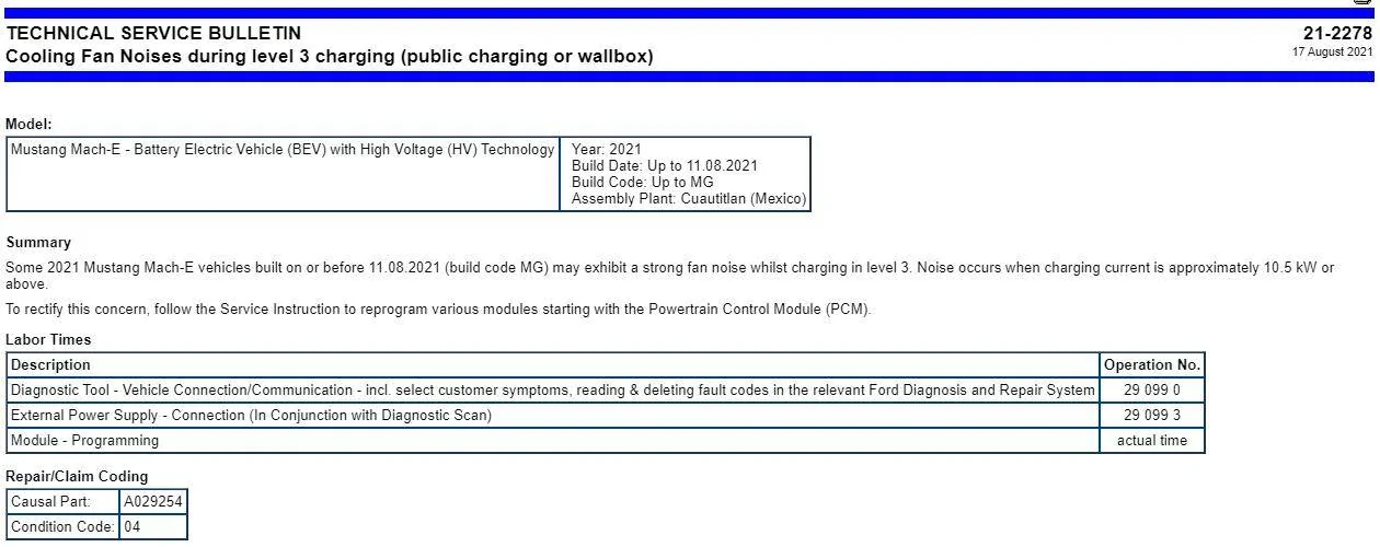

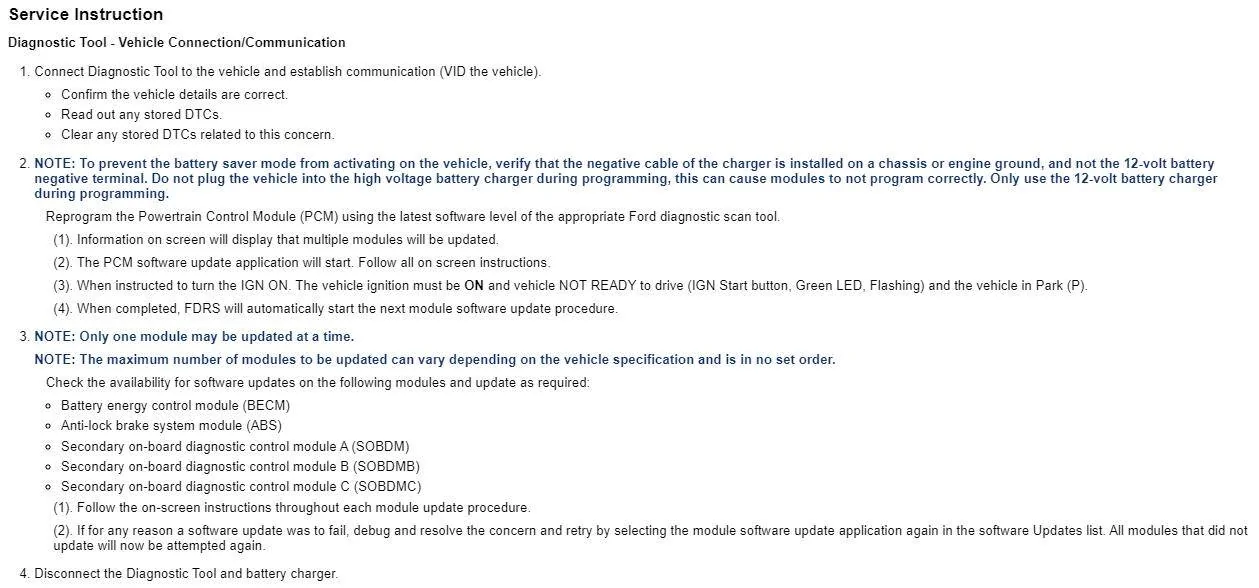

Some 2021 Mustang Mach-E vehicles built on or before 11.08.2021 (build code MG) may exhibit a strong fan noise whilst charging in level 3. Noise occurs when charging current is approximately 10.5 kW or above.
