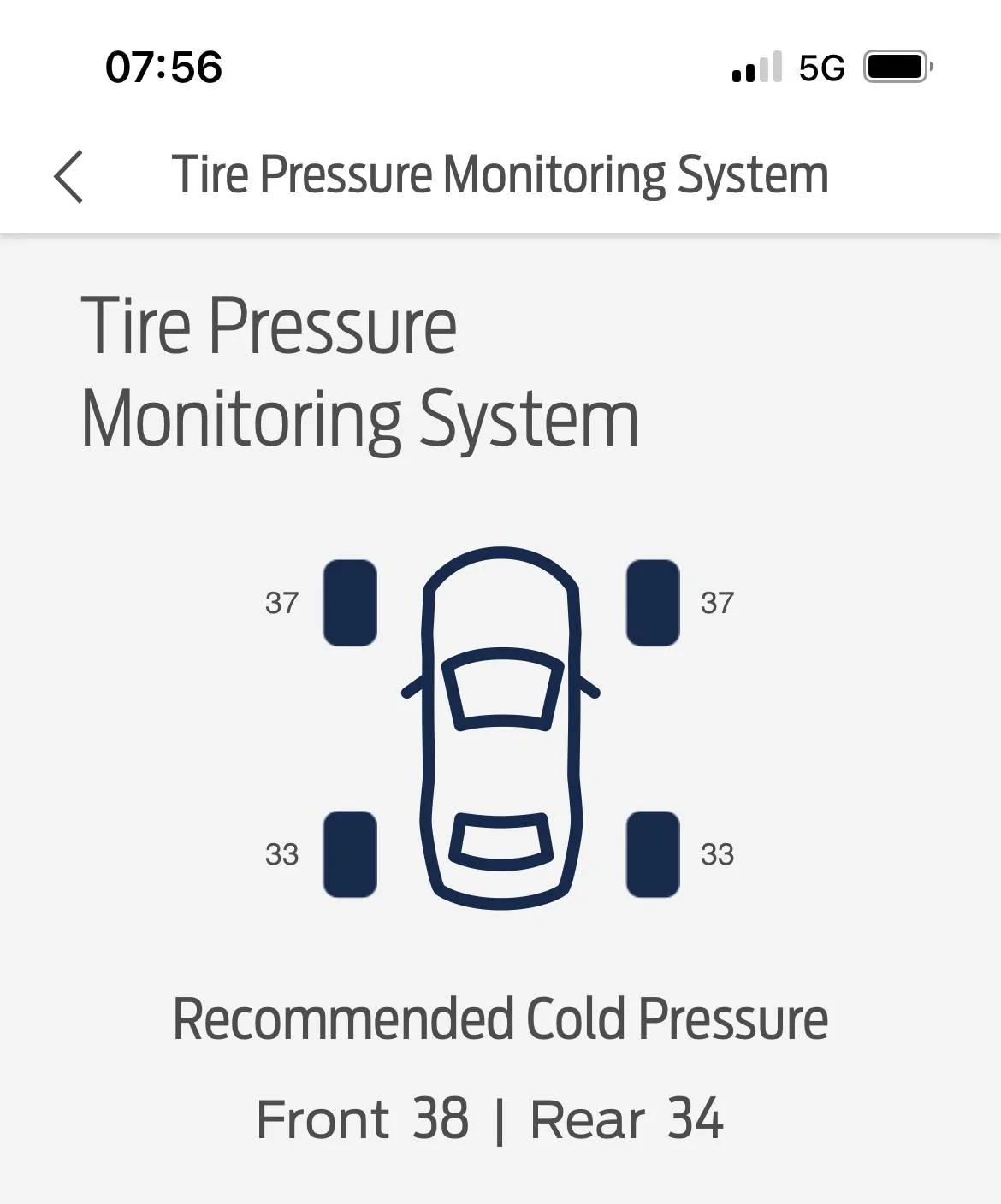

A word about tire pressure….. I run my tires at the recommended pressure for the weight they are supposed to carry on the Mach-E. This also will allow them to properly flatten out and have more contact on the road. These are the pressures I use with each of the tires to maintain the proper load capacity that Ford recommends as per the tire pressure/load rating chart.
245/45/20 103XL 39 psi
255/45/20 105XL 37 psi
265/45/20 108XL 33 psi
275/40/20 106XL 36 psi
285/40/20 108XL 33 psi
295/40/20 110XL 31 psi
315/35/20 110XL 31 psi
Since the pressures are a bit lower when running larger tires, it also gives you a more comfortable ride. However, running at a lower pressure can trigger the tire pressure warning system so you need to change the default 39 psi in FORScan to your new psi so it won’t trigger a low-pressure warning. Right now, I’m running 255/45/20 front and 285/40/20 rear so I changed my settings to 37 and 33 psi. These will show up in the Ford Pass app as the recommended cold pressure.
Ford app Tire Pressure Monitoring page. (My tires are showing 1 psi less than normal because my car has been in my parents garage for a couple of days where the weather is slightly colder right now than where I live).

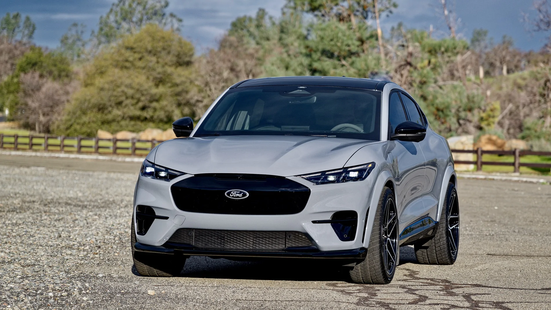

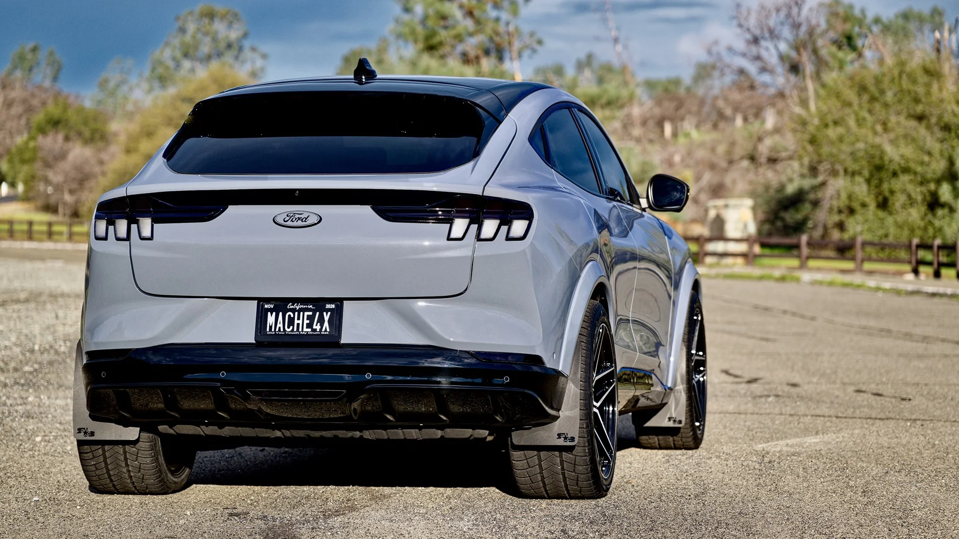

Below are some photos of the four setups. I didn't take photos each time I changed tires as I ran though 9 sets and sometimes, they were on the car less than a couple of months. While it may not look like it in these photos, on every setup, the tires have a flush fitment.
245/45/20 F - 275/40/20 R 20"x8.5" ET 34 F- 20"x10" ET47 R Pirelli P Zero All Season Plus.
Ford Mustang Mach-E My staggered wheel/tire setups - info, specs, opinions. NZ7_6458D
Ford Mustang Mach-E My staggered wheel/tire setups - info, specs, opinions. NZ7_6460D
255/45/20 F - 285/40/20 R 20"x9" ET33 F - 20"x10.5" ET47 R Pirelli P Zero All Season EV
This is my current setup and so far, my all-around favorite.
Ford Mustang Mach-E My staggered wheel/tire setups - info, specs, opinions. NZ7_740030
Ford Mustang Mach-E My staggered wheel/tire setups - info, specs, opinions. NZ7_739830
265/45/20 F - 295/40/20 R 20"x8.5" ET34F - 20"x10" ET47 R Michelin Pilot Sport SUV
Ford Mustang Mach-E My staggered wheel/tire setups - info, specs, opinions. NZ7_5409D
Ford Mustang Mach-E My staggered wheel/tire setups - info, specs, opinions. NZ7_5416D
275/40/20 F - 315/35/20 R 20"x9" ET33 F - 20"x10.5" ET47 R Michelin Pilot Sport 4S
Ford Mustang Mach-E My staggered wheel/tire setups - info, specs, opinions. SV706 Mach E Gloss Black Diamond Cut-19D
Ford Mustang Mach-E My staggered wheel/tire setups - info, specs, opinions. SV706 Mach E Gloss Black Diamond Cut-15D
275/40/21 F - 315/35/21 R 21"x9.5 ET 40 with 15mm spacer F, 21"x11" ET40 R Vredestein Wintrac Pro+ winter tires pictured but also have Ultra Pro summer tires in same size.
Ford Mustang Mach-E My staggered wheel/tire setups - info, specs, opinions. DSC_0648DD
Ford Mustang Mach-E My staggered wheel/tire setups - info, specs, opinions. DSC_0658DD

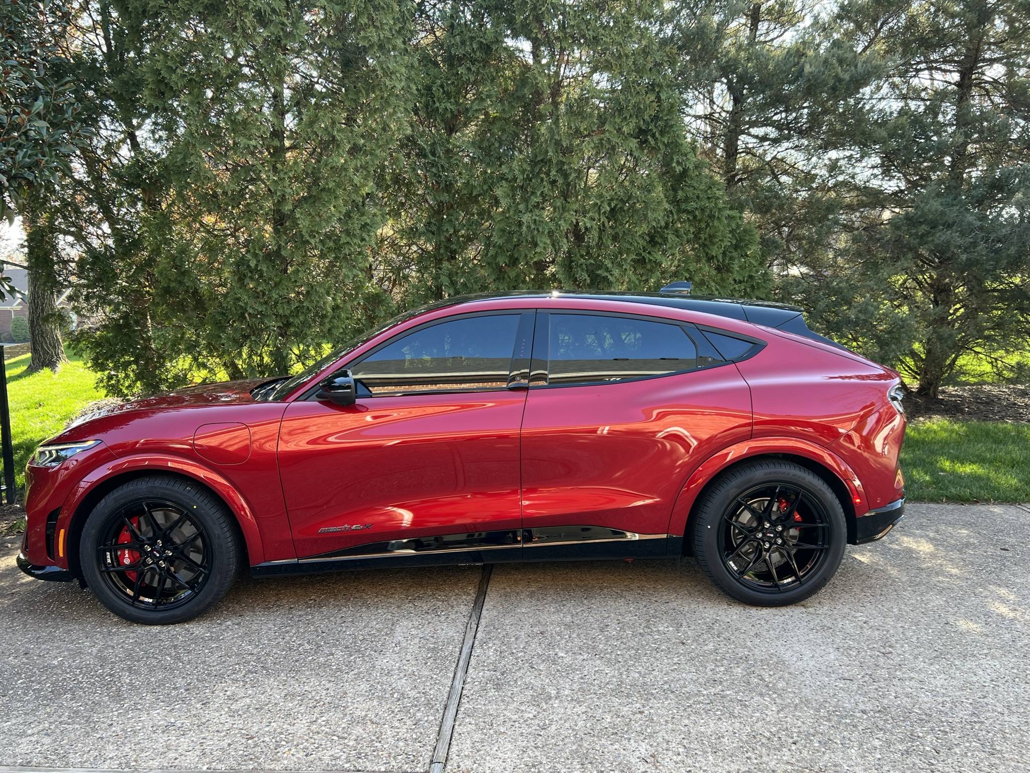

I have not run as many setups as Mark has had, but I have run a couple of different setups. I consulted @markboris about my current setup Since I didn’t have much experience with non OEM tires sizes for car and what would fit. I appreciate all the advice he gave me, and made me more knowledgeable about tire size, and wheel sizes and offset, and how they all relate.
I received my GTPE in December 2023. The temps in Kentucky were about 33 deg F. Of course the car came with the Pirelli P Zero Elec summer tires, so I already ordered Michelin Pilot Sport A/S in 255/45R20 in a square setup. These went on the stock wheels, and I immediate drove from the dealer to Discount Tire to get them installed.
Savini SV-F5
I wanted a better wheels, so after many months of research, I settled on Savini SV-F5 in gloss black. I went to staggered setup for the first time, so Mark’s advice was crucial. I didn’t want to modify the suspension, so we settled on 255/45R20 in the front, and 285/40R20 in the rear. I don’t like poke, and wanted a flush figment.
With that in mind, I ordered the SV-F5 fronts in 8.5x20 ET 38. For the rear, I went with 10x20 ET 45. That would allow me to run a 245/275 or 255/285 setup.
These tires I noticed have a harsh ride. If I hit an expansion joint, it makes a hollow ”boing” sound. In the snow, these tires were great. I had great traction, and handled almost as good as my F150. These tires were noisy to me though. I measured the noise with a decimal meter. At 70 mph, the noise was about 73-74 dB.
Pirelli P Zero All Season EV tuned
These are the tires Mark is currently running, and looking at the specs, I wanted to give them a try. The ride is much smoother, and the noise was noticeably less. At 70 mph, it measured at 68-69 dB, about 4 dB less than the Michelins. Now as the decibel scale is logarithmic, 4 dB is very noticeable at the level. I have also noticed and increase in efficiency, but since the weather started warming up, it was hard to tell how much better. I think the better rolling resistance helps. I don’t care about range, as I use this vehicle around town 95% of the time.
I did not get pictures of the 255 square set with stock wheels, but they were still set back in the fender. The current offsets and tire sizes give me tires that are perfectly flush with the upper fender. As for tire pressures, like Mark, I test different pressures for these tires and went out to then”hills and hollers“ in Kentucky. Here are the results:
Front 41 psi, Rear 41 psi
Ride was a little harsh, but handling was the best. If you are tracking the car, this would be a good setting.
Front 35 psi Rear 31 psi
The ride was the most comfortable. Very smooth and forgiving. it absorbed bumps very well. However handing was atrocious. The car wandered all over the road. Not a good setting for handling.
Front 38 psi, Rear 34 psi (my current setting)
This setting provided the best mix of comfort, while still very good handling characteristics. This is my current setting, and has done very well for me. The car hasn’t been driven in 2 weeks, so pressures are a bit low.

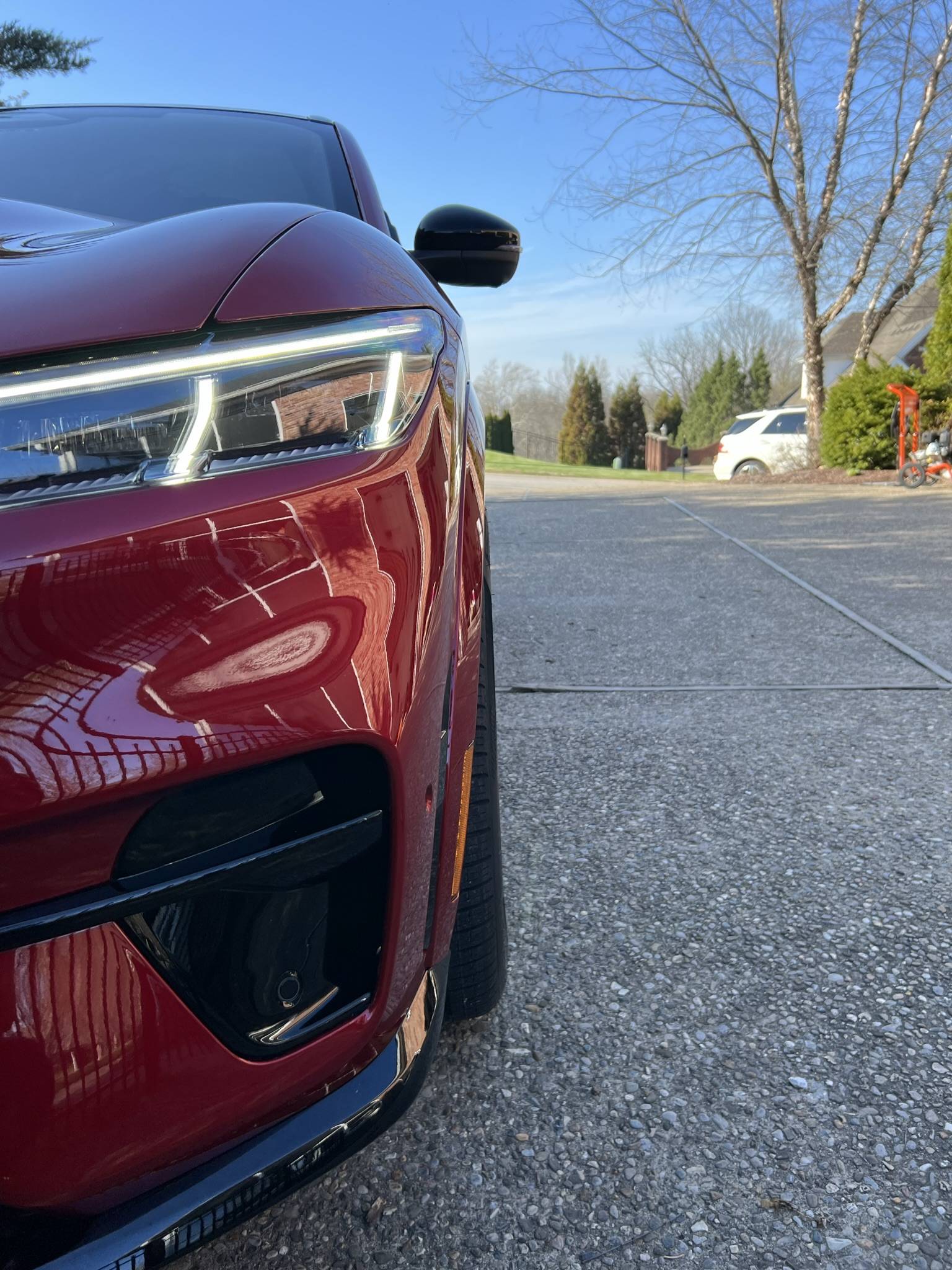

Ford Mustang Mach-E My staggered wheel/tire setups - info, specs, opinions. 89DDDDE5-D6A7-481C-A4B5-A50FECD5CC80

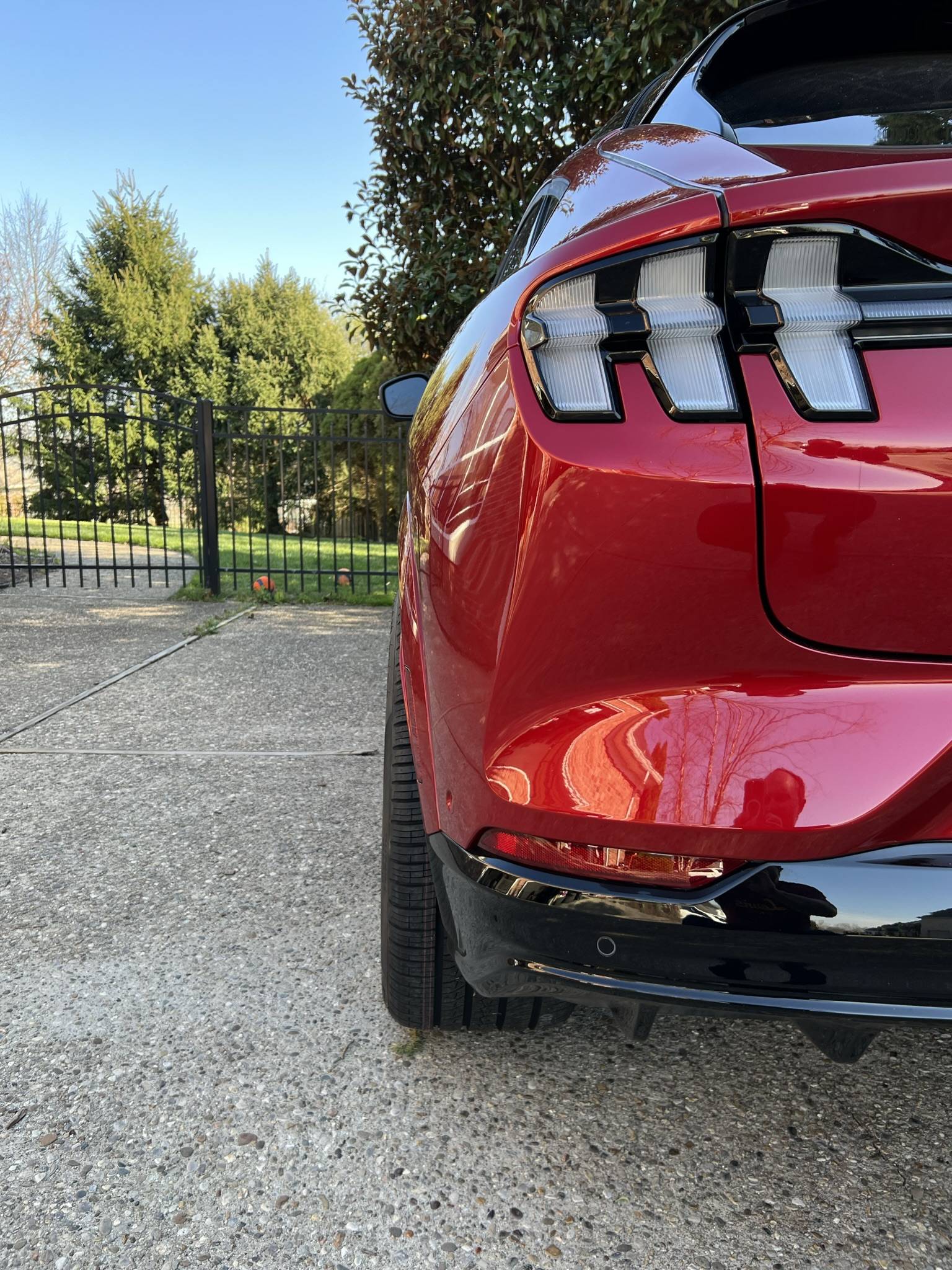

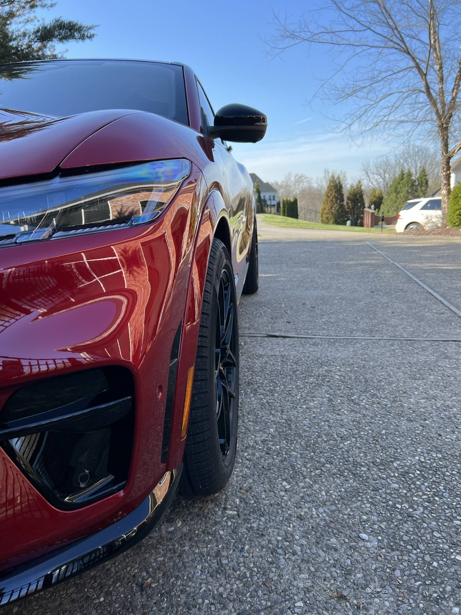

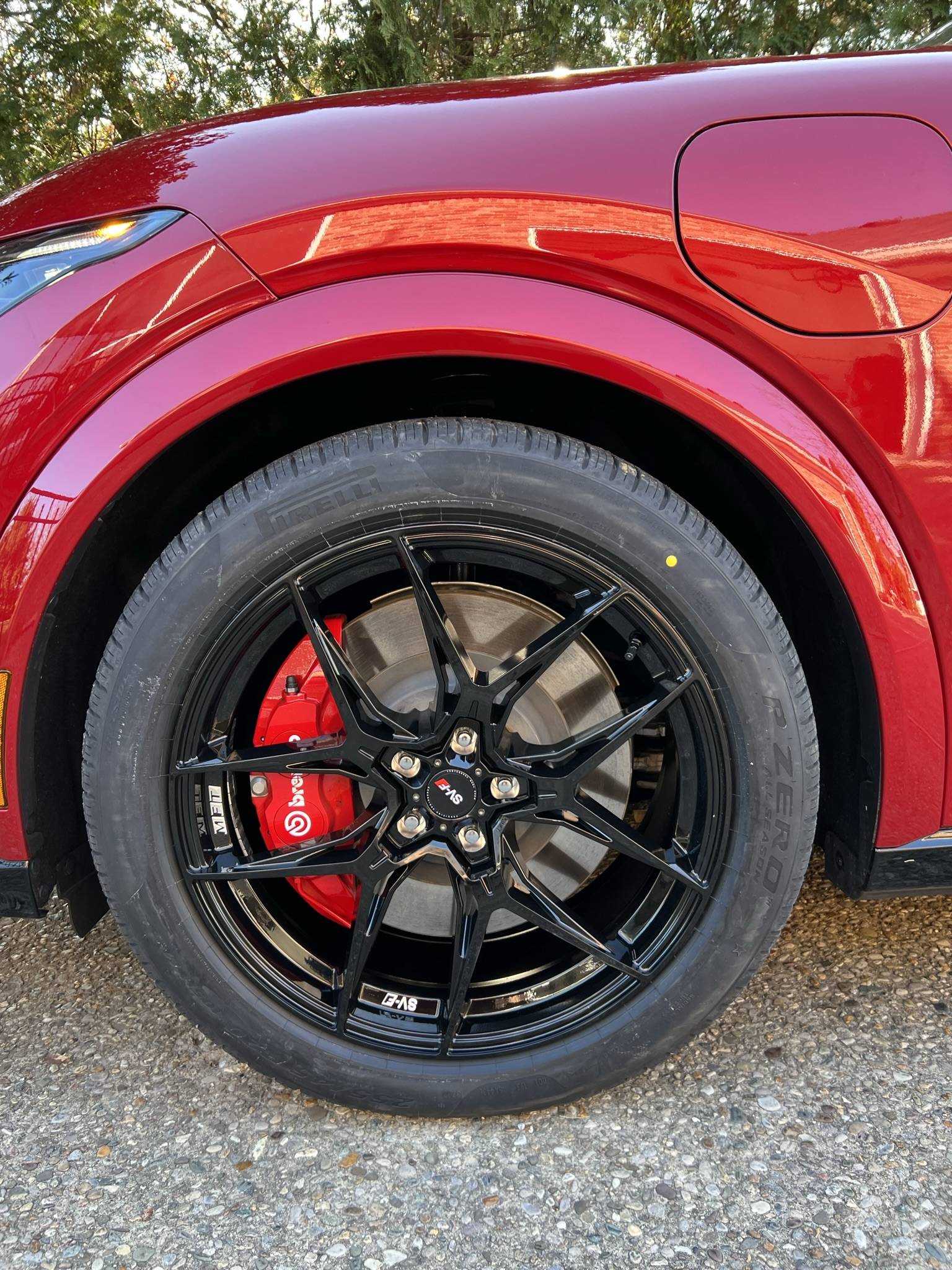

Here are pics of the current setup.
Front 255/45R20 8.5x20 ET 38 Pirelli P Zero All Season EV Tuned
Ford Mustang Mach-E My staggered wheel/tire setups - info, specs, opinions. 468EE4FB-3977-4FFB-9CF8-CA724580D577
Ford Mustang Mach-E My staggered wheel/tire setups - info, specs, opinions. E223DC49-0AD4-4E71-B2BC-DB1C46485F02
Ford Mustang Mach-E My staggered wheel/tire setups - info, specs, opinions. B55E0E96-BA64-4C34-9FA8-2DE69CD350DD
Ford Mustang Mach-E My staggered wheel/tire setups - info, specs, opinions. 9676509C-25FB-405F-9C60-000ECC37B7A5
Rear 285/40R20 10x20 ET 45 Pirelli P Zero All Season EV Tuned
Ford Mustang Mach-E My staggered wheel/tire setups - info, specs, opinions. D14A9220-DF1B-4C23-A29C-3D94AC7EB400
Ford Mustang Mach-E My staggered wheel/tire setups - info, specs, opinions. F2AE9E89-DE21-49F9-B54C-D094171E7DA3

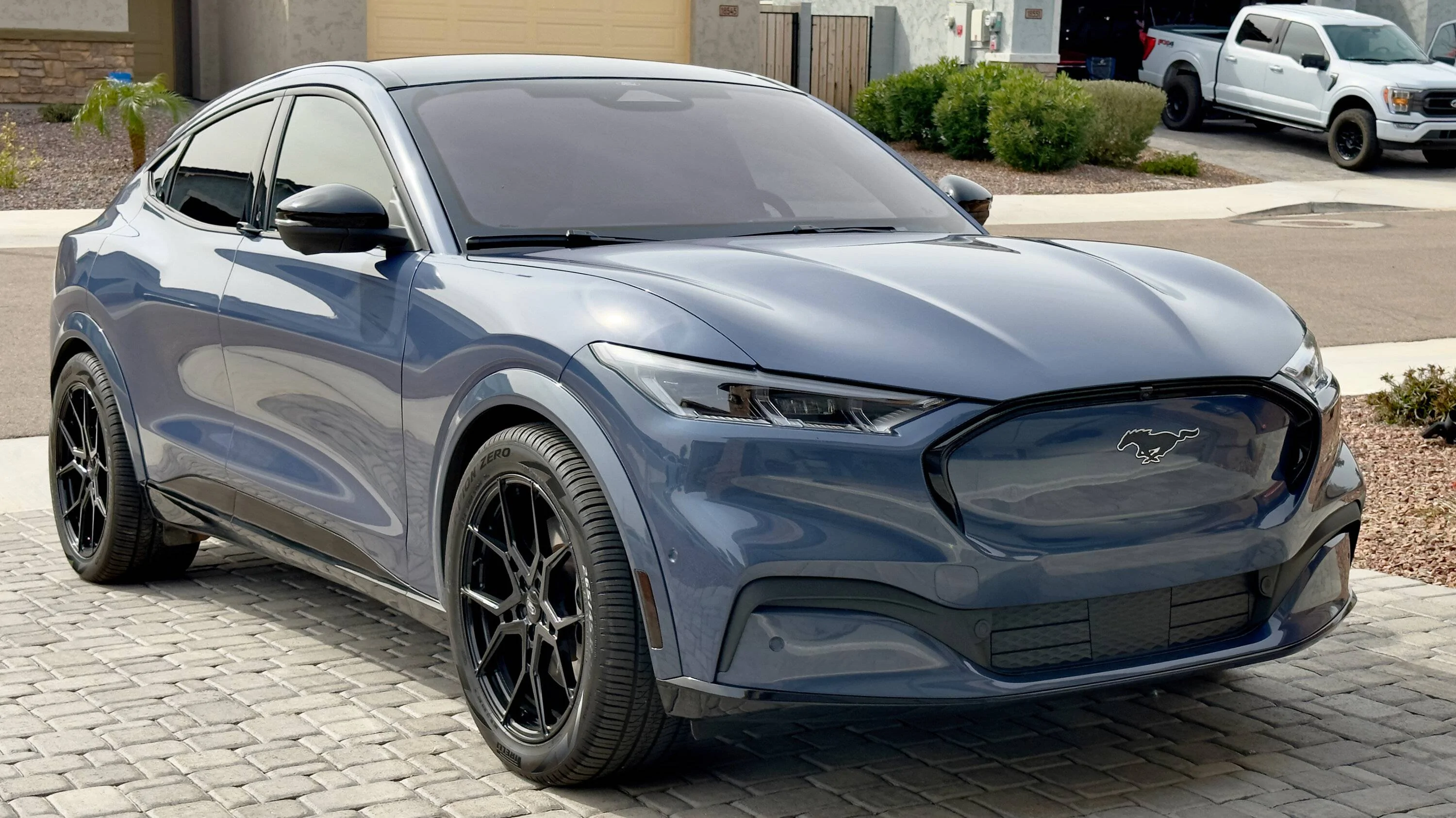

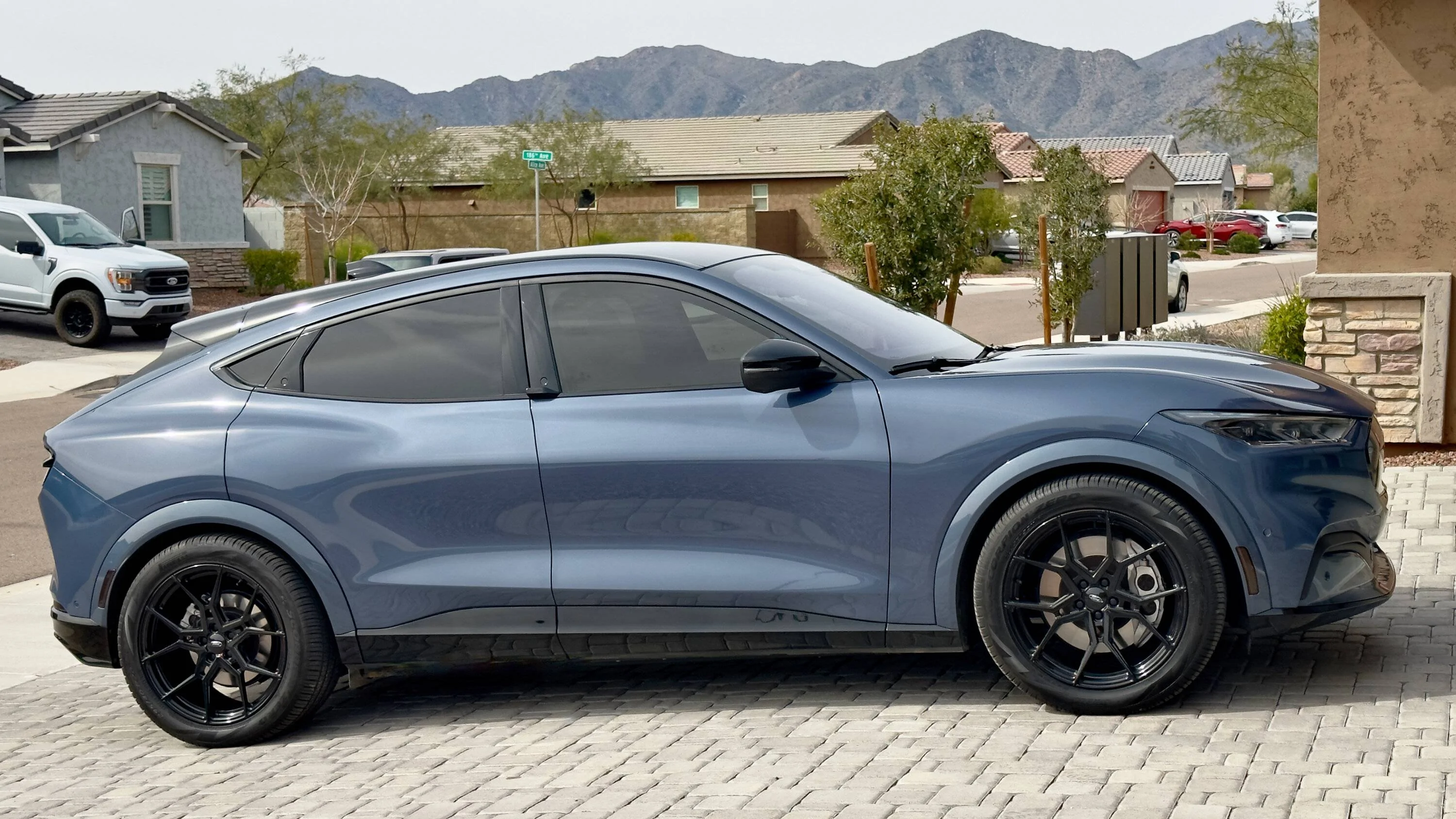

I have Mark's staggered setup #3, 265/45/20, 295/40/20. Didn't need to alter suspension and same wheel specs as his narrower set 20"x8.5" ET34, 20"x10" ET47. Fitment is flush have had this setup for about 18 months. Tires are Pirelli Scorpion Zero All Season Plus and have 20K+ miles and tons of tread left however we mainly drive on the freeway with this car. While they might not be as quiets as the tires Mark and Lou have, they are much quieter than the Michelin Pilot Sport All Season 4's we had on the car previous and also a comfortable ride. Very happy with the look of our Mach-E with this staggered setup.
Ford Mustang Mach-E My staggered wheel/tire setups - info, specs, opinions. IMG_4473 (1)30
Ford Mustang Mach-E My staggered wheel/tire setups - info, specs, opinions. IMG_4472 (1)30

Hey @markboris
Do you think this setup will fit without rubbing?
265/45/20 ET 37
295/35/21 ET 52
