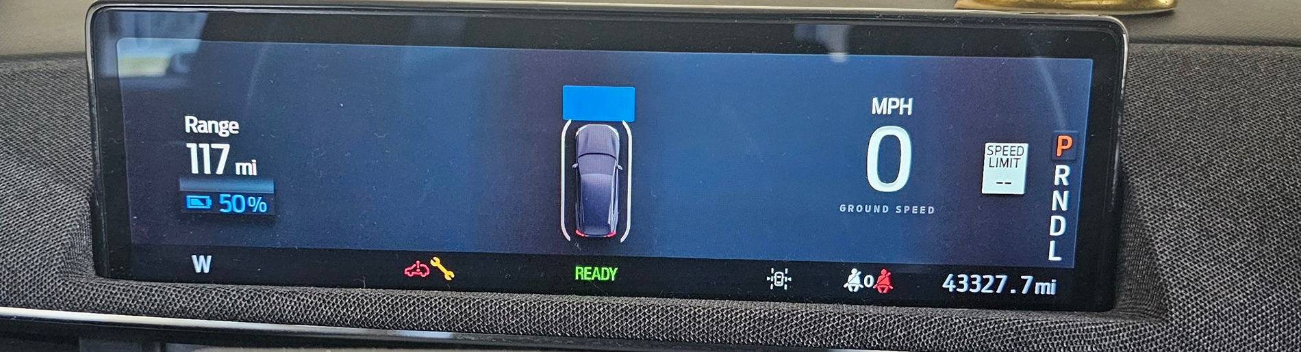

Hi,
I got the powertrain malfunction reduce speed message in the app and an indicator on the instrument cluster.
Ford Mustang Mach-E Got High voltage battery warning and powertrain malfunction 1000050158
e anyone knows how it can be fixed?
I did book a service appointment but it is for next week, can I drive the car till then?

I had the same message pop up last weekend. Started with battery not charging and vehicle completely dead with last read at 9%. Ford roadside assist helped charge the 12V battery so I could access the car. Got the message when driving onto tow truck bed. Took it to public charging but still would not charge. Took it to dealership and left it for a couple of days. They had to change out the 12v battery. Got it back on Tuesday. Have had the car 33 days and wife was stranded with the lockout. :/

It’s a generic warning akin to the old “Check Engine” light. You need to have the Diagnostic Test Codes (DTCs) pulled to know what the issue is. If you have an OBD reader you can pull the codes yourself. If not, do as @AKgrampy said and one of the volunteers will pull the DTCs. ??
