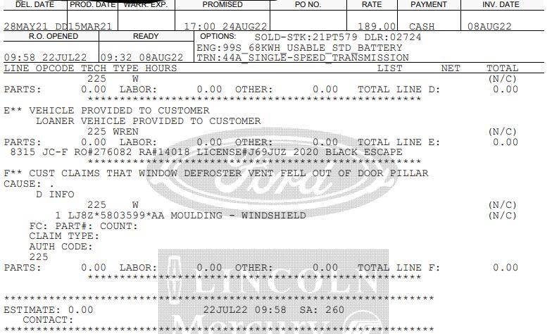

dealer notes actually make sense to me now lol
Wrong notes but I figured it out. They replaced your HVBJB, but not for the usual reason. Your failure is unusual. You had a P0D11 open contactor control circuit. The first time they fixed it, they dropped the pack and reseated the connector. The second time it failed with an additional P0D13 code (circuit low), they dropped the pack again and finally replaced the HVBJB. You should be good to go in the powertrain department, but some of your other modules could use some updates like the RFA and IPMA.
Ah OK so they made more sense in that I understood the parts but not the reason.... Thanks for clarifying the details... For the other modules do I need to have a complaint to get those fixed as is the case sometimes?
Yes most dealers require a complaint before they will update additional modules
