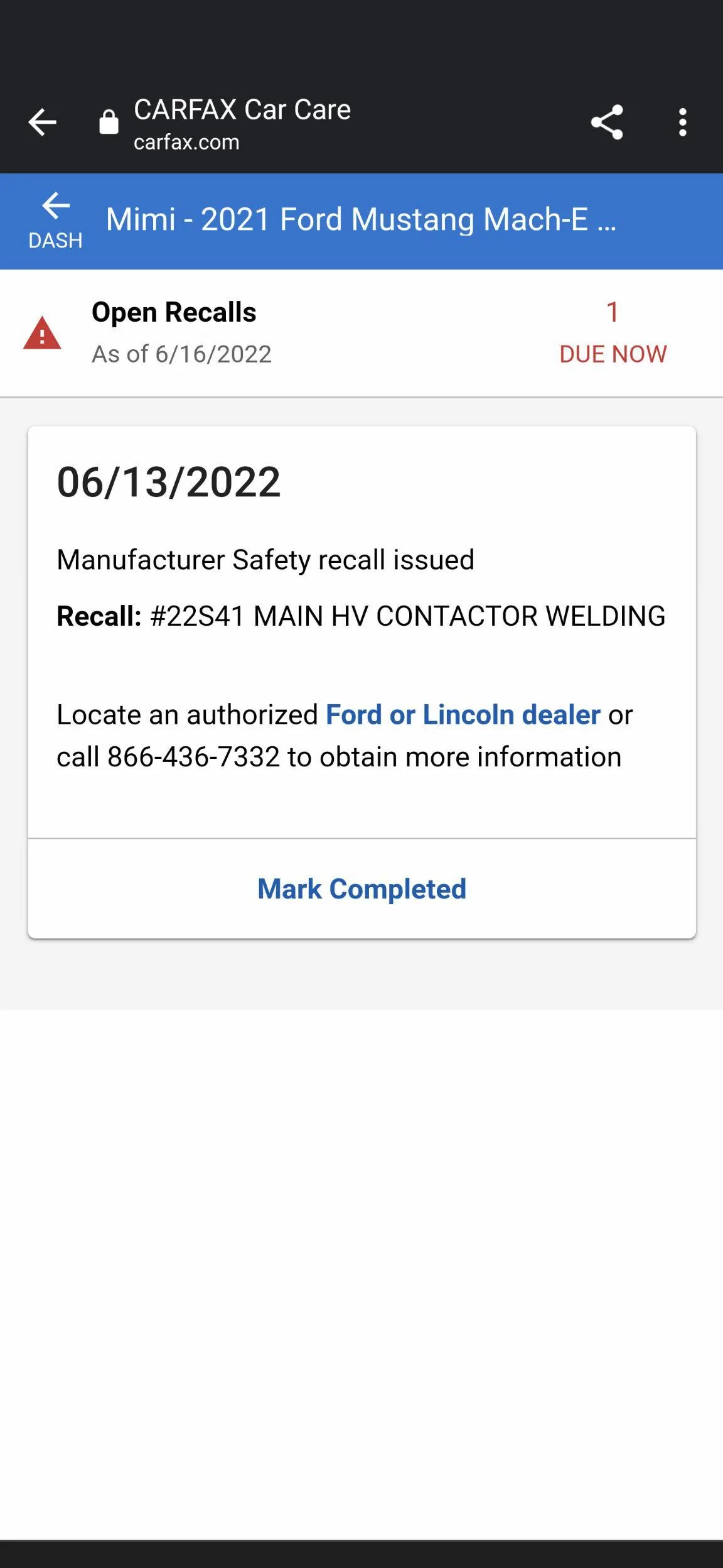

Anyone else get the official recall alert? NHSTA site still shows 0 recalls for my VIN but good ole CARFAX just pinged me... yay... not surprised and I was already sure it was related to HVBJB issue everyone has been buzzing about ?
Ford Mustang Mach-E POWERTRAIN MALFUNCTION / REDUCED / HIGH-VOLTAGE BATTERY WARNING Screenshot_20220616-131615

I'll get the full rundown at pickup but Tech said there was a problem with one of the OTA updates. It updated incorrectly and never "turned off" so it was draining the 12V battery. It also seems like even though BlueCruise was installed and worked occasionally that also was not installed properly so they updated. I guess I have free BlueCruise for 11 months instead of a year... better thank nothing lol. Lastly, my car had the HVBJB recall and they wanted to take care of that so I won't have to go back. Hopefully I get more info on pickup and will share. I'm kind of nervous to do another OTA update if this is what happens though! it has been 3 weeks almost to the day
