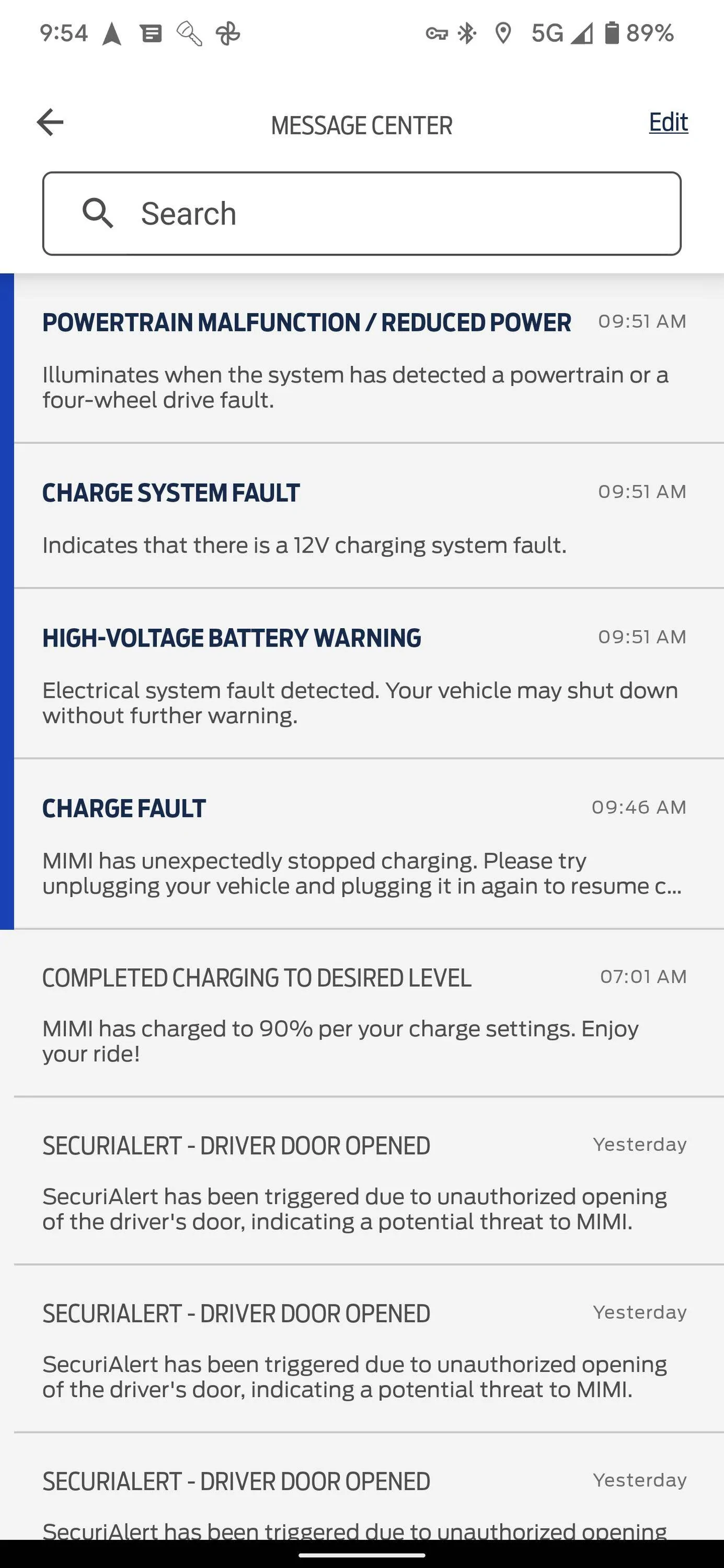

??? It's happening again... I have only had it back for 2 weeks after not having it for 3

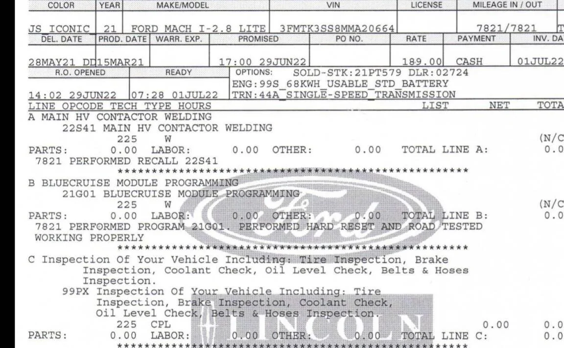

Can you post the technician notes so we know what it was?
hmmm... forgive my ignorance but where do I get technician notes? The only thing I usually get is the "receipt"/"invoice" with some minor notes and showing $0 cost but the drop off on Monday was not scheduled and I forgot the receipt (but can get it)... or is this something that shows up under my VIN in FDRS?
Invoice should show what they did.
11,393
25,106
Yes post the invoice with all the fancy words and part numbers, I can decipher.

well they did check your oil.
This is why I didn't know the invoice was the same as technician notes ?
I take these receipts with a grain of salt lol

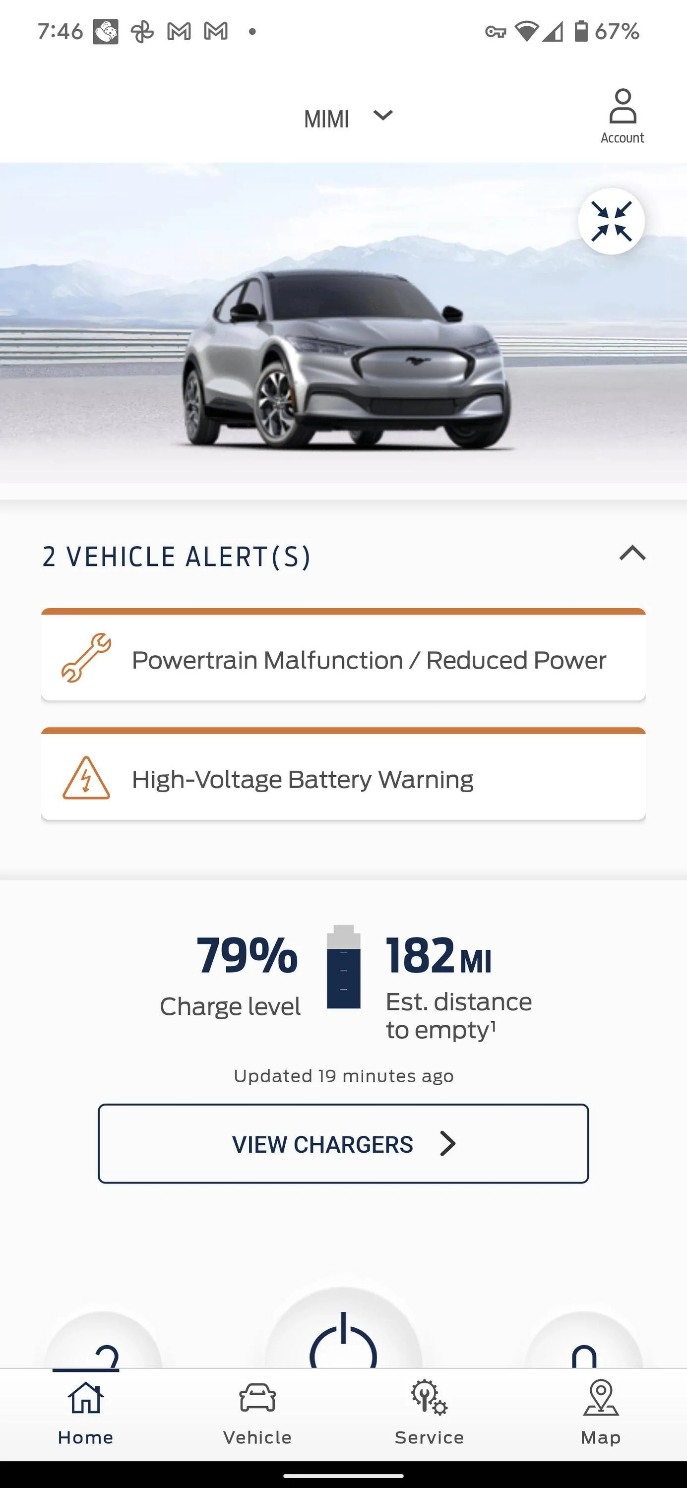

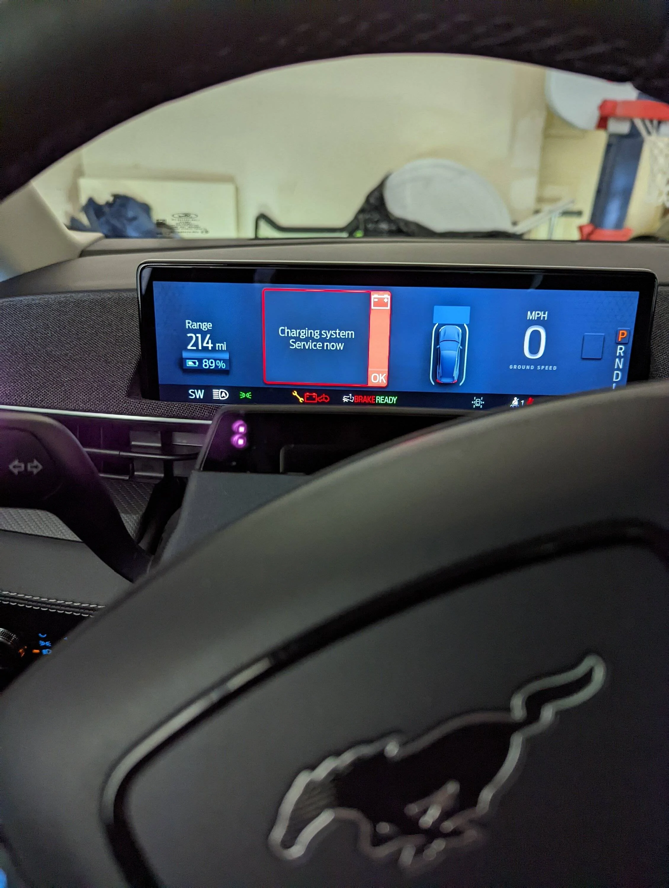

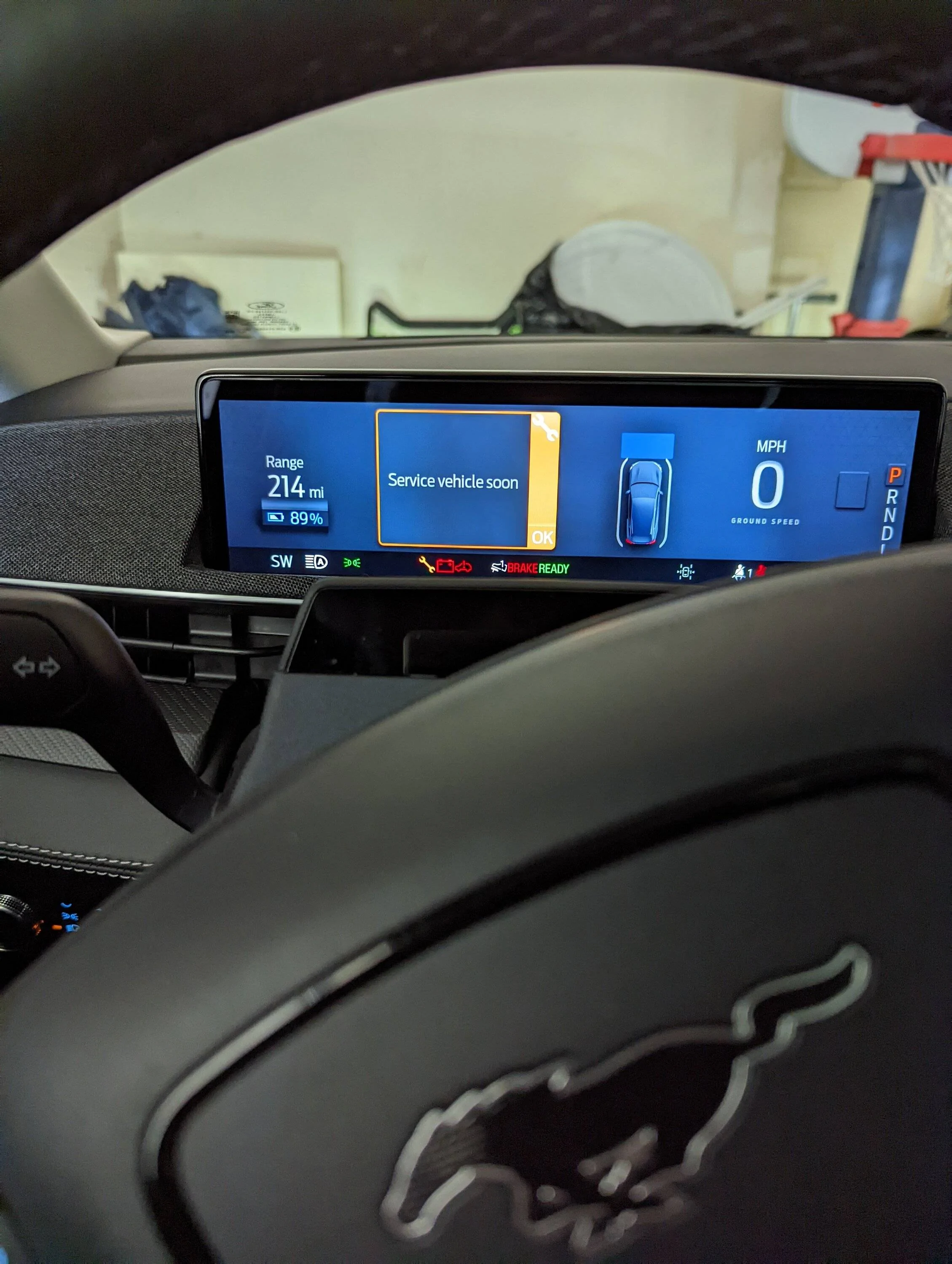

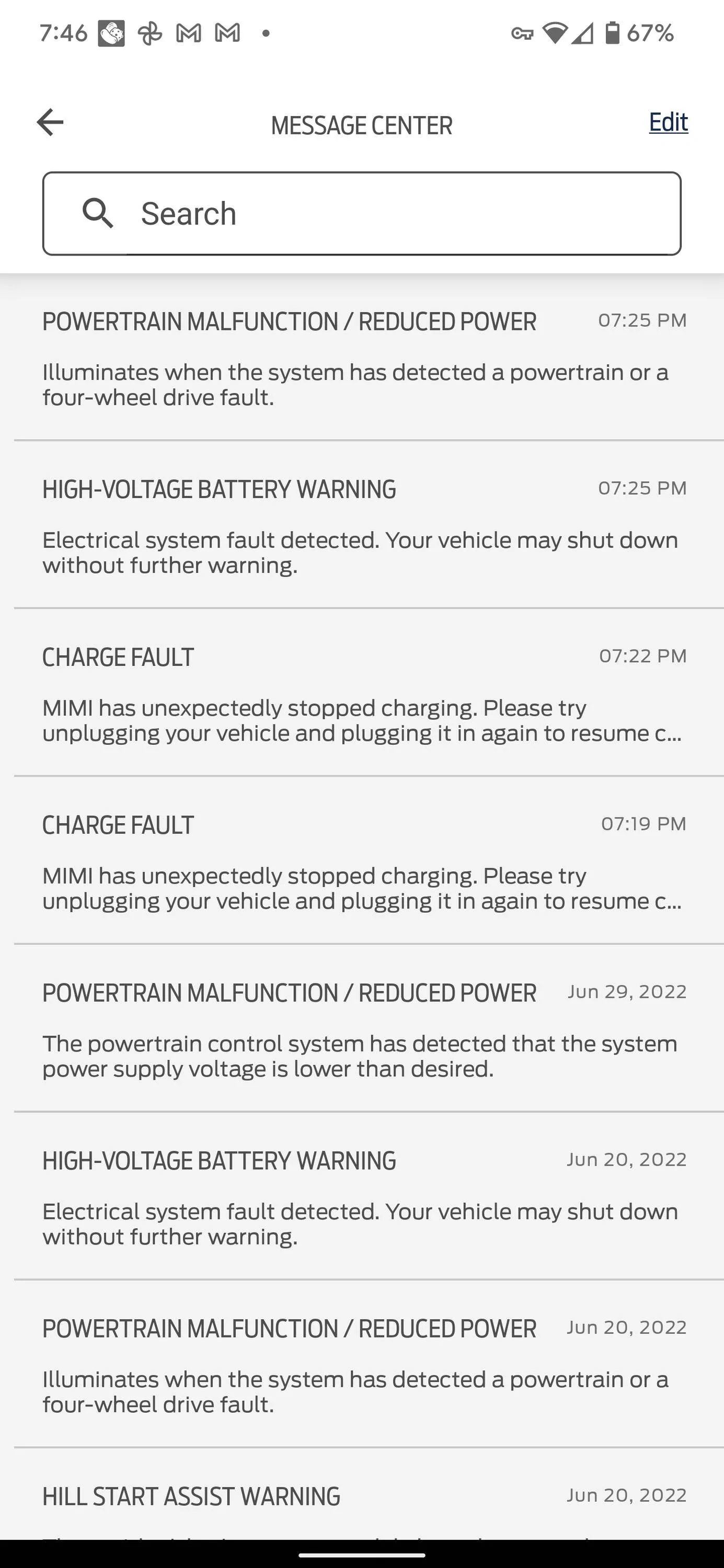

Guess who is going to the dealer right now while I'm freshly pissed off? Stay tuned...

And the 12v battery died while I was in the parking lot on the phone with the service rep.... That's one way to get seen right away.... They are currently pushing my car ??‍♀

Got a loaner (thankfully because they don't always have any) .... They are going to need to drop the battery to replace/fix a part.... I'll get more details on Monday from my usual service rep and ask why nothing was updated on my last visit and if this could have been avoided? And why was I told updates were made but they weren't... Frustrating... I've said bye to this thread like 3 times lol

I got the car back today.... They said it was the HVBJB and they did the hardware replacement (allegedly) ... Service rep wants to make sure all is good now so he said drive it today and over the weekend and confirm on Monday that all is well before he closes out my ticket then he'll send the receipt... ??‍♀
