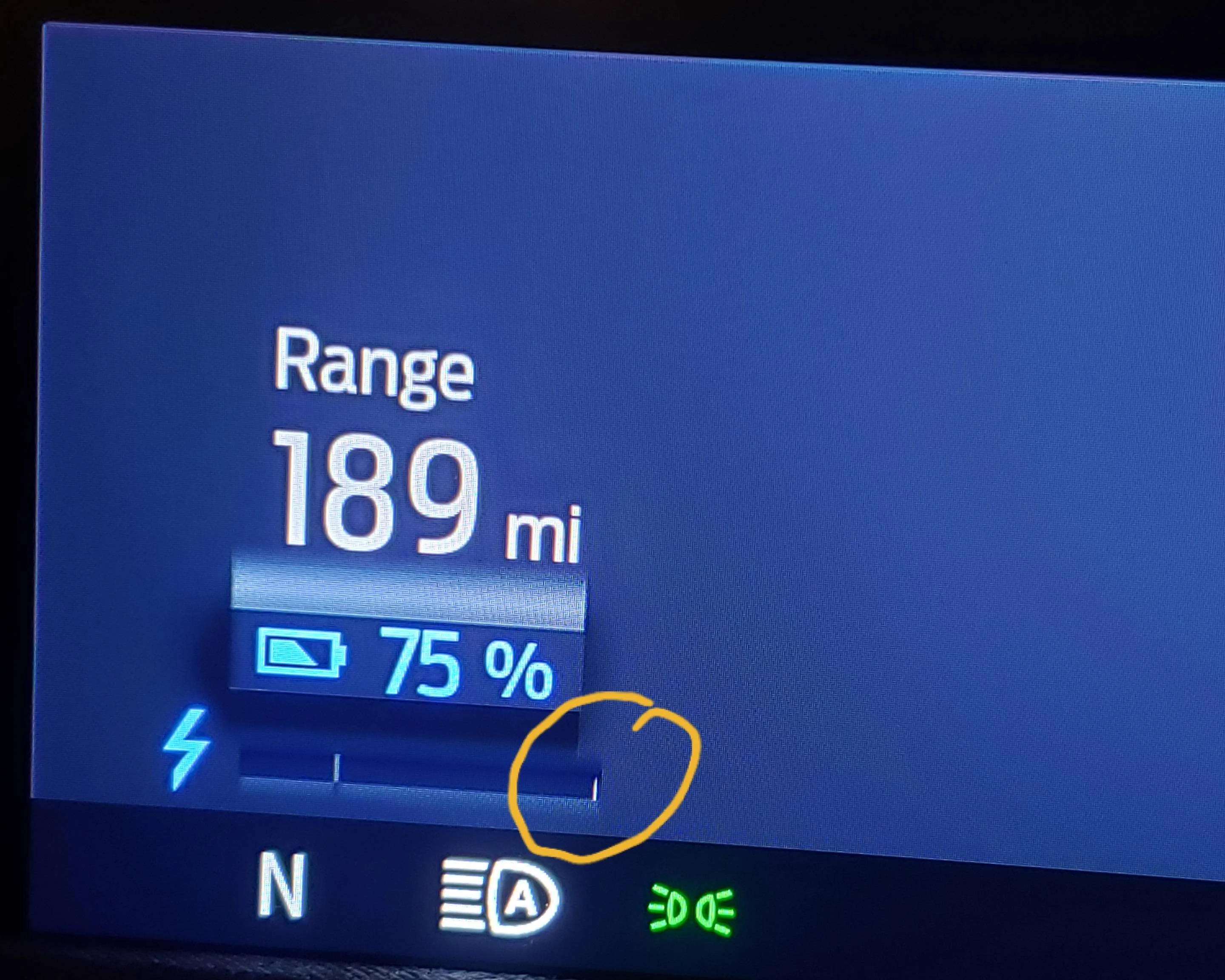

That is very unusual. For me the first gray bar appears at around 77% SoCD. To get maximum power you need a full charge, according to Ford and my car's display.
The other morning I had a single grey bar at 82% SoCD. ?‍♂? That was a little surprising. Heading back from work in the afternoon I noticed 3 bars at about 79%. I wasn’t hammering the car, just driving like it has a bad HVBJB. ??

Here is where you will see the gray bars:
This is my car sitting in my garage tonight and at very warm temperatures. And I have one bar.
I have measured the WOT current draw at 1 bar and it is still over 1,000 Amps, so one bar isn't significant. But it means the car isn't at full power.

Even when my car has over 50% gray bars, from a stoplight it is quicker than my wife's XT5. So if you drive conservatively, it is easy to see why you would not have noticed the power limitation. Smash the pedal to the floor and you will instantly know.

Lots of things will limit acceleration in your GT-
Any speed above 72 mph gray bars show up (even just cruising on the highway).
Lower states of charge.
Battery too hot or too cold.
Repeated acceleration.
In your 0-80 run you definitely lose power above 72.
There’s an old video here somewhere where someone took a GT canyon carving. And after a few minutes of fast driving, acceleration literally slowed to a crawl.
At full throttlenit barely moved. Like 1 mph gain per second (10 seconds to go from 70 to 80 mph). It’s kinda ridiculous.
In normal driving and warm temps? You’ll never have that issue.
