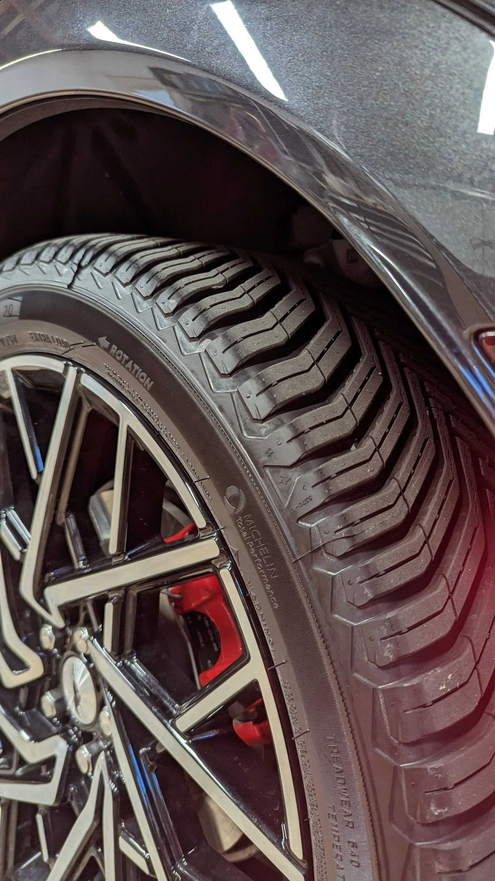

I have CrossClimate2's on my GTPE ...
Before anyone comments - yes we get snow in California and I drive in it often to visit my dad or go snowboarding/skiing.
If you're in Salt Lake, get them from Les Schwab. For $99 they store the summer tires and change out to the winter. In spring, go back $99 they swap them and store the winter for you. That's a lot cheaper than going with a new set of wheels.
Also the CrossClimate2s ride a lot smoother than the factory summer tires.
Ford Mustang Mach-E GTPE Winter Tires and Range PXL_20221023_215644882.MP

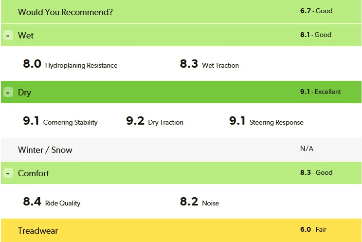

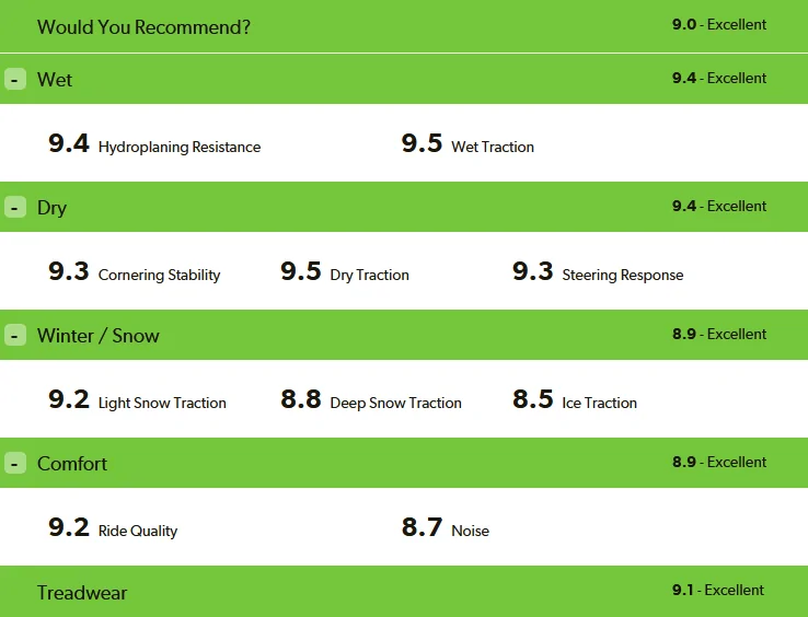

How are the crossclimates for non-winter? I have them on my wifes car but she has a prius so not really pushing it by any means. Most likely picking up dedicated winters but the crossclimate 2's are great in snow around Denver.
First of all, I'm not a rubberologist and although I have gone through racing schools and spent time on the track, I'm not going to act like I'm some expert on road gripping tires. For that I resort to people who do tires in their sleep.
So if we head over to TireRack the CC2's are actually rated better than the stock tires on the GTPE in almost every category including dry conditions. I was down to the wear bars on the stock tires and I am at 29k. Based on others reports on wear the stock P-Zero's are not the best wearing tires.
CC2s:
Ford Mustang Mach-E GTPE Winter Tires and Range 1666583448381
Stock P-Zero Electric:
Ford Mustang Mach-E GTPE Winter Tires and Range 1666583429325

As I mentioned above I would suggest looking at TireRack and compare the tires. Although the CC2's are "All Season" almost every review I've seen on them gives them really good ratings in normal snow conditions.
In our area we don't have icy roads, it's normally always plowed, sanded and I don't intend to off-road the GTPE in a snowy mountainside. Also in California studded tires aren't allowed. Based on the reviews and the way our winter road conditions are I felt they would be best.
