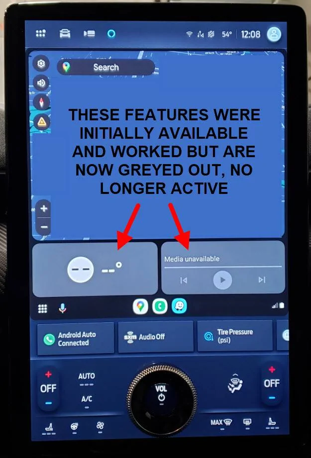

I have a s23 ultra and a 24 Premium job 1. My phone drops AA constantly. Now i get a message to connect usb for AA. Girlfriends S24 ultra connects and works fine. Stepsons Iphone 13 also connects without issues. I did a reset of network settings on my phone and connected fresh. Phone set up but dropped wireless connection right away. I really don't want to do a factory reset on my phone. Dealer updated software in car and i updated software on phone. Any ideas as to what i could try?

Restarting radio and phone will usually give me 5 min of AA. S24 stays connected.
