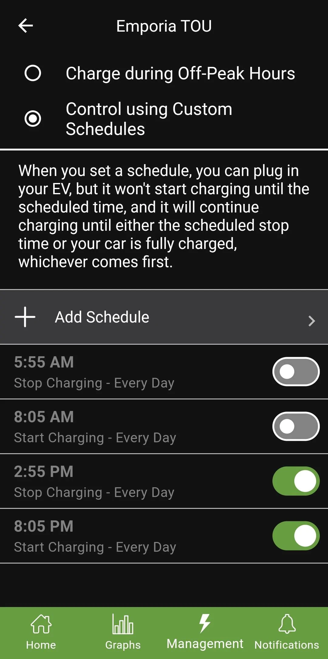

Hoping someone will be able to help me out. I’ve been having some issues with the Emporia charger actually charging my ‘23 MME. Emporia is hard wired and car is currently set up on a schedule but can’t get the charger to unpause (it’s in the scheduled charging time window). This has now happened a couple of times so I read through the forums and saw that resetting the breaker may help. That fixed it the first time but not tonight. I plugged in the Ford travel charger into my 110 outlet and that seems to be working and will get me enough charge for the morning commute. But I’m wondering if I have a defective Emporia unit. Any ideas? Has anyone else experienced this and was Emporia helpful in fixing the issue? So frustrating.
