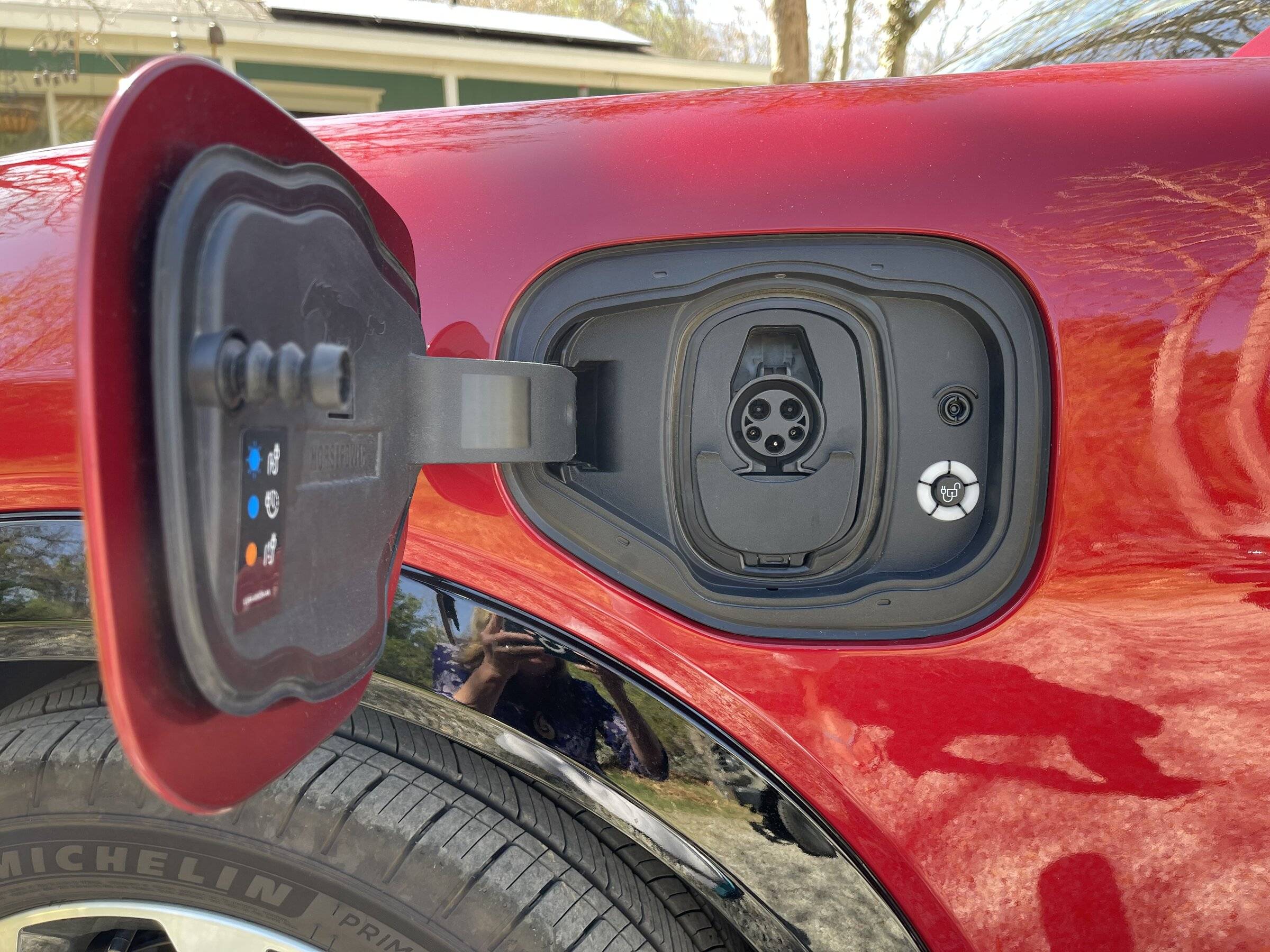

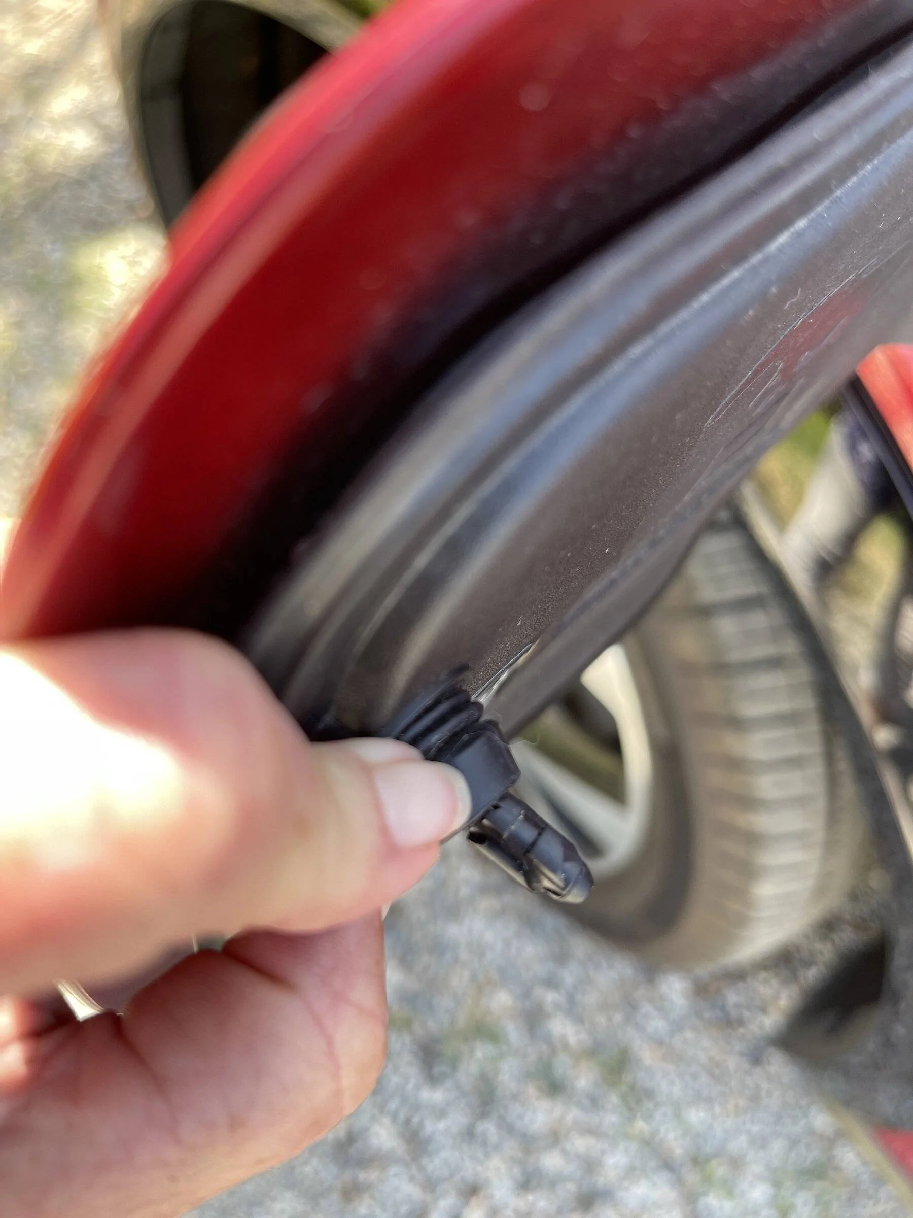

Yes- didn’t see anything. Sprayed with dry lube. Someone mentioned that BMW has the same part- found and I think ordered. Also working with dealer to order the part(s). At least I can charge and drive. Getting Velcro strips to see if that will keep it closed until it gets fixed.

Haha! It was the way I had to hold it and take the pic!!?

I think you can unscrew the "male" part pretty easily. Then you should be able to get it closed easily. I think you'll just have to replace that part.
