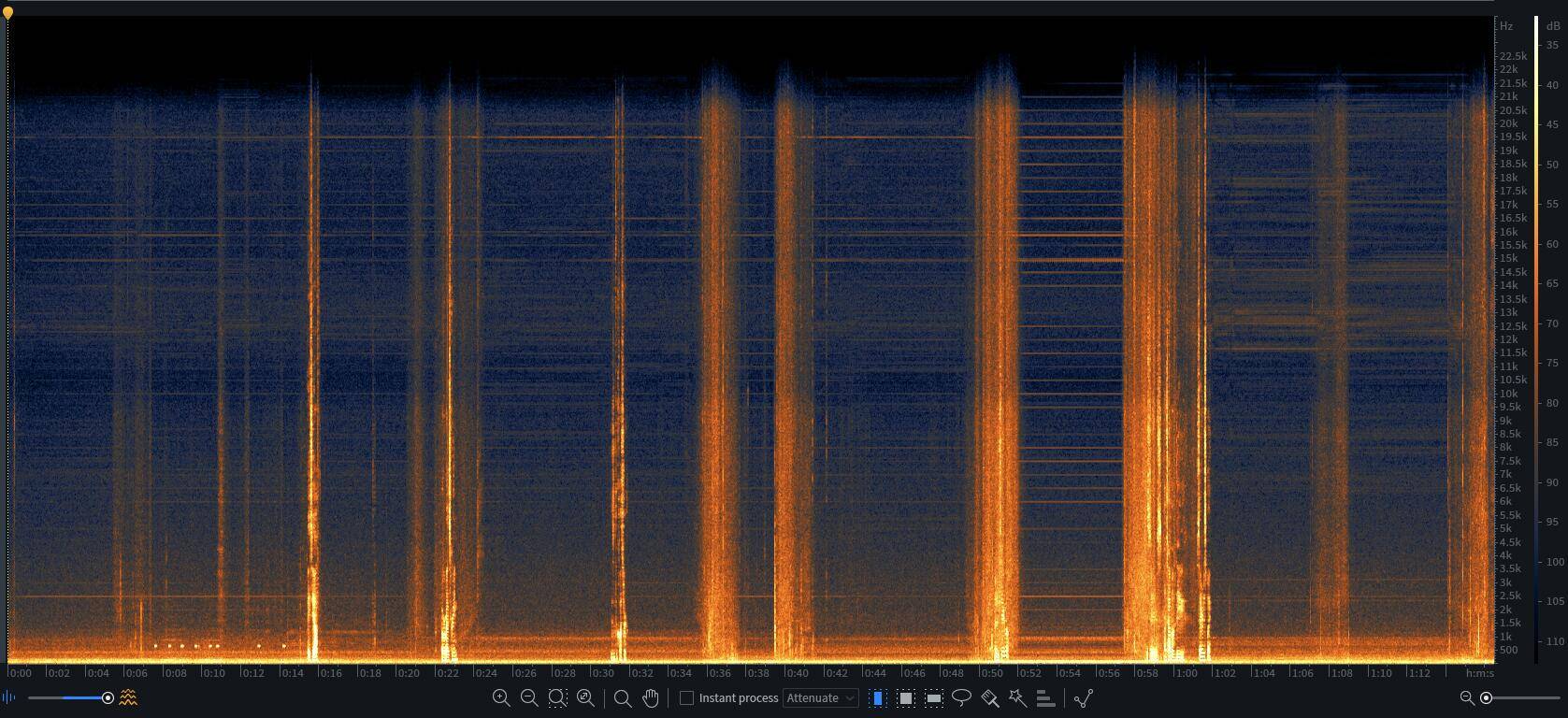

There may be a lack of masking effect, but it's not the primary issue here.
Here is an image of the sound in the Lightning. The horizontal lines are tonal noises just like in the Mach-e. I can hear these sounds while in motion in the Lightning. They would also stick out in a luxury ICEV that I am used to driving, such as a Lexus or Mercedes.
I recorded some ICE cars in accessory mode and heard and saw almost nothing. The EV systems (drivetrain, inverters, battery cooling, screens, etc.) are adding annoying high frequency tones even when the truck is doing nothing. You are right that tonal noises are harder to ignore than broadband noise.

Most of the engineers are probably too old to hear anything above 10k, they likely have no idea how much high frequency noise is happening. Since they've never dealt with high frequency electronic noises before, I wouldn't be surprised their NVH program does nothing to detect, quantify, or address them. They should be running a spectral analysis like this during NVH testing of EVs and specify component noise thresholds to their suppliers like Visteon. And obviously run instrumented NVH spot checks on the assembled vehicles to ensure consistent quality. Display loudness really varies, you could get a quiet one or a loud one from the factory.
The worst noisemakers in Mach-E at idle are the instrument cluster and the power steering motor. The front motor in the non GT's also has gear whine around 30 MPH, Magna should have tested that better. The windshield gap is also a noisemaker on some cars if the windshield isn't placed just right, and the tempered front windows also let in a lot of side mirror wind noise. It's not horrible, but things could have been done better, as a result the Mach-E really isn't any quieter than my 13 year old Fusion.
Yep, yep, and yep. Lots of noises, exactly where you said. At this point just have to live with them.
