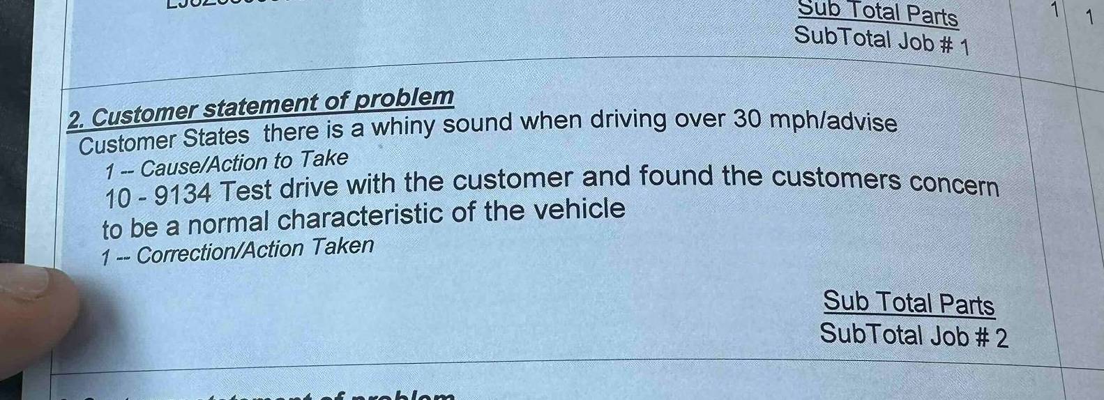

The Ford support here reached out to me (as they responded to you) and opened a 'case' for me. In order for them to do anything, they had to have the dealer look at it. I took it to my dealer and on a quick test drive with the head mechanic, he said it is a 'normal characteristic' of the vehicle, to which I am extremely disappointed with. It's an awesome car otherwise. I never received a response from the 'EV Concern Team'.
I'm as frustrated as you because it is an annoying sound unless you have the music on. Maybe my ears are sensitive to 1.7KHz...
Ford Mustang Mach-E High Pitch Whine IMG_8190
I hope if enough people raise this issue it will be looked at. It is not normal. It's similar to when a radio/speaker isn't grounded properly. I don't think they are investigating the root cause of the issue. I had the EXACT issue with a model 3. To be fair it developed about 4 years into ownership and it has the same characteristics of this Mach-e noise. Whine at specific mid speed constant load, they resolved it in 30 min, free of charge cleaning off the grounding strap of my rear motor on the Model 3. If the front or rear motor is indeed not grounded properly it might be the cause of the noise we are hearing.

I agree. It's not normal and shouldn't be present in this class of vehicle. I've seen resonances in other types of electric propulsion systems that are excited in operation.
There is a TSB (Technical Service Bulletin) for previous year models of this where they addressed it with software, and my assumption is that they likely applied whatever fix natively into the 23 models, but I could not get confirmation of this.
See this thread. https://www.macheforum.com/site/thr...tween-30-40-mph-48-64-km-h.30916/#post-696646
