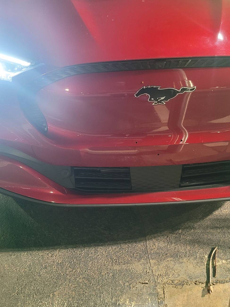

Update, Ford thought they had the problem solved considering they had replaced everything regarding the charging system. To include the battery pack. I picked the vehicle up on Friday the 27th at 77%. I proceeded to drive it down to 4% and went to an EA 360Kw. To my disappointment I peaked at 42 for a second or 2 and then it promptly drop back down to 32 KW. Needless to say I drove right back to the same dealership and drop the keys in the Dropbox. The following morning I sent my service advisor a text message with pictures showing the issue is still the same. My biggest concern at this point is they don't seem to know what the issue is or how to fix it.
Ford Mustang Mach-E Horrible DC Kw Rate 20240927_212855
If I recall someone asked or mentioned about the cooling louvers during fast charging and yes they did open.
Ford Mustang Mach-E Horrible DC Kw Rate 20240927_212119
Just curious if you tried more than one dispenser or more than one DCFC location?
Slow DCFC speeds like that are common at EA if the cable cooling is broken.
