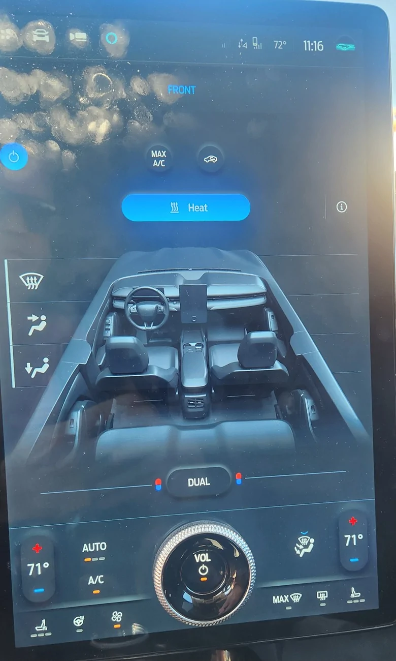

If I turn on Auto, both A/C and Heater are illuminated, even when it is 72 degrees outside. Does that mean they are both running at the same time? Am I wasting energy? Should I turn off certain controls off if not needed. I'd be happy with just some outside air ventilation on a nice day like the old car days.

Yes, heat and A/C may run at the same time for dehumidification. No that is not wasting energy. Because likely only a tiny amount of heat is being used, probably even waste heat from the motors.
It’s best to just use the AUTO setting and adjust the temperature to your preference, and don’t worry about the rest. The HVAC is optimized to use the least amount of energy to keep the cabin conditioned.
HVAC is also only a small amount of the total energy used in most cases. You would only need to worry about shutting that stuff off if you are running really low on range.

You can avoid using heat or A/C by not using “auto”, and then by selecting the dash vents only and manually adjusting the fan speed to your desired speed. It will be just like old school vents. That’s all I need the vast majority of the time here in California.

Even though both the heat and A/C buttons are highlighted, they’re systems that are automatically controlled by the car’s HVAC module. If one or the other is not highlighted, the car cannot activate the one with the dimmed button. The vast majority of the time the car will be using one or the other. There will be times when the car will cycle both on in order to handle humidity or for other reasons. These are normal transient events. 😁🐩

Looking at OP's image, if you turn off Auto and AC buttons you at the bottom of the top level screen and on the displayed climate screen touch the middle of the three icons--the one with the arrow pointing to the icon's torso--that turns on the vents. And as stated, the fan will then control the air volume.
You can further adjust the air volume on each individual vent, too.
