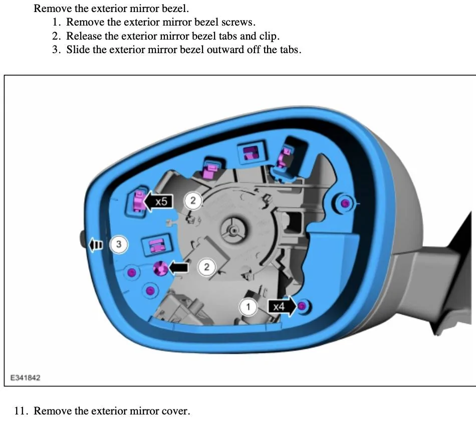

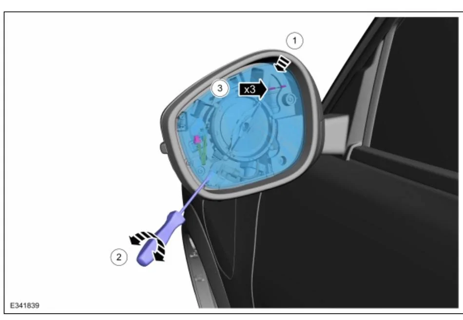

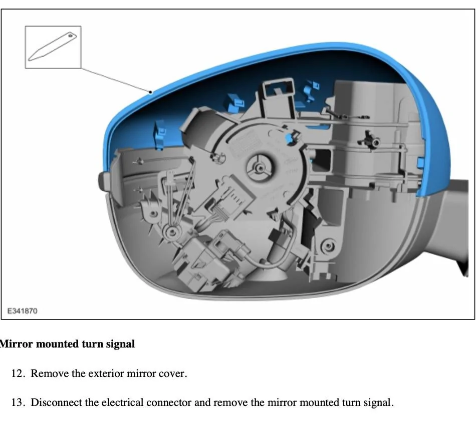

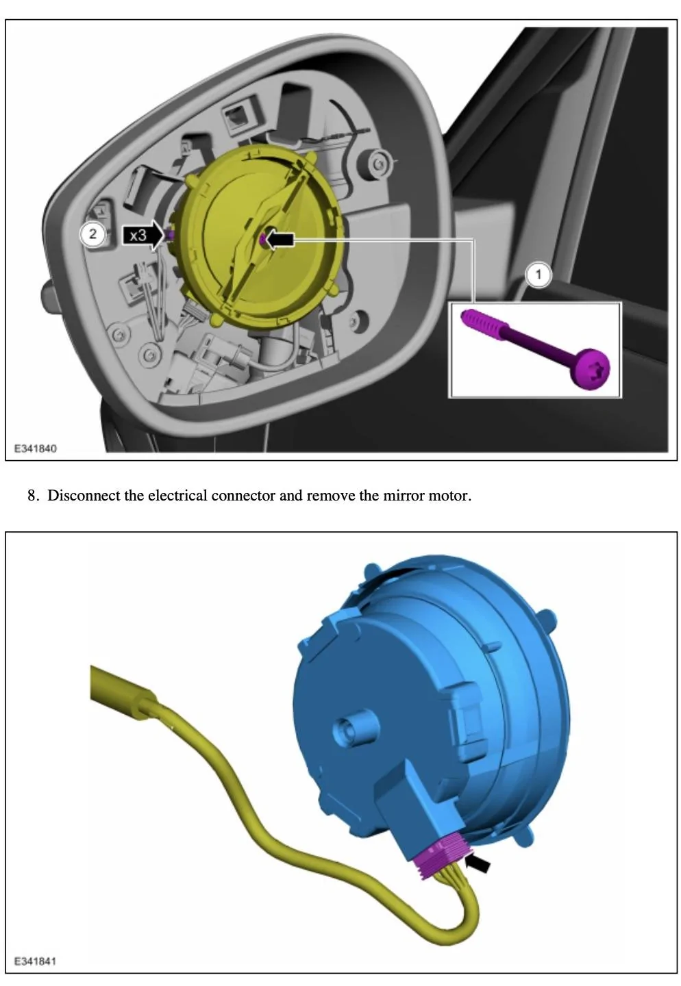

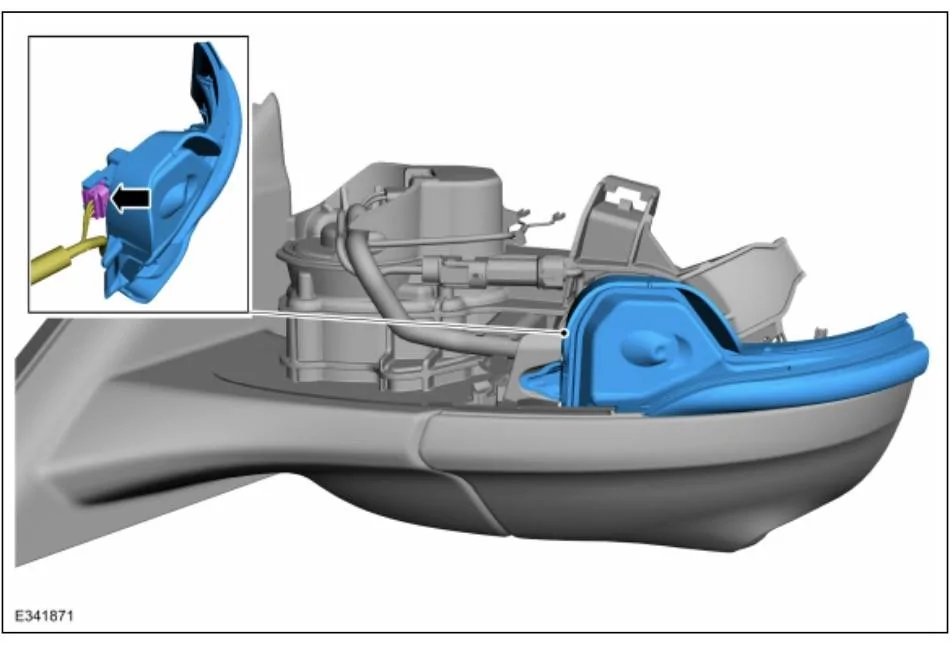

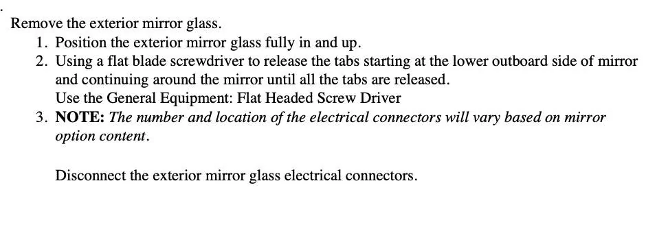

Removing the mirror glass is fairly easy. Many of us here have done so in order to replace the factory glass with the SUMA mirrors ( #1 ) that give a better view and eliminate the blind spot on the drivers side. The proper way is to move the mirror in and up ward and use a thin screwdriver to pry between the mirror and backing plate it is attached to. It's held on by plastic clips. I've done a few and most the time I just grab the mirror when it is in that position and rip it off. Sometimes a clip on the mirror breaks off but I'm installing new mirrors anyway so it doesn't matter to me. If you happen to remove the mirror and do break a clip, I have spare mirrors that are in perfect condition I can send you. All of that said about mirror removal, below is from the repair manual about mirror disassembly.

Mark... Thank you so much for posting such a detailed response to my question. Very much appreciated and all good now!
Thanks again.
Roger
