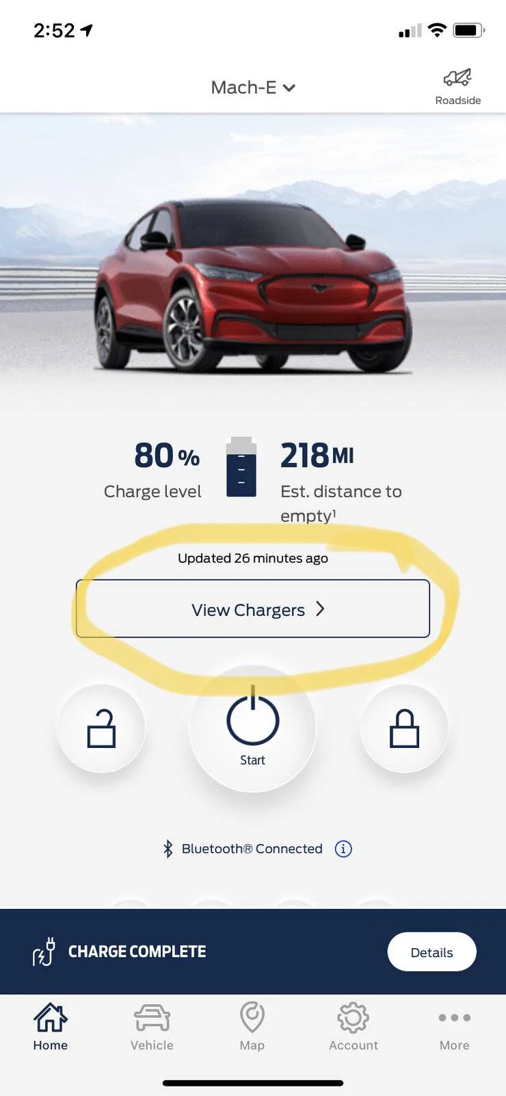

When I get to a charging station, how do I use the FordPass app to start a charging session?
You can start a session manually.
Click on View Chargers from the Home screen

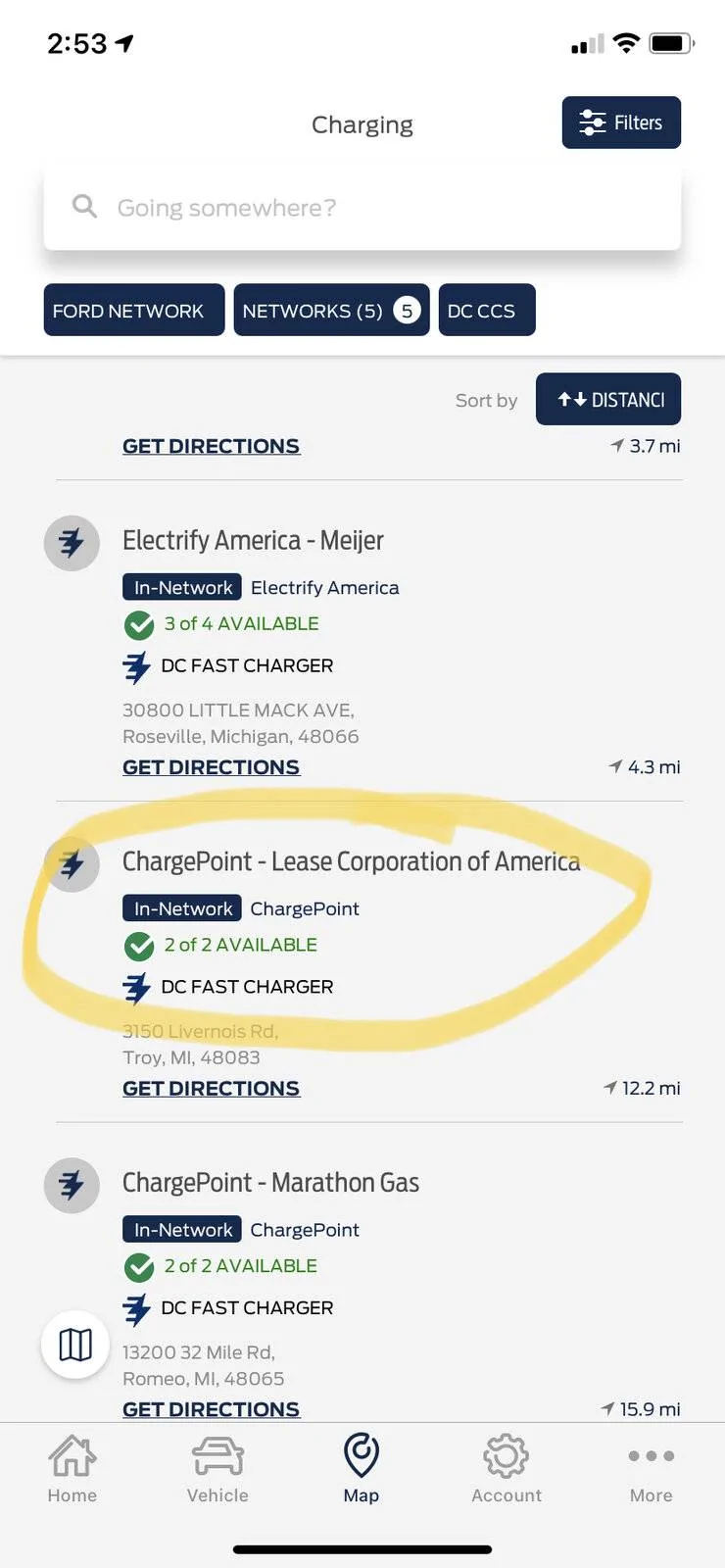

Click on the location

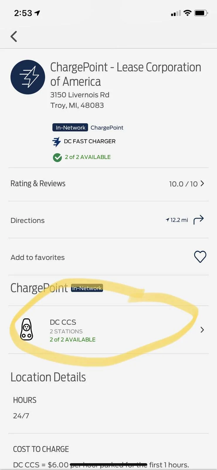

Click on the charger type

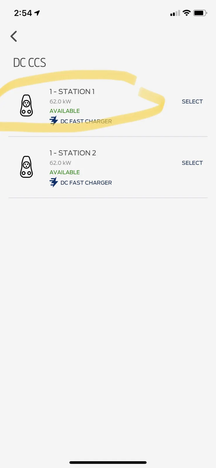

Click on which handle

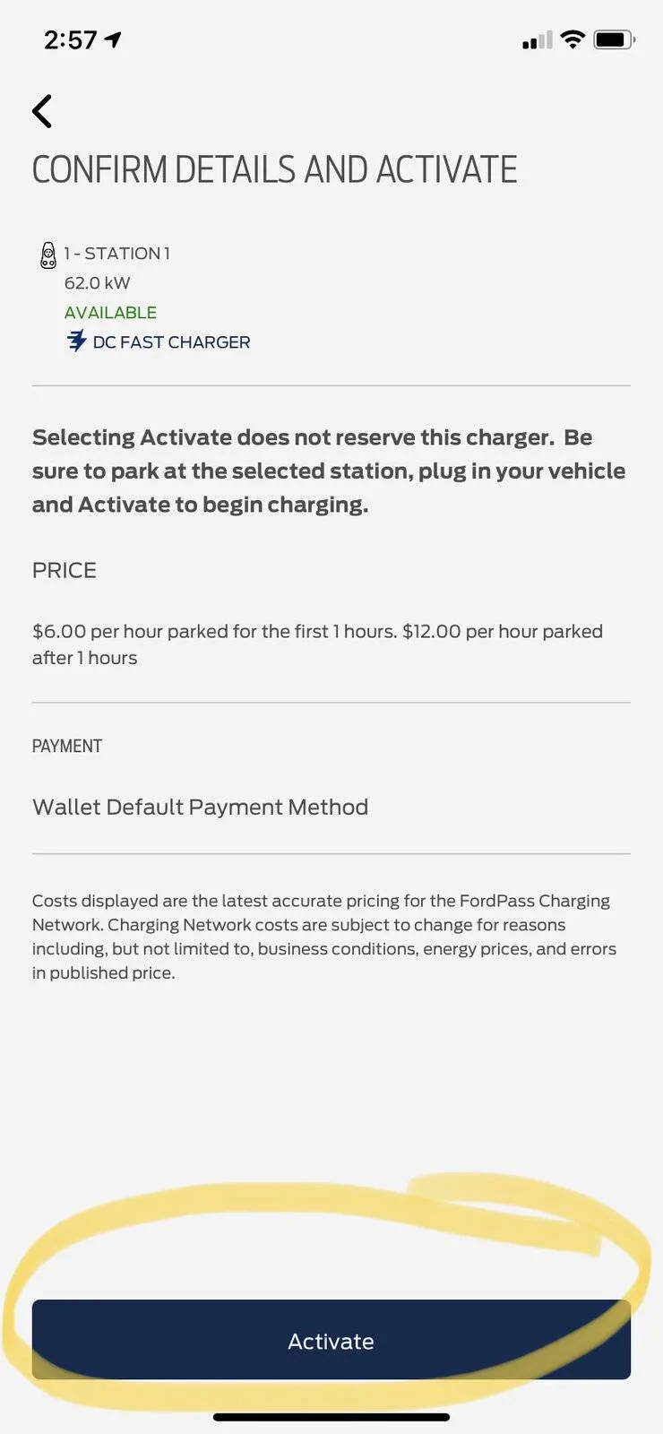

Click Activate
Ford Mustang Mach-E How do I start a charging session with a FordPass app 4BE2F71C-09B8-4174-9BD7-5F052FACB4B2
Then follow the directions on when to plug in.

THANK YOU, @hybrid2bev !
That worked! I was accessing chargers through the Map tab, and those screens only show charger info without letting you select or activate them. Using “View Chargers” did the trick. Thanks so much!
