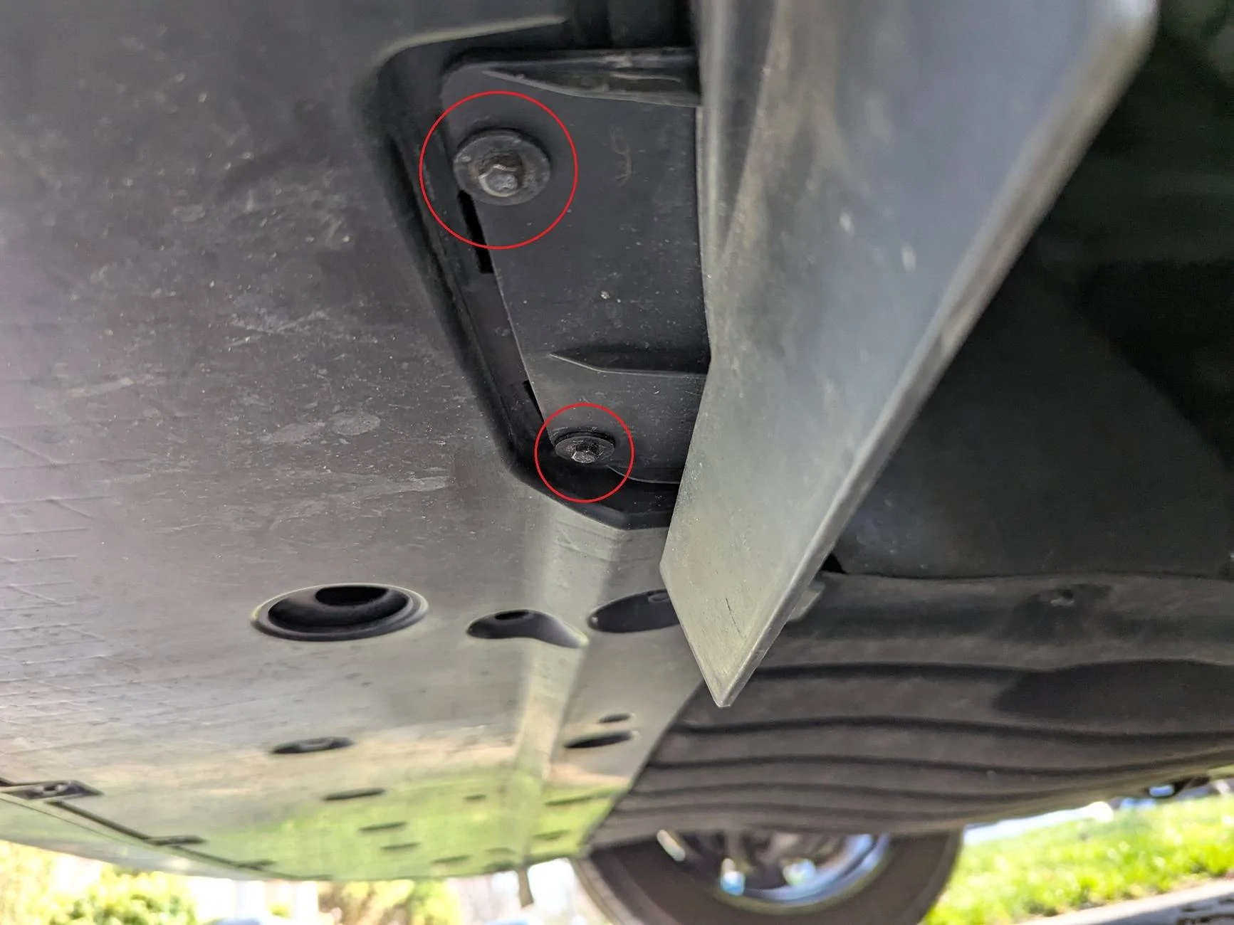

Step 2: Remove the wheel well liner

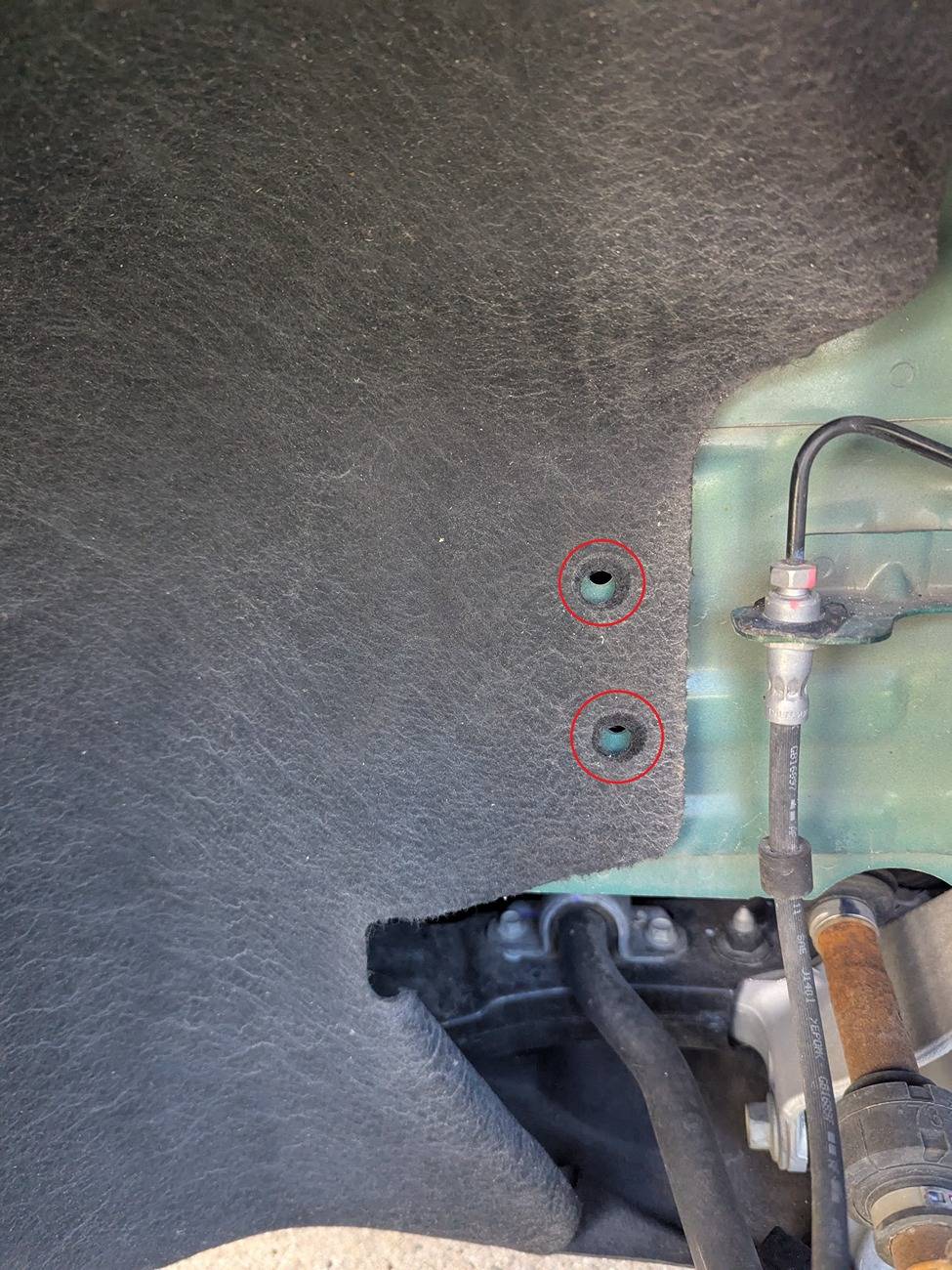

  • Removing the wheel well liner was the most time-consuming part of this repair. While it is not necessarily hard, you need to take your time with this step. There are tons of body trim fasteners to remove all throughout the wheel well. You will want a set of auto-trim tools to remove these fasteners.
  • Take your time with this step and double-check that you have all of them removed before trying to pull the wheel well.
  • There are two different types of auto trim fasteners that need to be removed, and I would keep track of them for when you put them back together. I circled the image in red with the most common type of fastener and orange, where a second type of two-piece fastener is used. The single-piece fasteners are only used with the liner itself, and the two-piece fasteners are used when it goes through a piece of plastic and the wheel liner together.

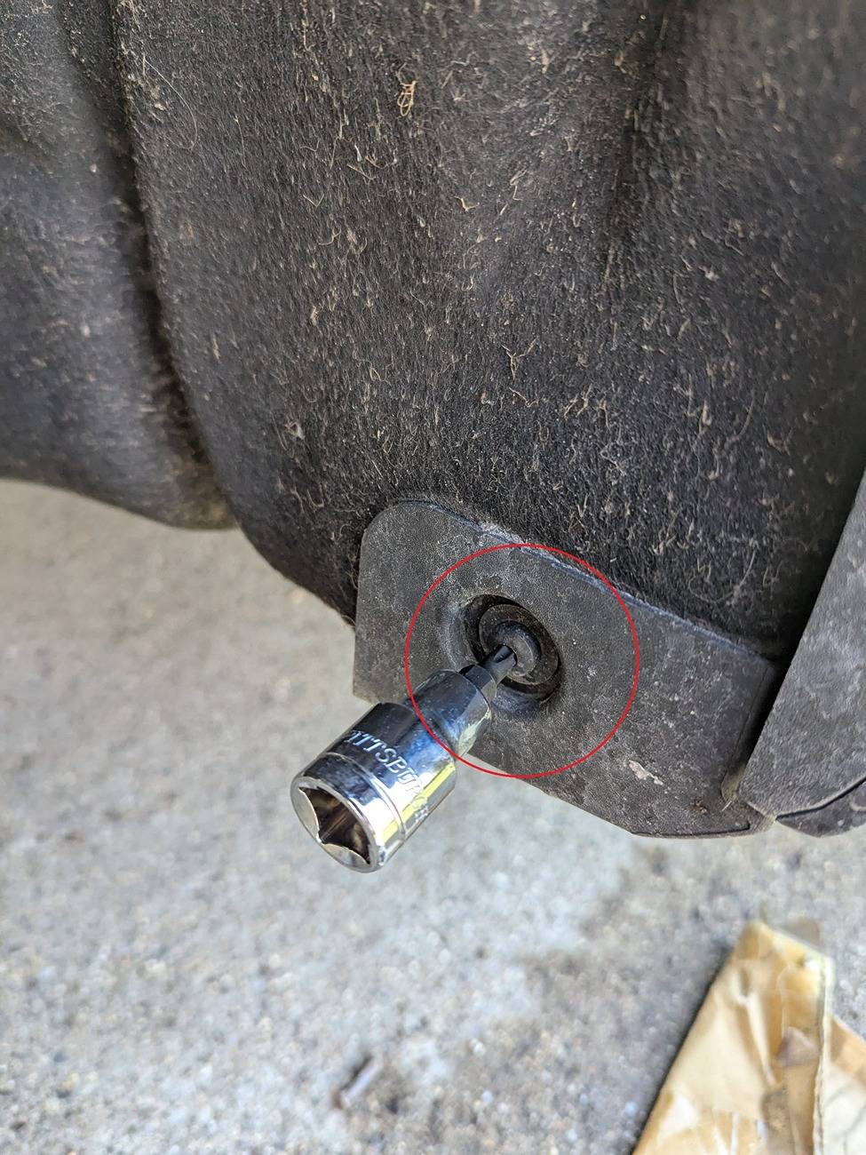

  • There is a small deflector in front of the wheel that will need to be removed; which is secured by two trim fasteners in the wheel well and two screws underneath, which require a 7mm socket. Once the fasteners are out, it is held in with a plastic clip that is molded in the part. Be careful not to break this clip as you pull the deflector off.
  • There is one screw that requires a torx T30 bit to remove on the bottom corner.

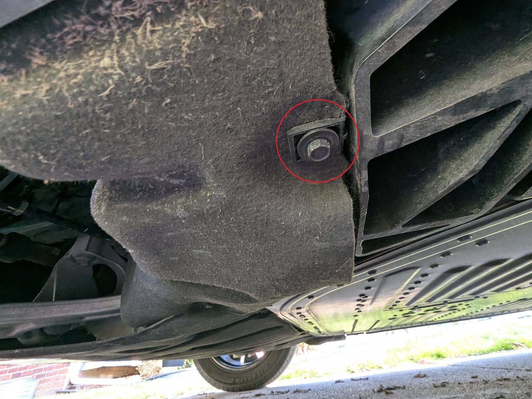

  • Four bolts that take a 10mm socket must also be removed from the underside of the car to hold the wheel well liner in place. The liner is sandwiched between two plastic clips in the back, and you must slide it loose out of these areas, being careful not to tear the liner.
  • Pull the liner out carefully and slowly to make sure that you have removed all of the fasteners and do not tear it. I found a couple of fasteners that I missed when trying to pull it out the first time.

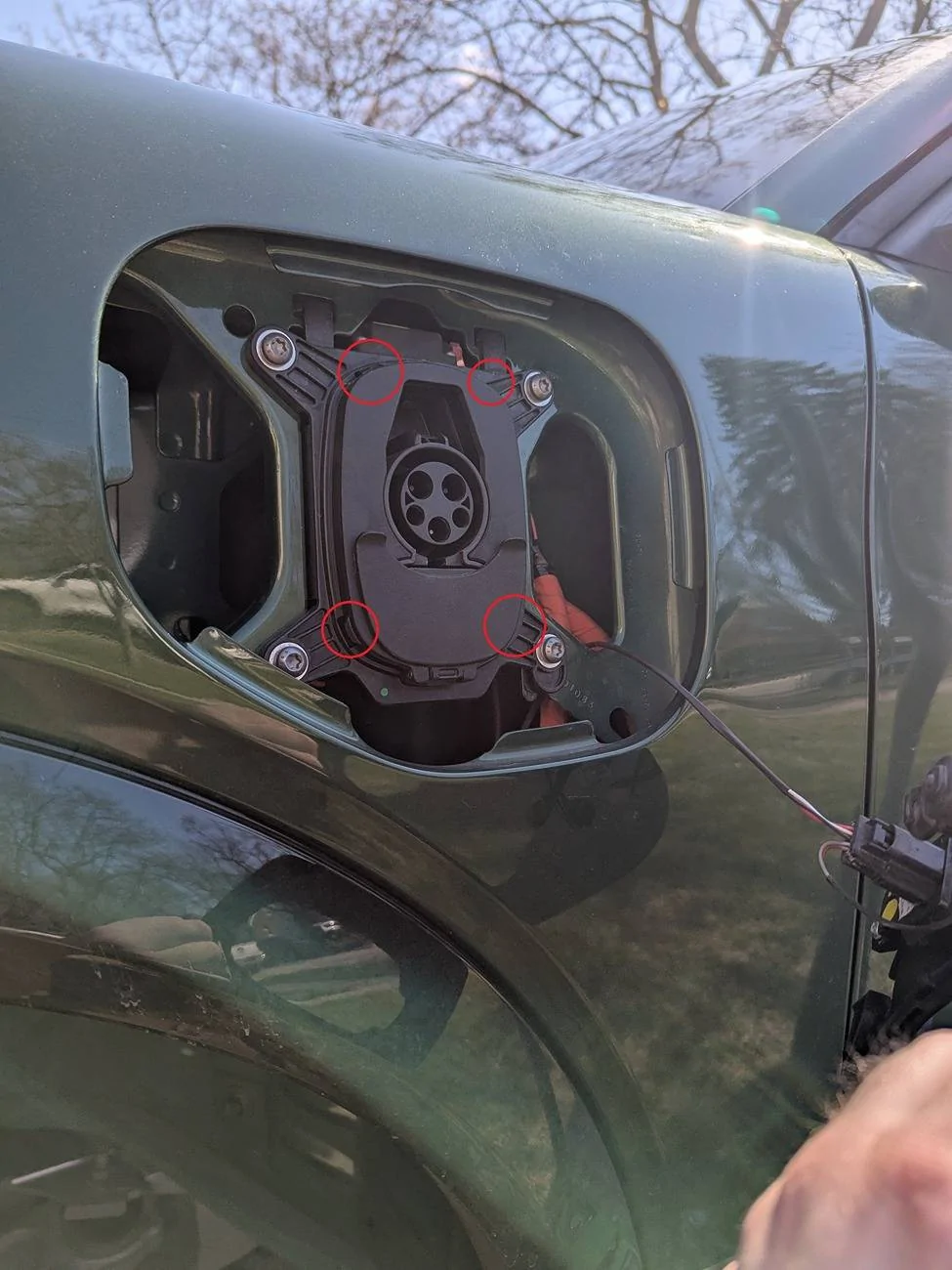

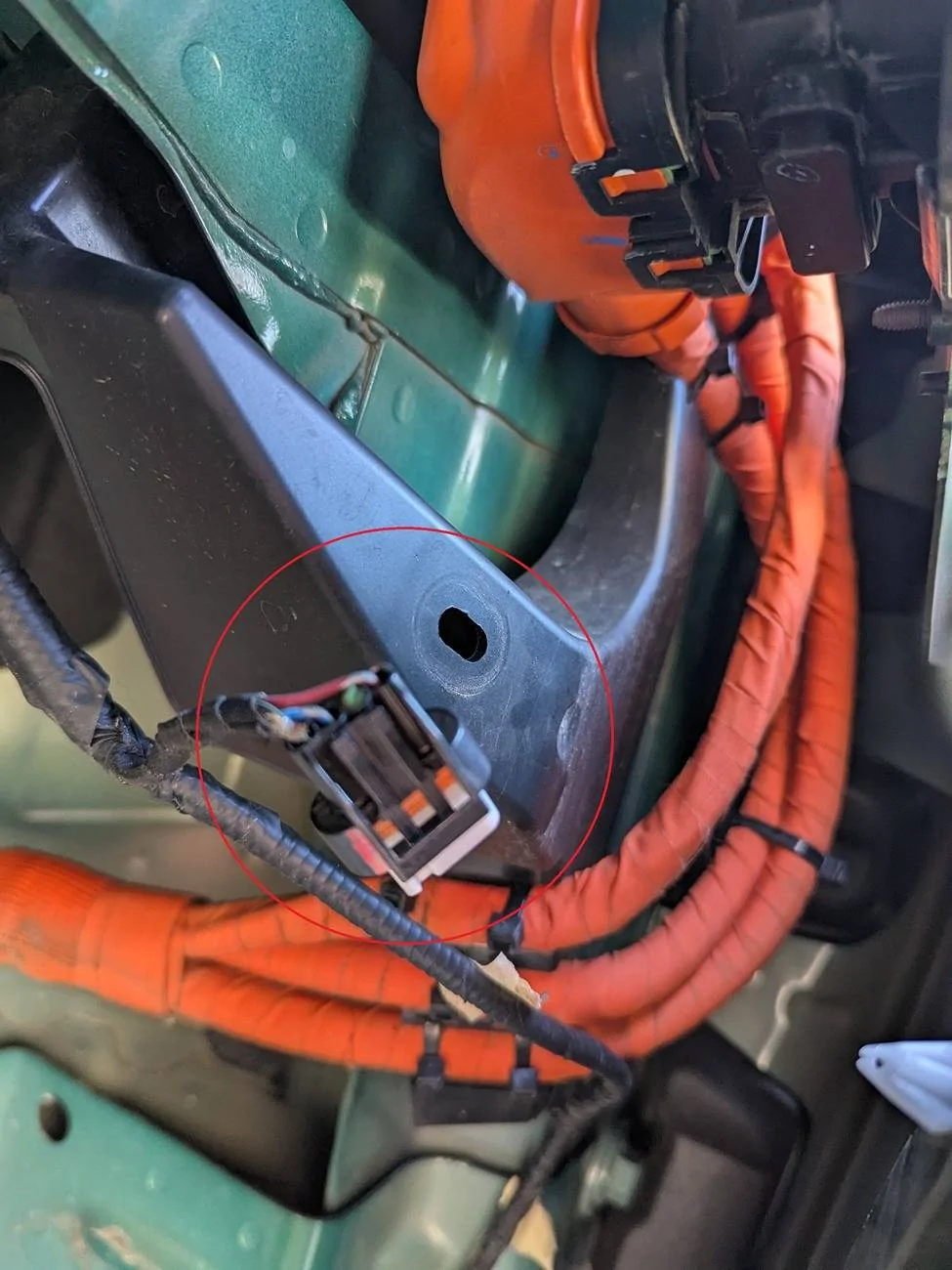

Step 3: Remove the charge pocket

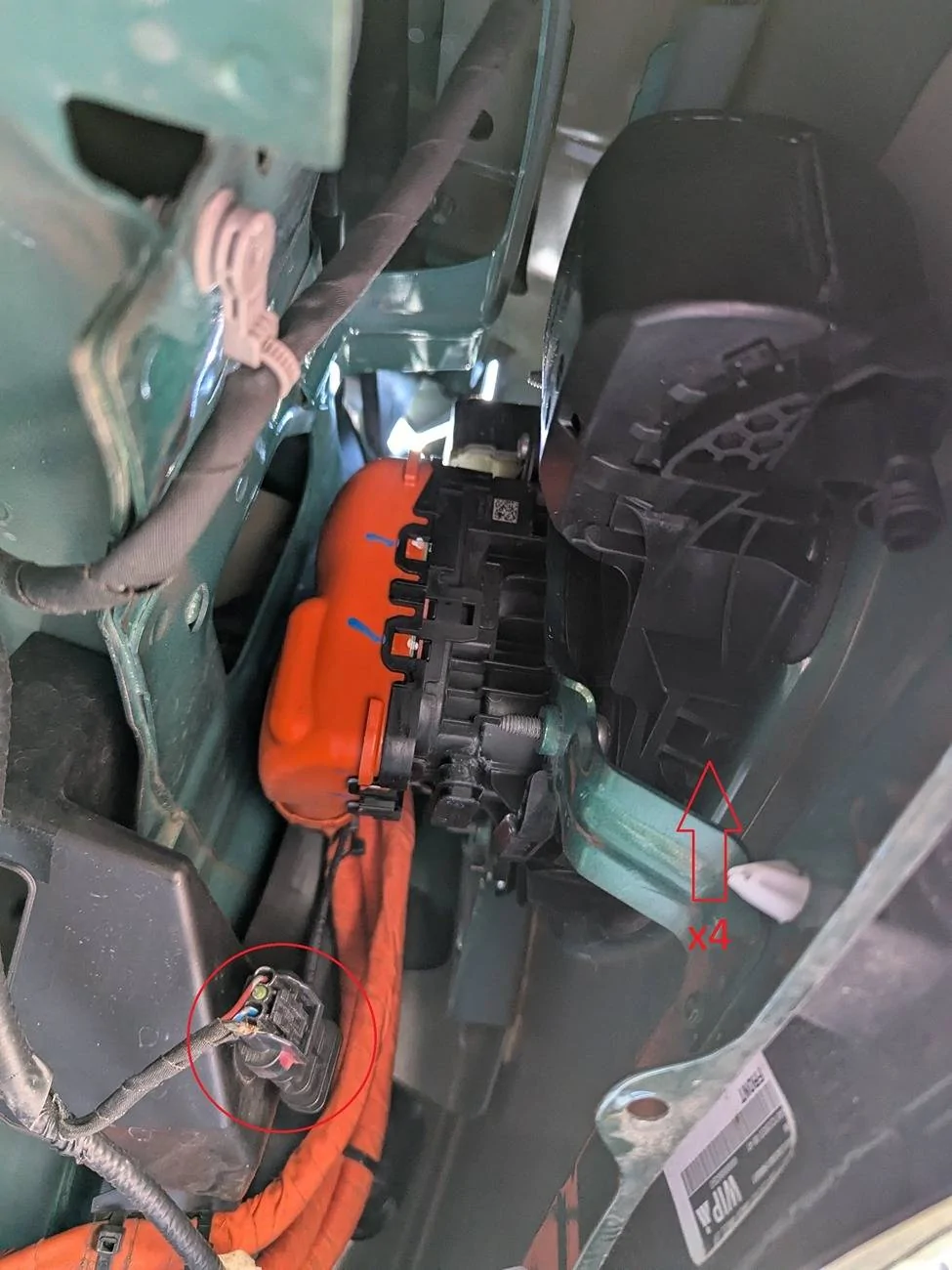

  • Once the wheel well liner is removed, you should be able to look up into the fender and see the back of the charge port.
  • There are four clips built into the housing that you need to press in so that you can pull the charge pocket assembly toward the outside of the car. I used my fingers on these clips and slightly pulled from the outside once each one was loose.
  • I took one of my plastic auto trim tools and placed it between the fender and the charge pocket assembly once one side was released so that they didn’t clip back into place.
  • You will need to swing the assembly out at an angle as the hinge portion tucks back behind the fender. Once it is loose, there are four areas around the charge port where the pocket snaps into place. These will pop loose with a little bit of pressure.
  • The new charge pocket comes with the charge indicator already included. You will need to follow the wire back and disconnect the wire, which is located just behind the fender.
