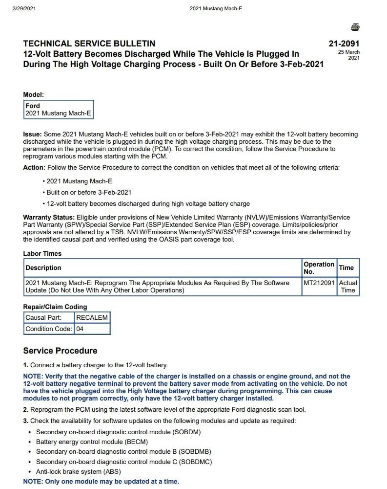

There is a bug with some cars that if you plug in, and have the car in accessory mode, the 12v system won't charge and will drain the battery within 45 minutes and you'll start getting all the alerts pop up as the voltage drops.
My dealer updated a few modules and this no longer happens, and the 12v system is being charged now as expected while plugged in to L2.

Thank for the replies. The confusion around this is why I asked the question. The 12V being depleted happen to me and I want to ensure it does not happen again. Maybe the SW fix is all I needed.

Did your dealer apply the software update to correct this issue when your MME was being serviced for the depleted 12V battery? If they did not, you should make sure that they do.

HuntingPudel,
The dealer did apply the TBS 21-12091 SW patch. No problems so far after 5 days. But you know makes you nervous.
