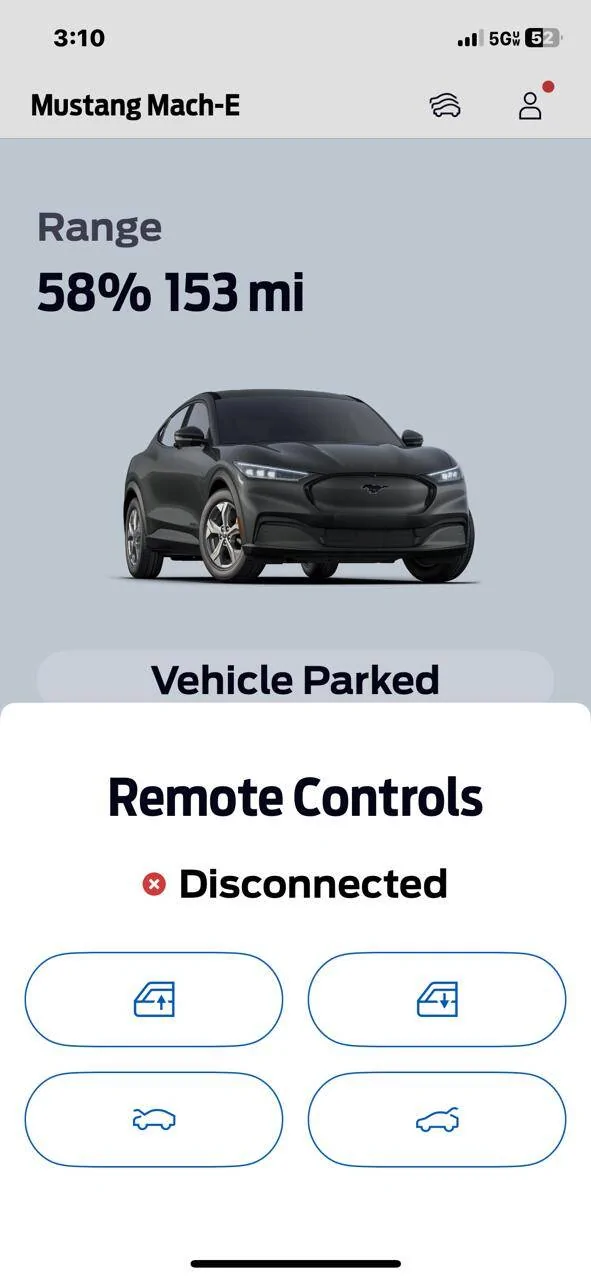

How to reconnect remote controls?

The photo (screen grab) came from while inside the car. Close enough?
Not sure those options work on Bluetooth anyway.
The windows, frunk release, and liftgate release in the FordPass app are all operated via Bluetooth. Being in range would indicate that there is a BT communications issue. Try force-quitting all apps, powering the phone off and back on, then re-opening the FP app. If that doesn't clear it up you might need to reestablish your link between the app and the car by deleting the car from the app and then adding it back in. ??

Did you accidentally disable Bluetooth on your phone?

Will try that
Thanks
Was no accident
Yes
Yesterday it simply wouldn’t connect
Started from scratch
