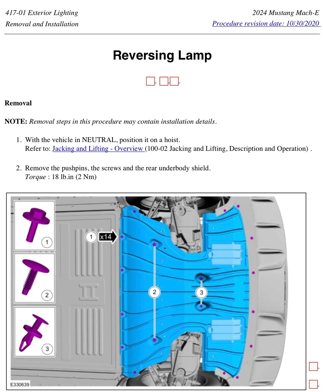

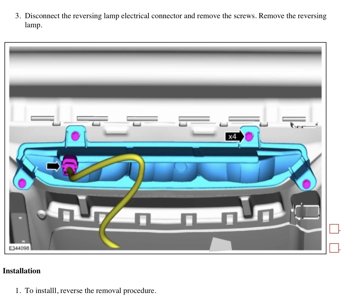

Does anyone have the manual or process of removing the reverse light? I need to replace it. Thank you.

Yes, this is from a Ford repair manual.
