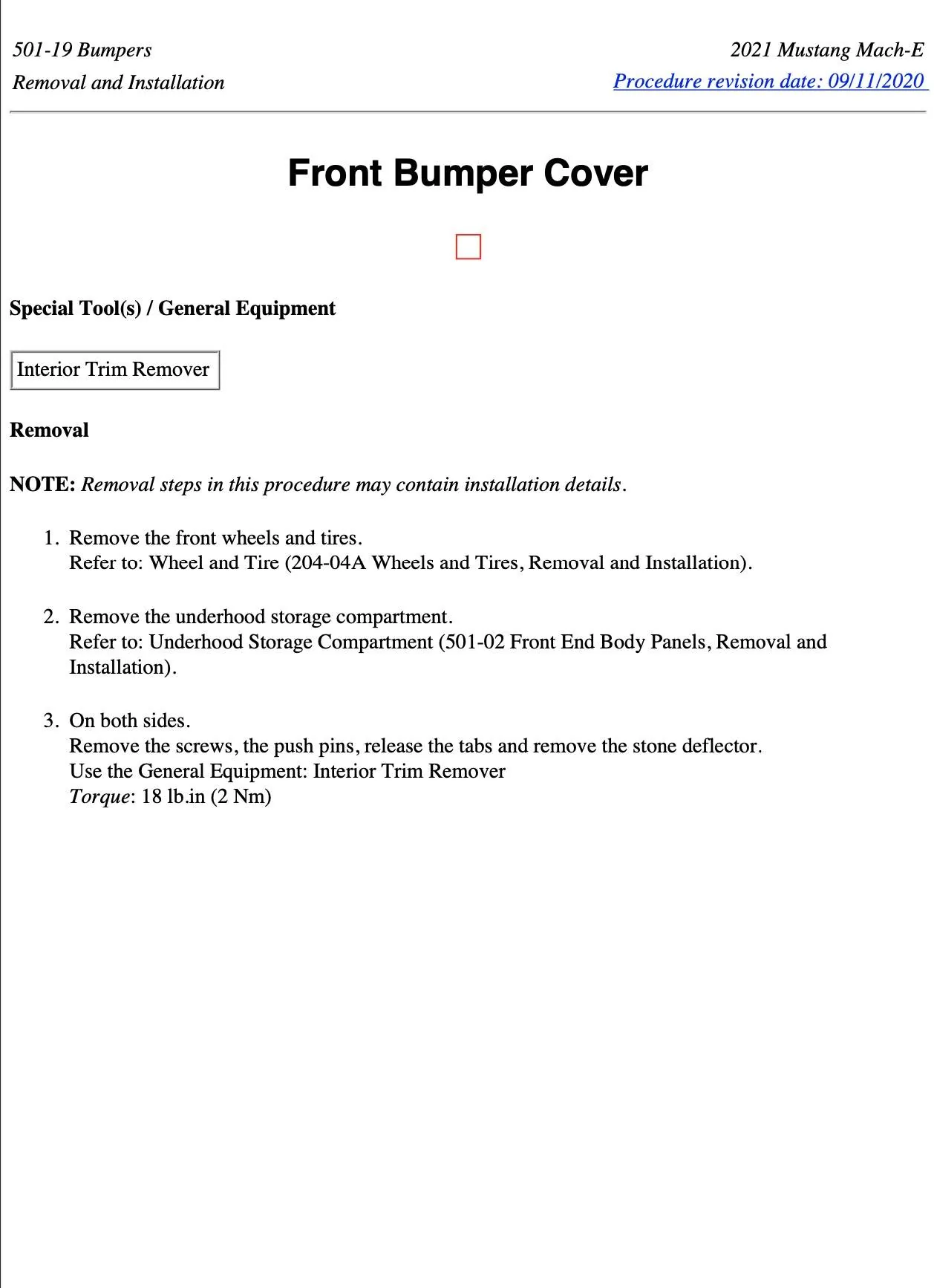

I need to remove the headlights for ppf install. I searched around on Google but found nothing for removing just the headlights.
anyone have a ford manual that shows how to remove them please ?

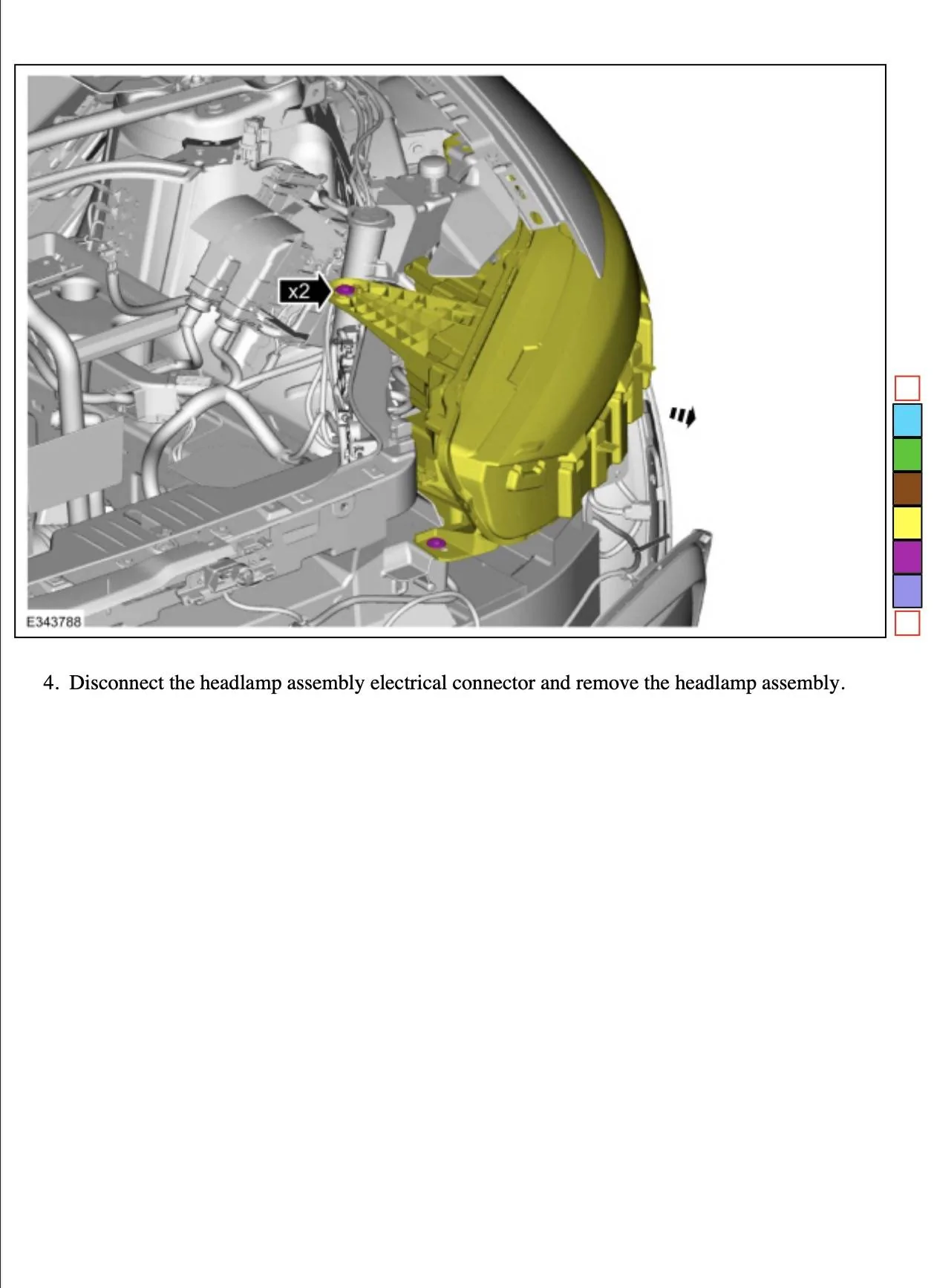

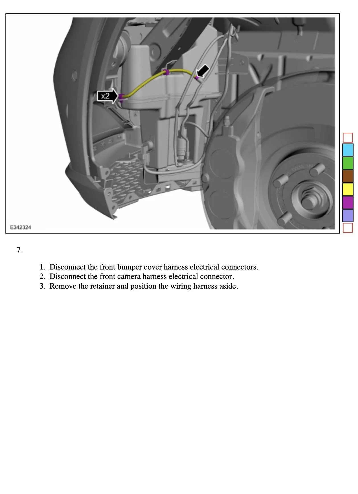

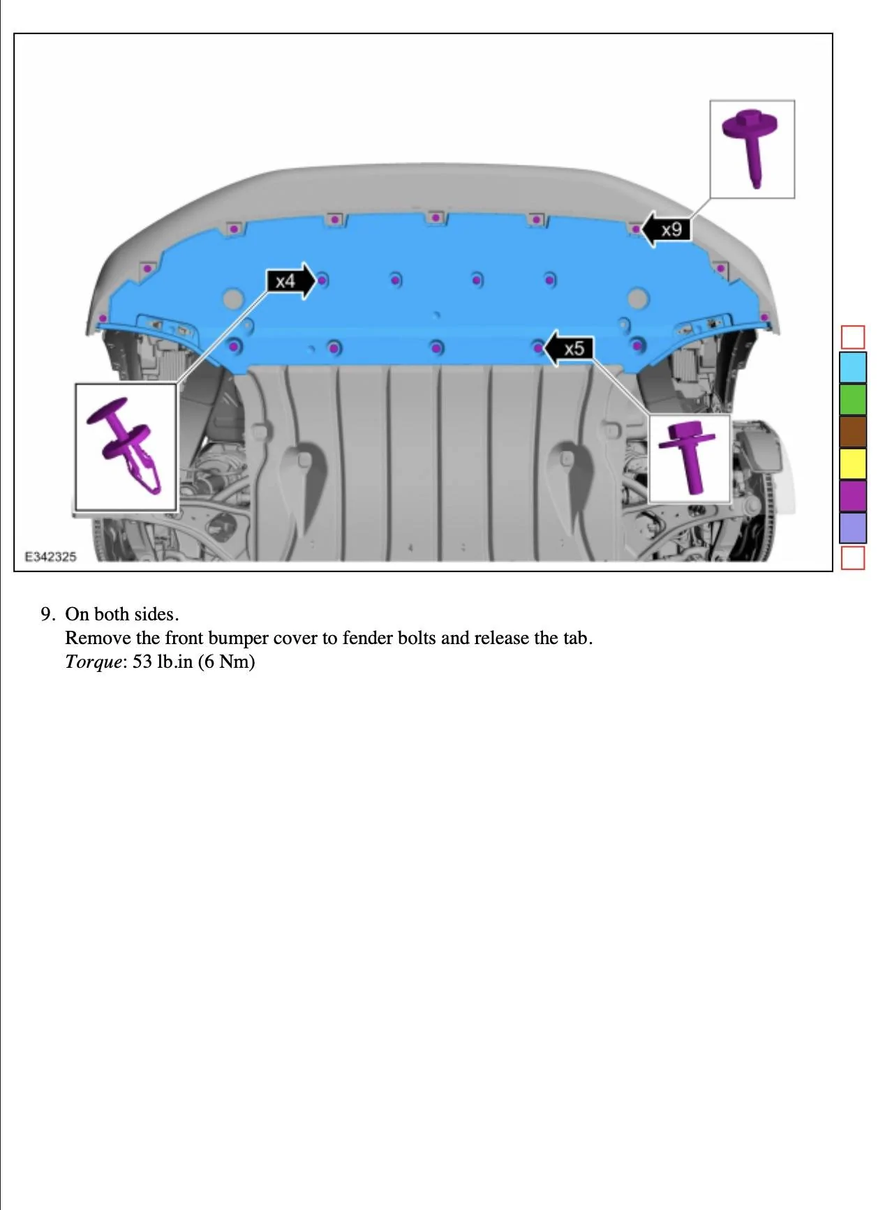

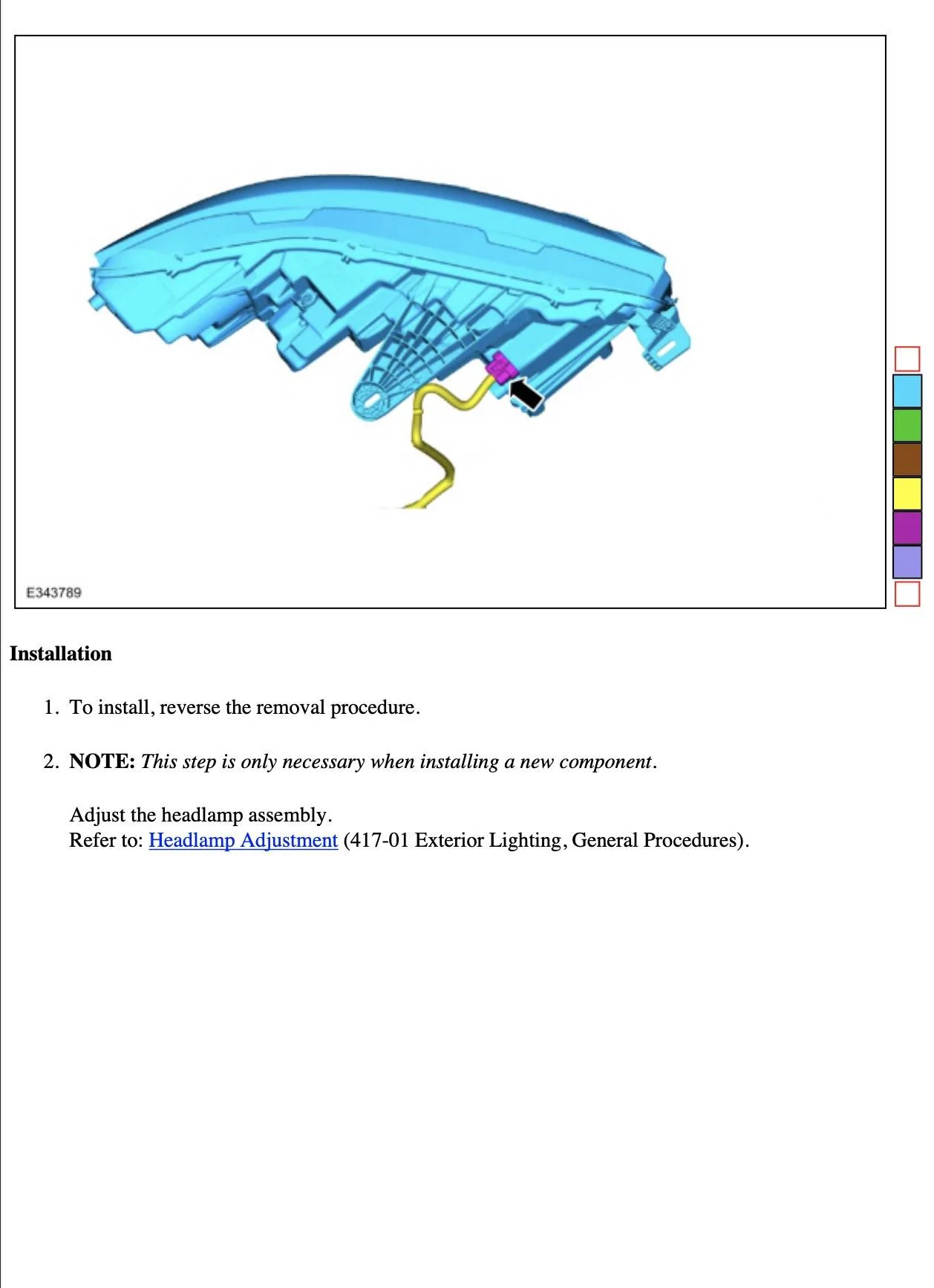

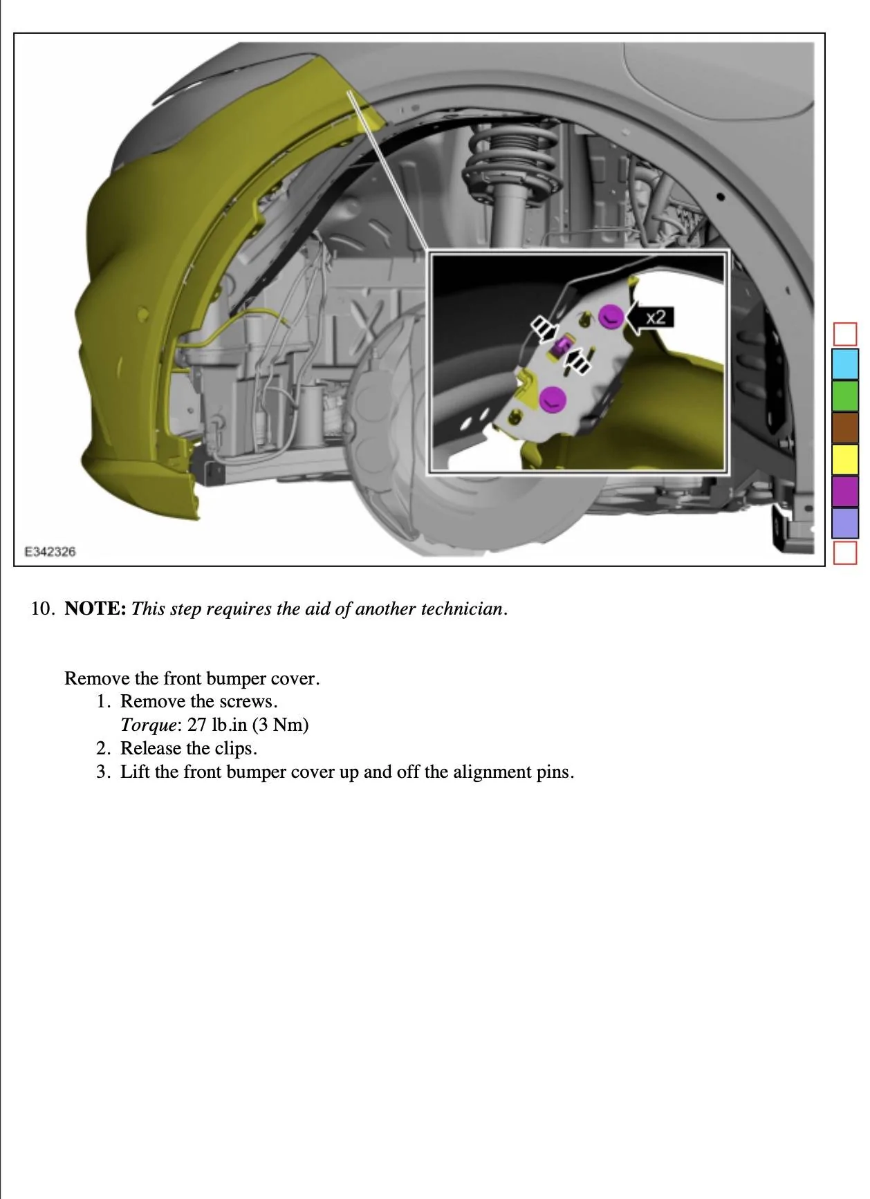

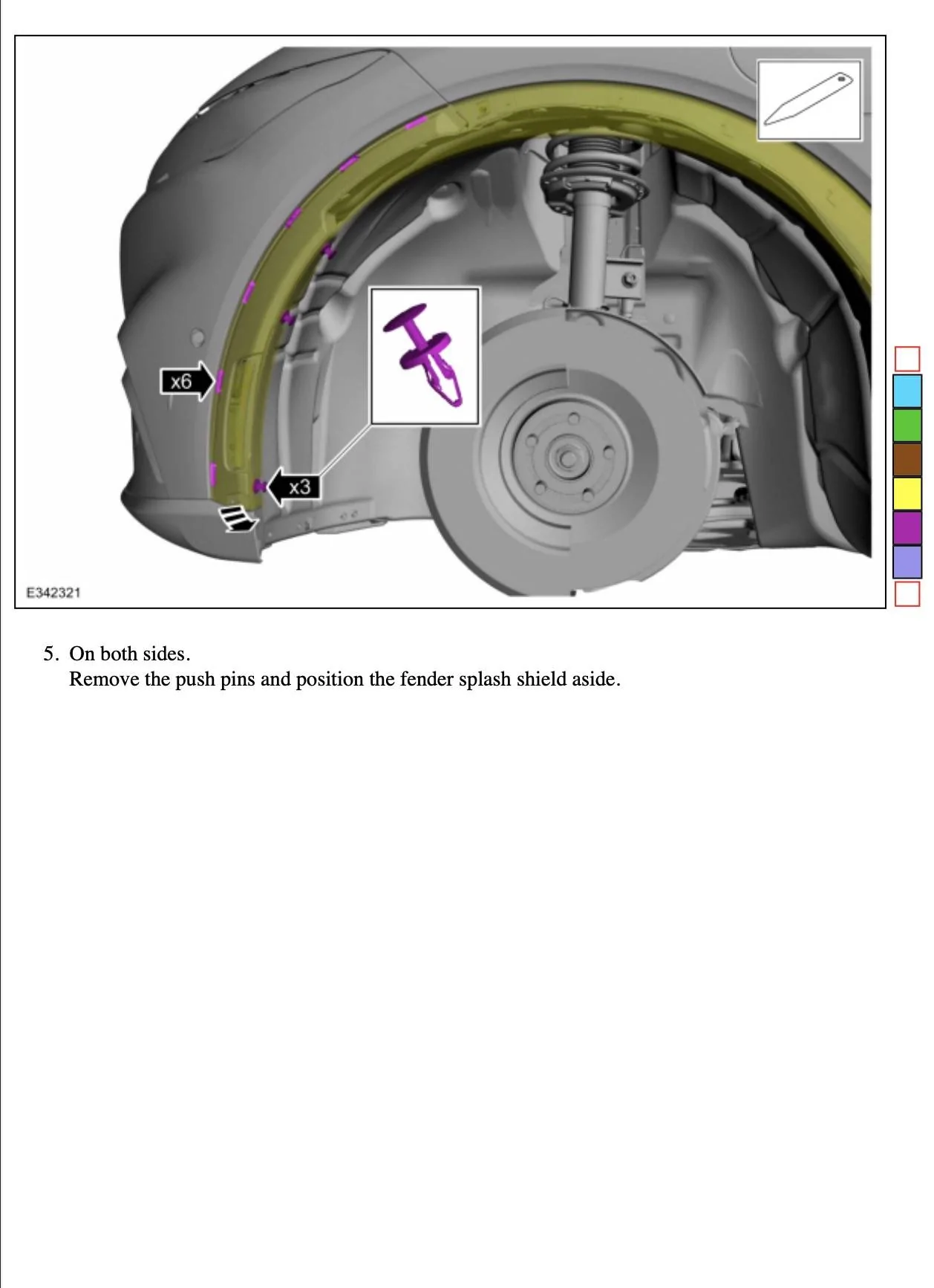

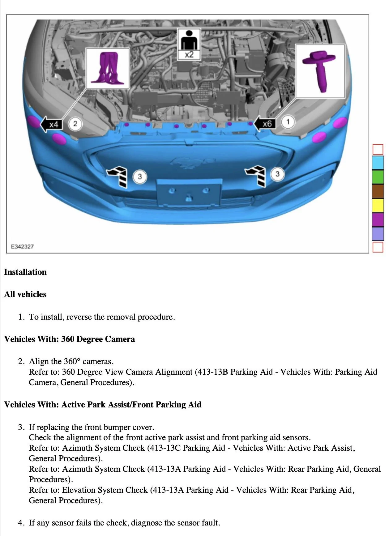

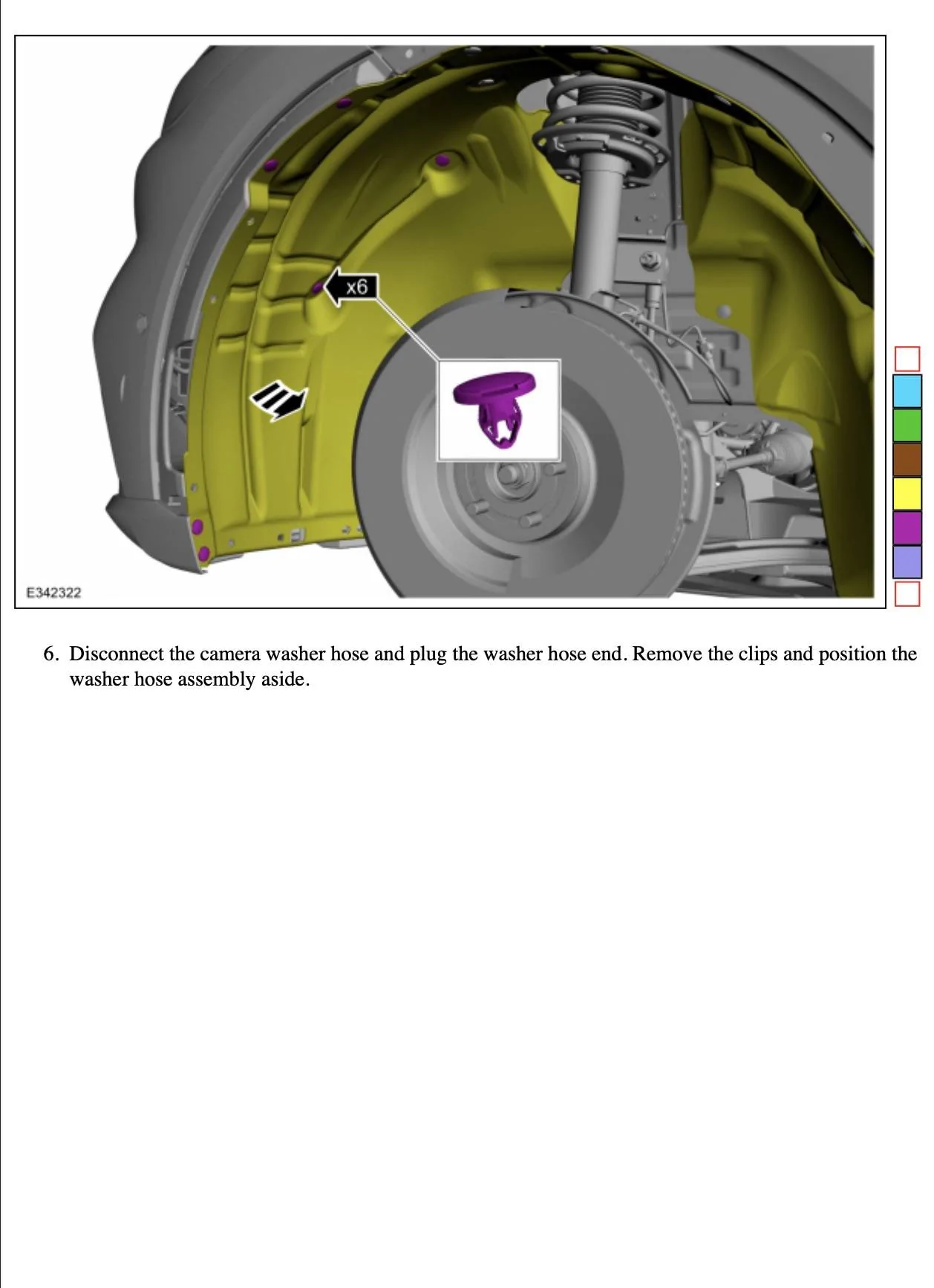

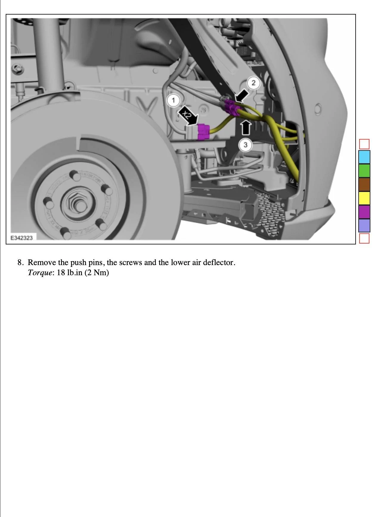

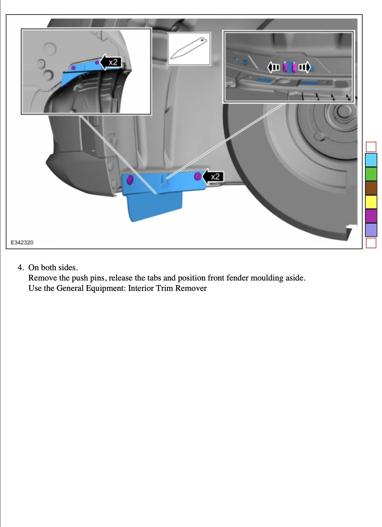

I agree with Lee, in that it shouldn't have to be done but if you want to.....
From the repair manual and you need to remove the bumper cover.
Ford Mustang Mach-E How to remove headlights ? Screenshot 2023-01-29 at 11.03.52 PM
Ford Mustang Mach-E How to remove headlights ? Screenshot 2023-01-29 at 11.04.11 PM
Ford Mustang Mach-E How to remove headlights ? Screenshot 2023-01-29 at 11.04.25 PM
Ford Mustang Mach-E How to remove headlights ? Screenshot 2023-01-29 at 11.04.42 PM
Ford Mustang Mach-E How to remove headlights ? Screenshot 2023-01-29 at 11.04.55 PM
Ford Mustang Mach-E How to remove headlights ? Screenshot 2023-01-29 at 11.05.04 PM

Yes the Mach-E headlamps are one sealed unit. All bulbs are LED and non-replaceable. There is an LED control module that is replaceable within the unit but the headlamp assembly must be removed to replace it.
As an example, the part number for the right headlamp on a Select with standard LED lighting is LJ8Z-13008-B and a left headlamp on a Premium and GT with projector LED lighting is LJ8Z-13008-J. Both retail for about $1600 at your Ford dealer, however you can get them online at many discount dealers (I use Tascaparts) for about $1100. On e-Bay they go for around $500 used. For those who plan on keeping their cars longer than the 3 year bumper to bumper warranty, it might be a good idea to purchase an extended warranty.

where did you find this diagram?
Snakebitten
Mar 1, 2024
2,281
3,822
Coastal Texas
2023.5 Mach-E
That would be Ford's Factory Service Manual.
You can access the documentation using temporary license for PTS access. (~$26 for 72 hours)
Or you can purchase outright the whole manual from various online vendors.
