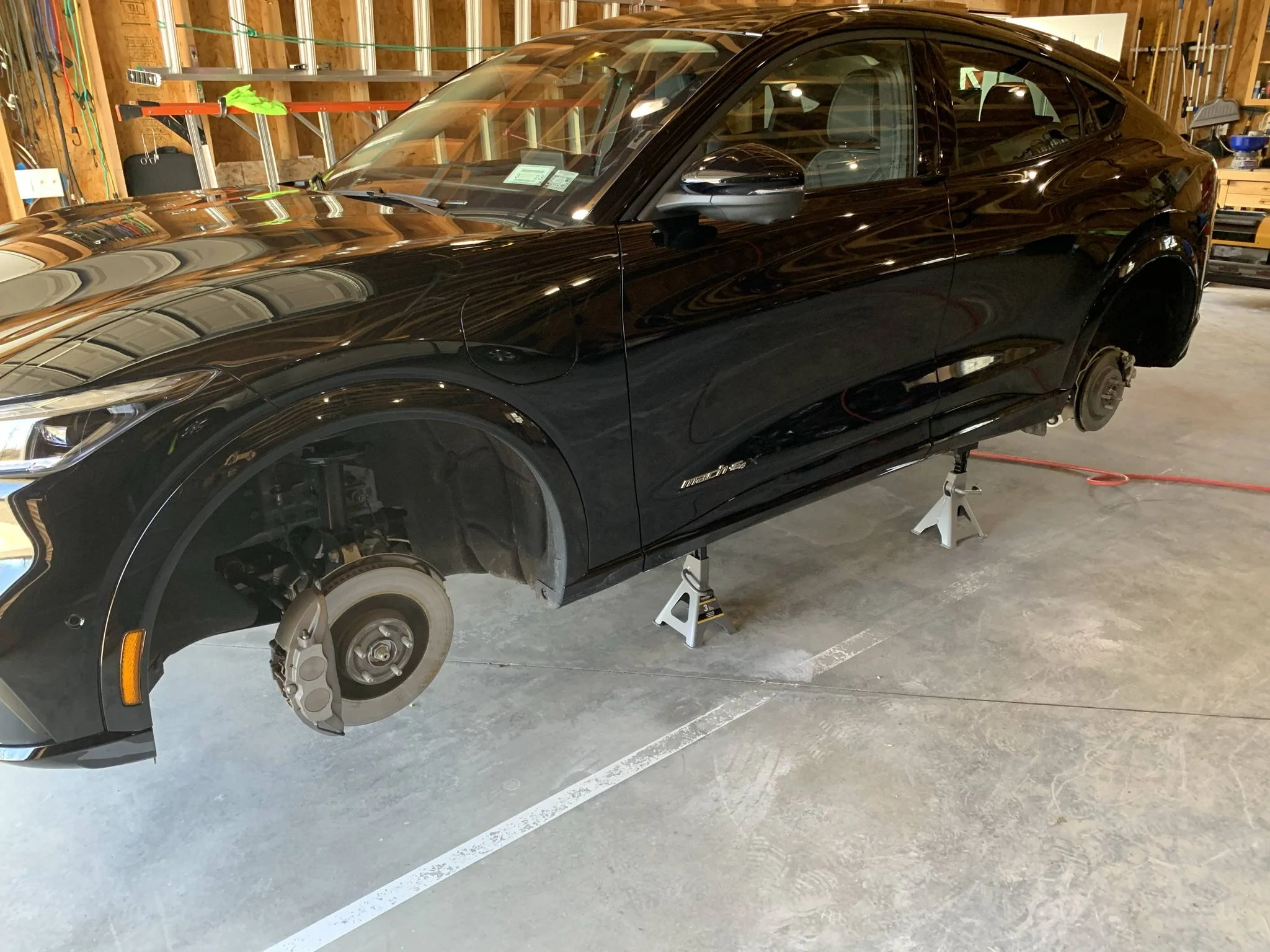

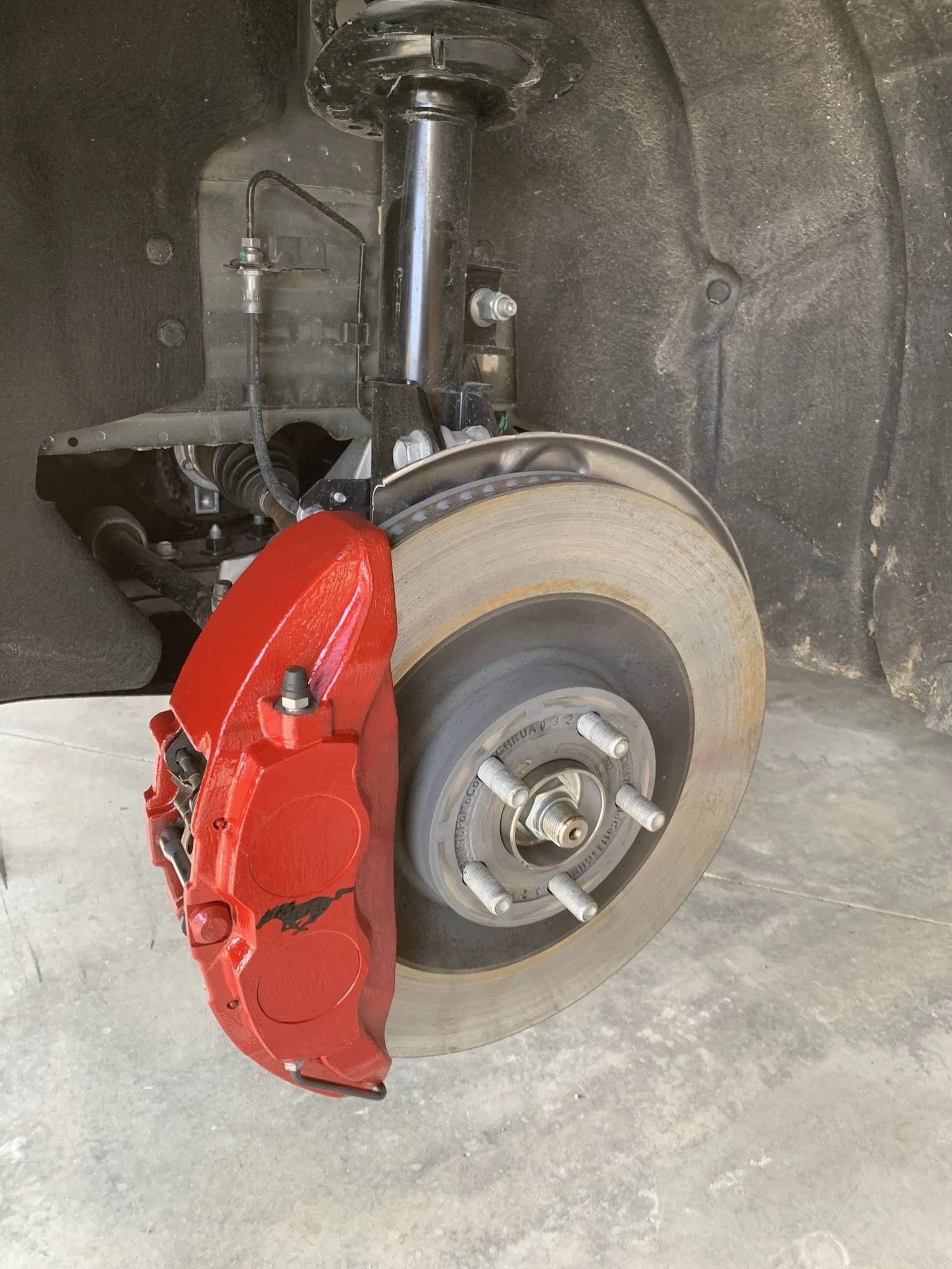

jacked mine up
Ford Mustang Mach-E I need caliper covers for the mach e brakes 065A4E68-5D2F-485D-954C-4CC084F5FDE9

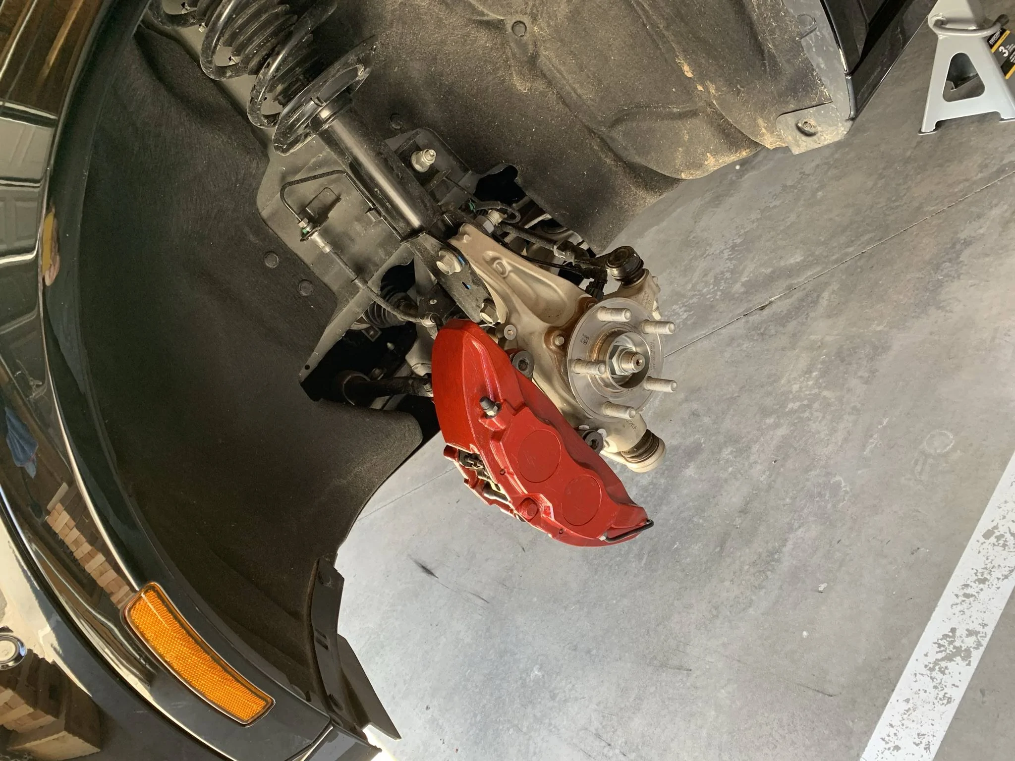

pulled the rotors and remounted the calipers. Just to get the rotors out of the way and make the job a little easier. Did this without taking the brake lines loose so I didn’t drain the system. Didn’t have to mess with FDRS. You do need to put it in brake service mode if you do this.
Ford Mustang Mach-E I need caliper covers for the mach e brakes 0B7D2D4A-6570-46DC-9CA3-55797A167CC8
When all done.

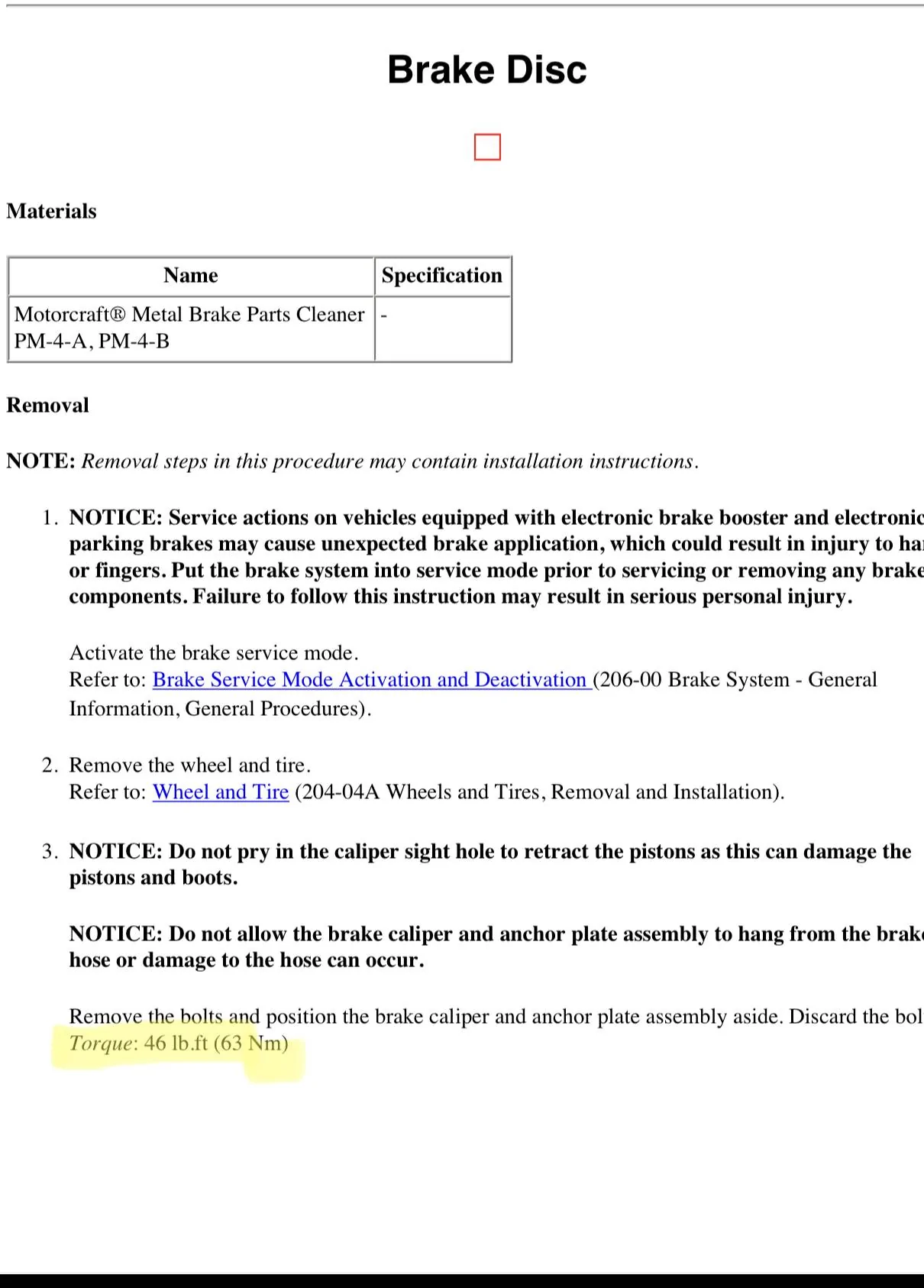

Ok, I've decided this is the weekend I paint my calipers to match the pinstripe I put on the car. A sort of burgundy/merlot color from G2. Car is on stands, in brake service mode (thanks @Murse-In-Airy ) wheels/rotors off and calipers loosely remounted with pads retracted. Everything is cleaned and ready for paint. Does anyone know what torque the front and rear caliper bolts take for when I'm ready to reassemble in a few hours? Or is the 'ole good-n-tight method?

Thank you. Can you verify this is for the front and back calipers both? They are different bolt sizes.

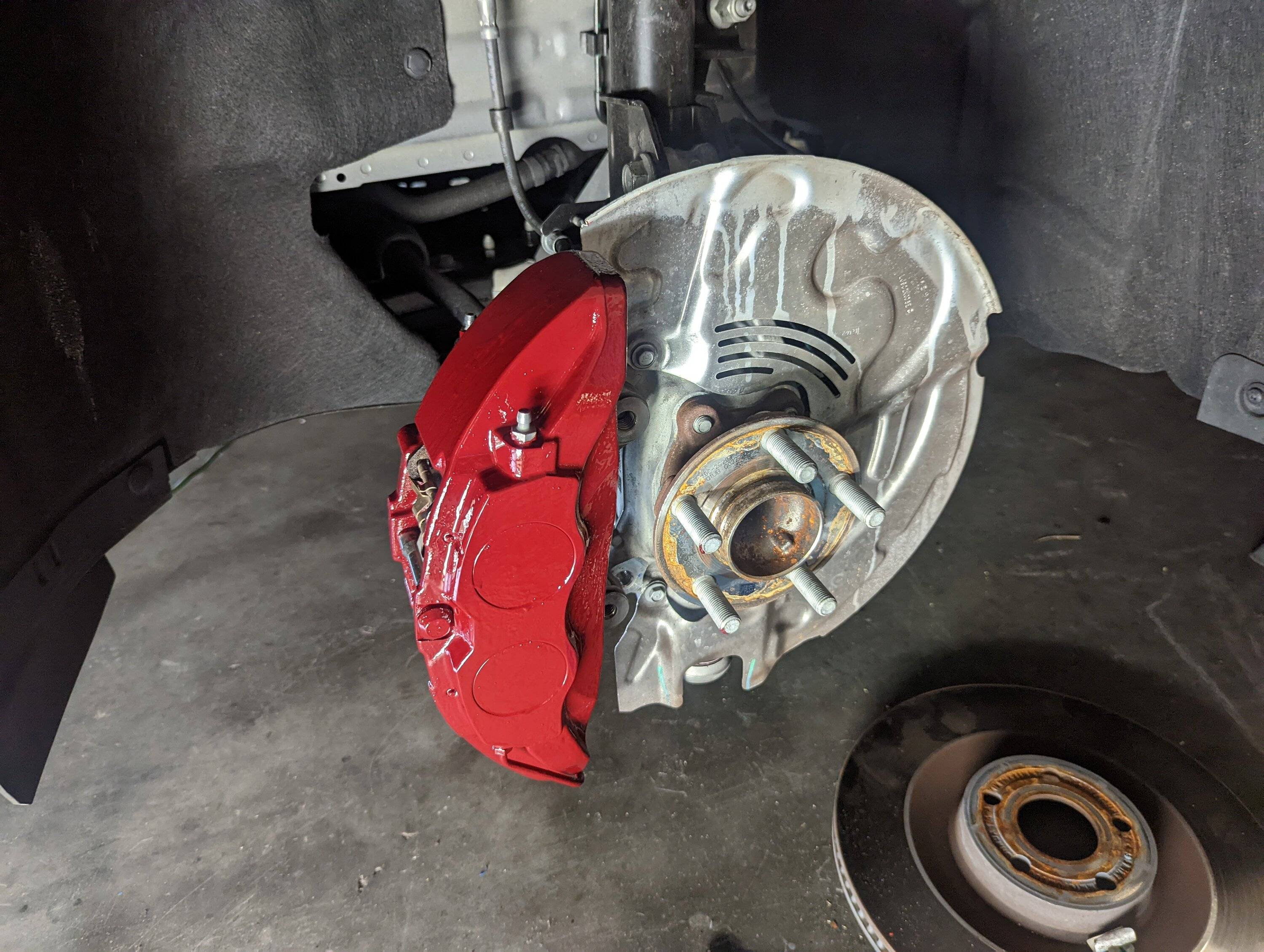

Paint is on, just watching it dry now.......
