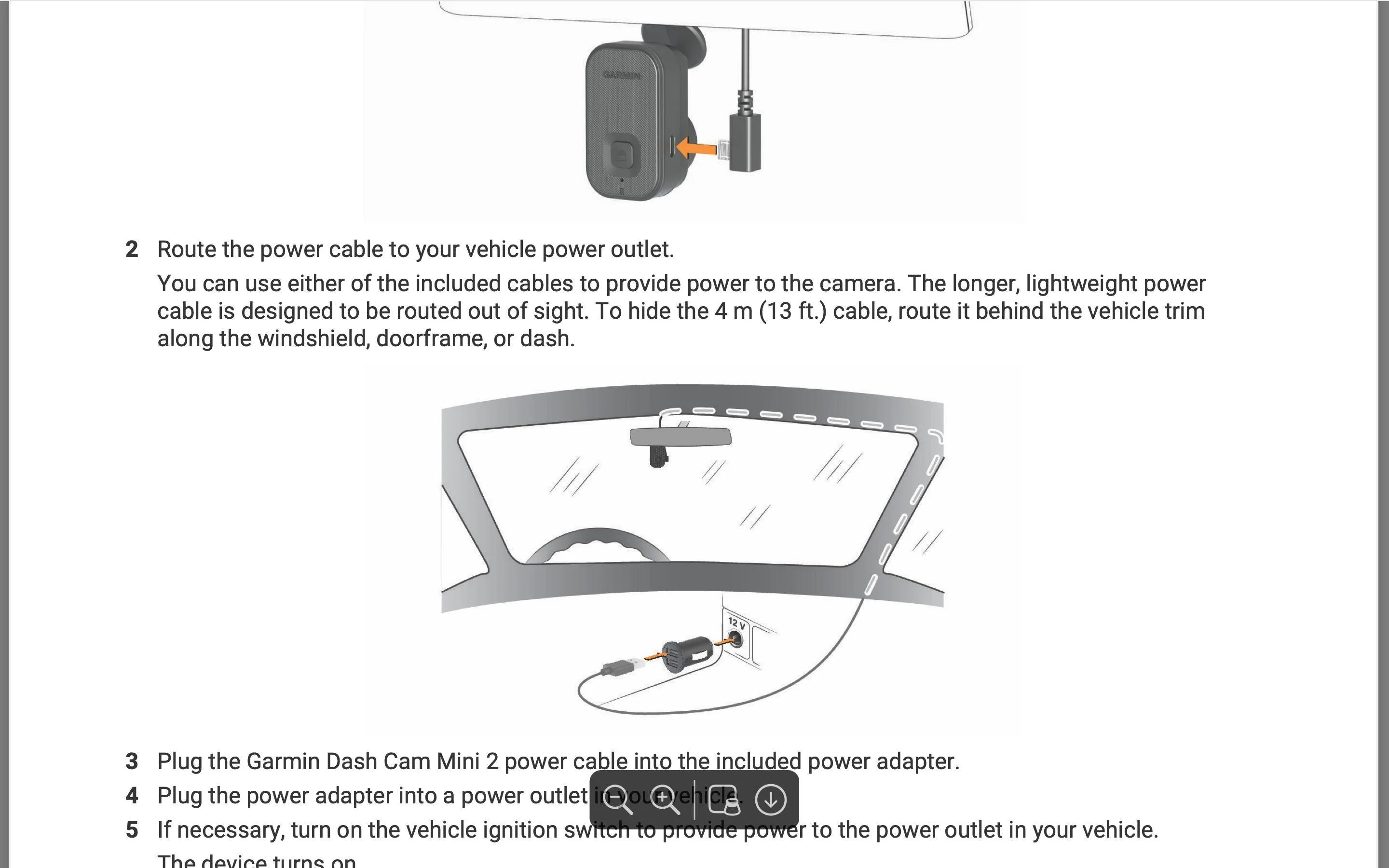

Hi All,
I’m thinking of buying a Garmin dash camera and wondering if anyone has done this. It comes with a 13-foot cord, and the illustration shows this:
Ford Mustang Mach-E Install dash cam anyone? Screenshot 2024-01-01 at 11.57.26 AM
Has anyone done this? Is it doable/difficult to hide the cord along the windshield and on down?
Thanks, and Happy New Year y’all!
—Mark

lots of people have done it including myself. i ended up not taking off the pillar trim and just routing it through the rubber seal, works fine been 2 years

This is the best way to route the wire for the rear camera. Remove the weather strip for the door and route the wire behind it.
I powered mine from the mirror power wire, that’s before the adapter came out.

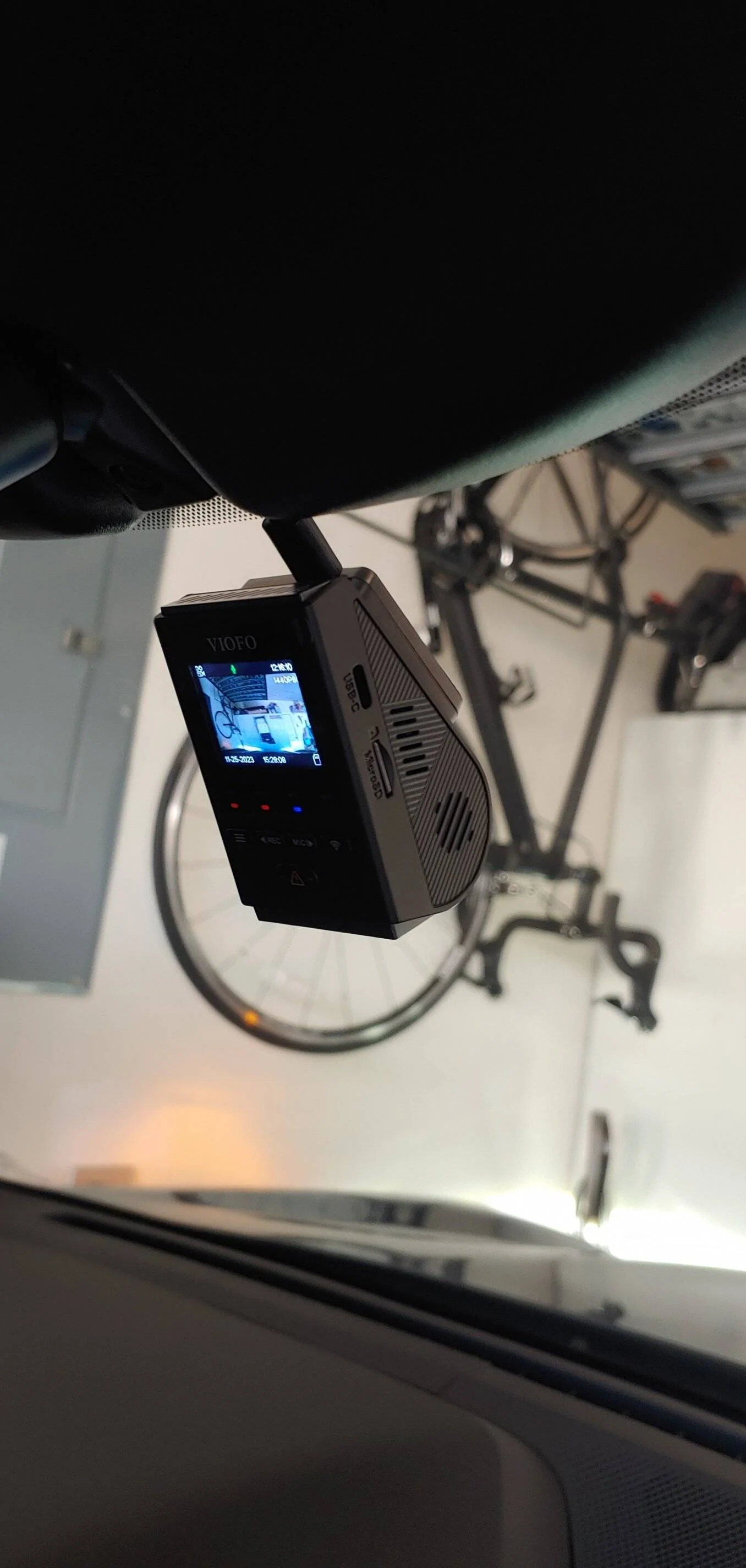

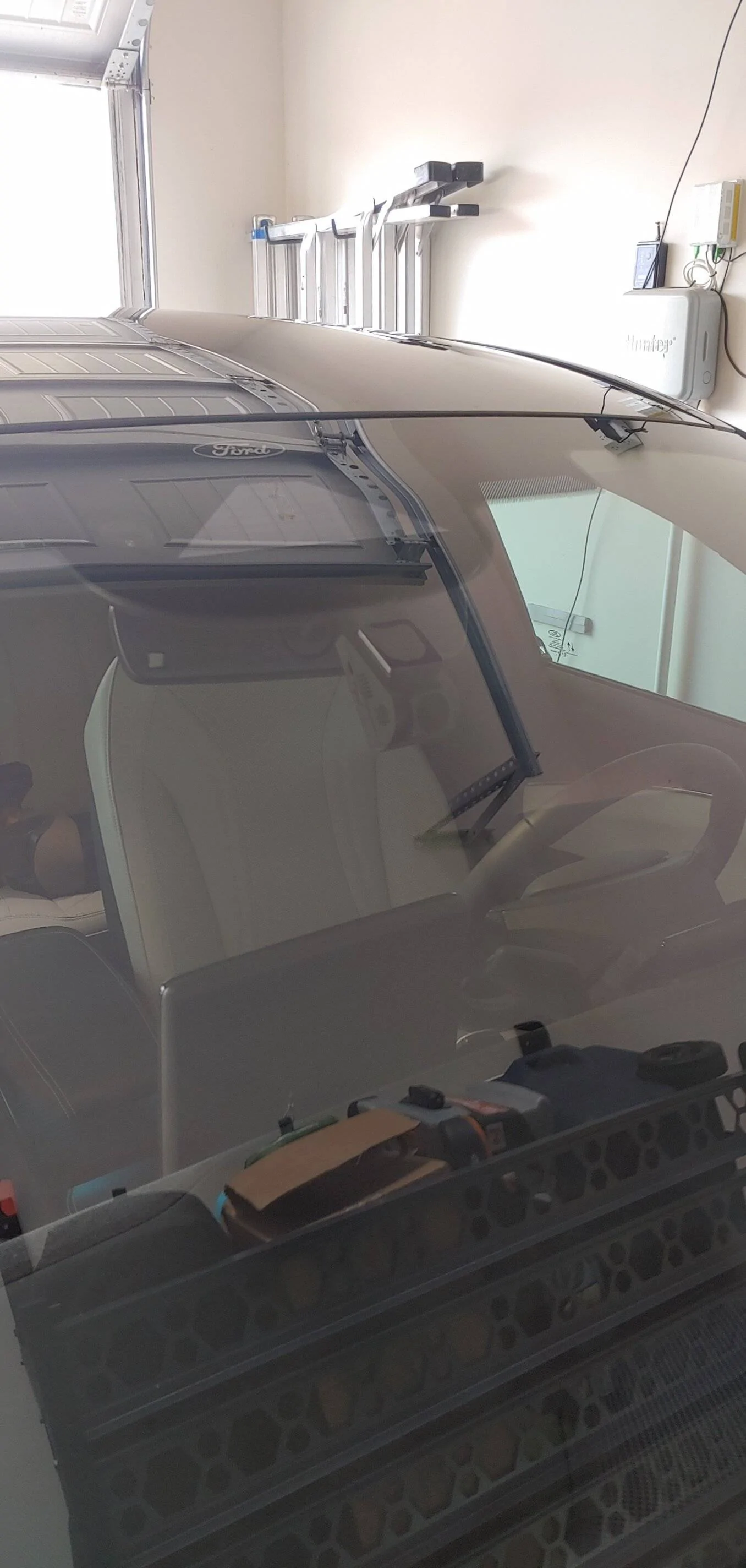

Does the unit come with everything you need to power the camera? Where did you hook it up for power?
Yes, it comes with a USB cable/12V adapter. I purchased the optional Dongar adapter mentioned earlier for better concealment.
