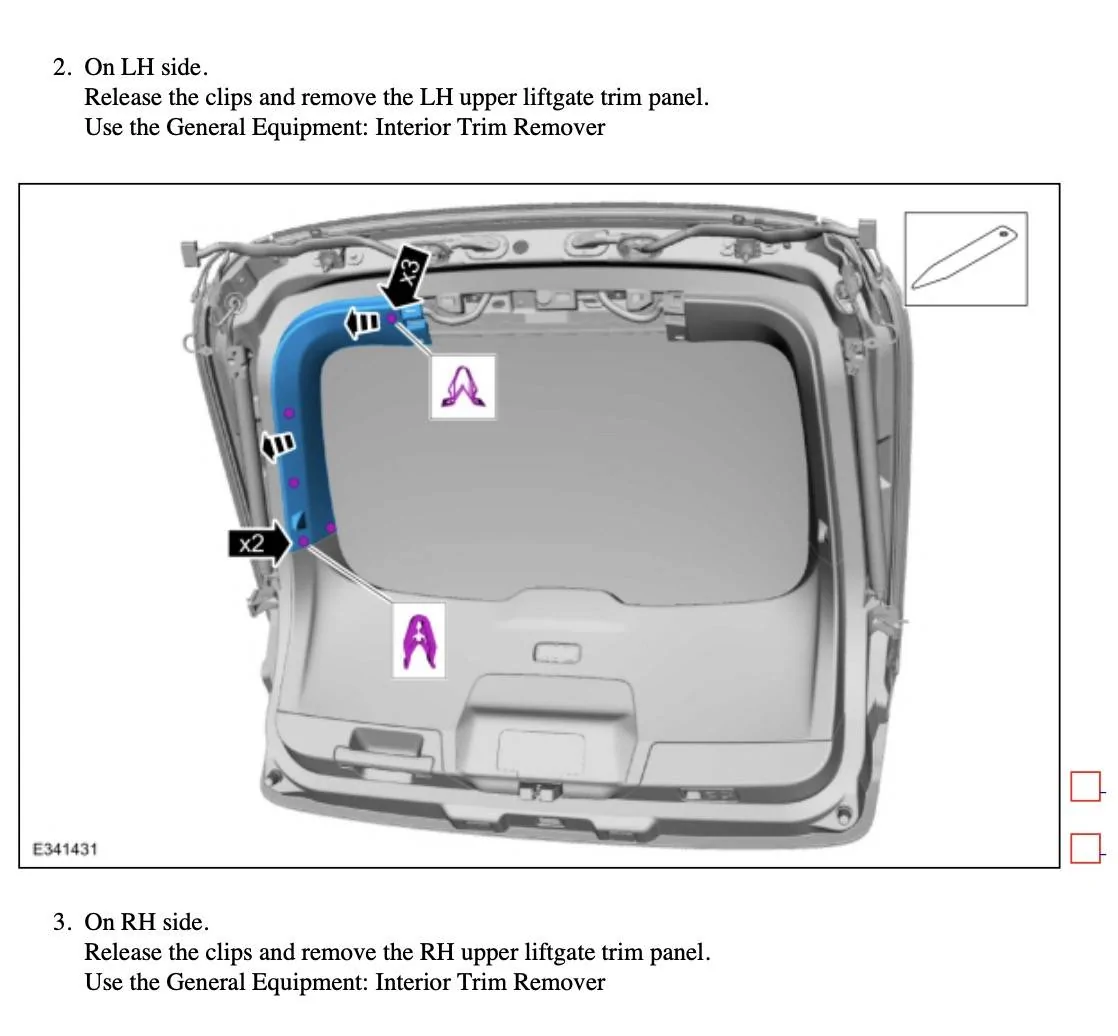

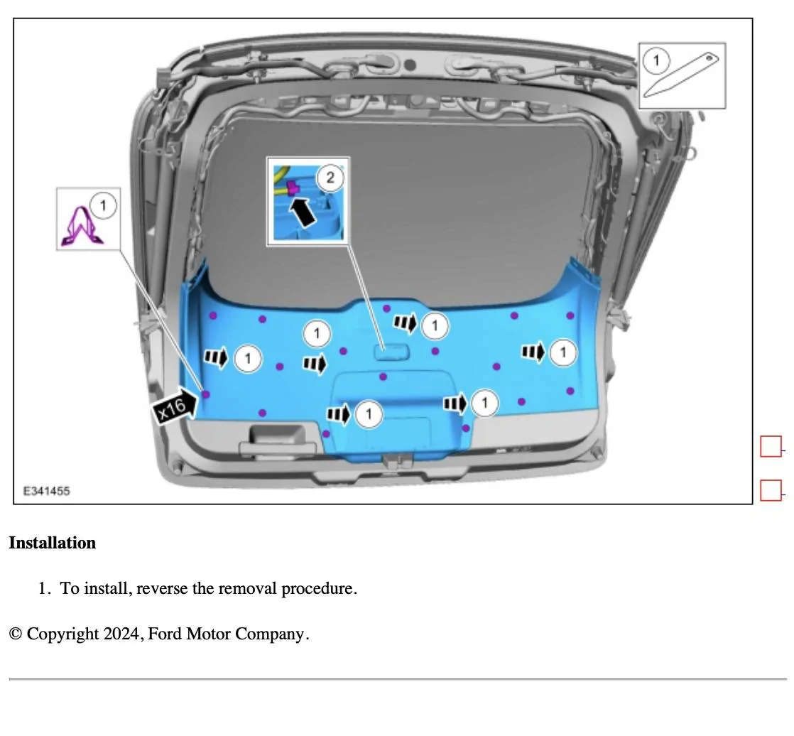

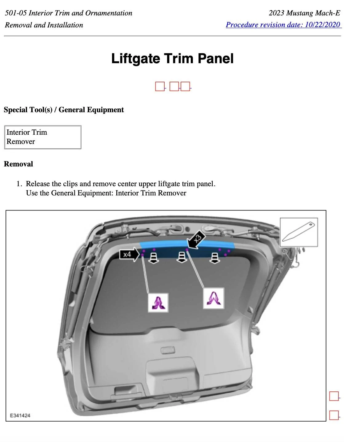

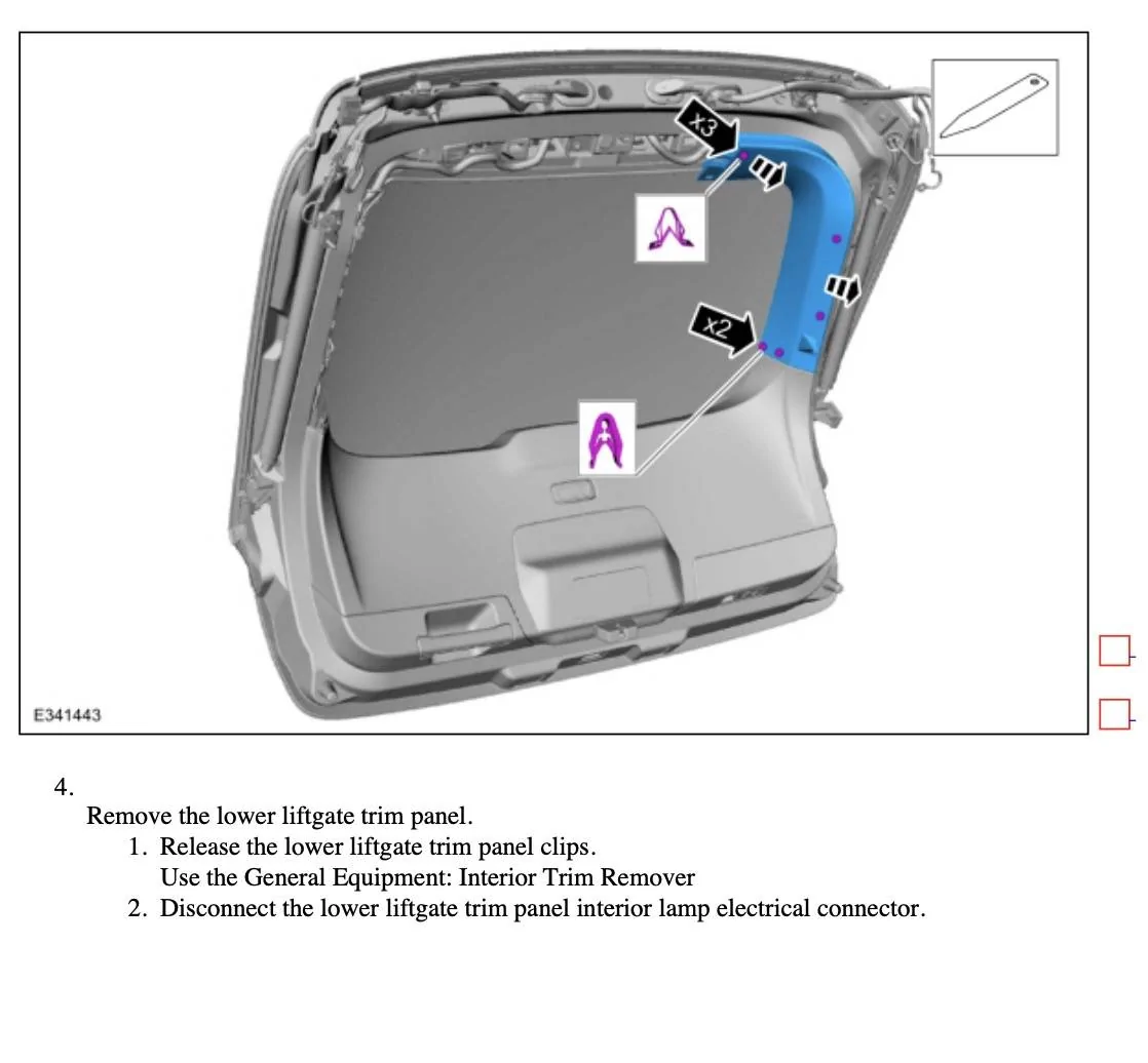

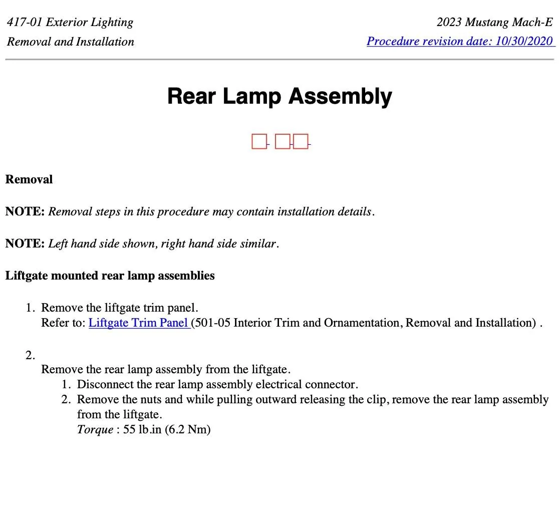

Was abt to add this vid. Did the same install.The panels in step 2 and step 3 are a challenge, I had to do all of those panels to install my LED GT badge from EV Vida. This video shows removing those panels Mustang Mach-E Mods | Light Up Emblem DIY | In-Depth Demo (youtube.com)
