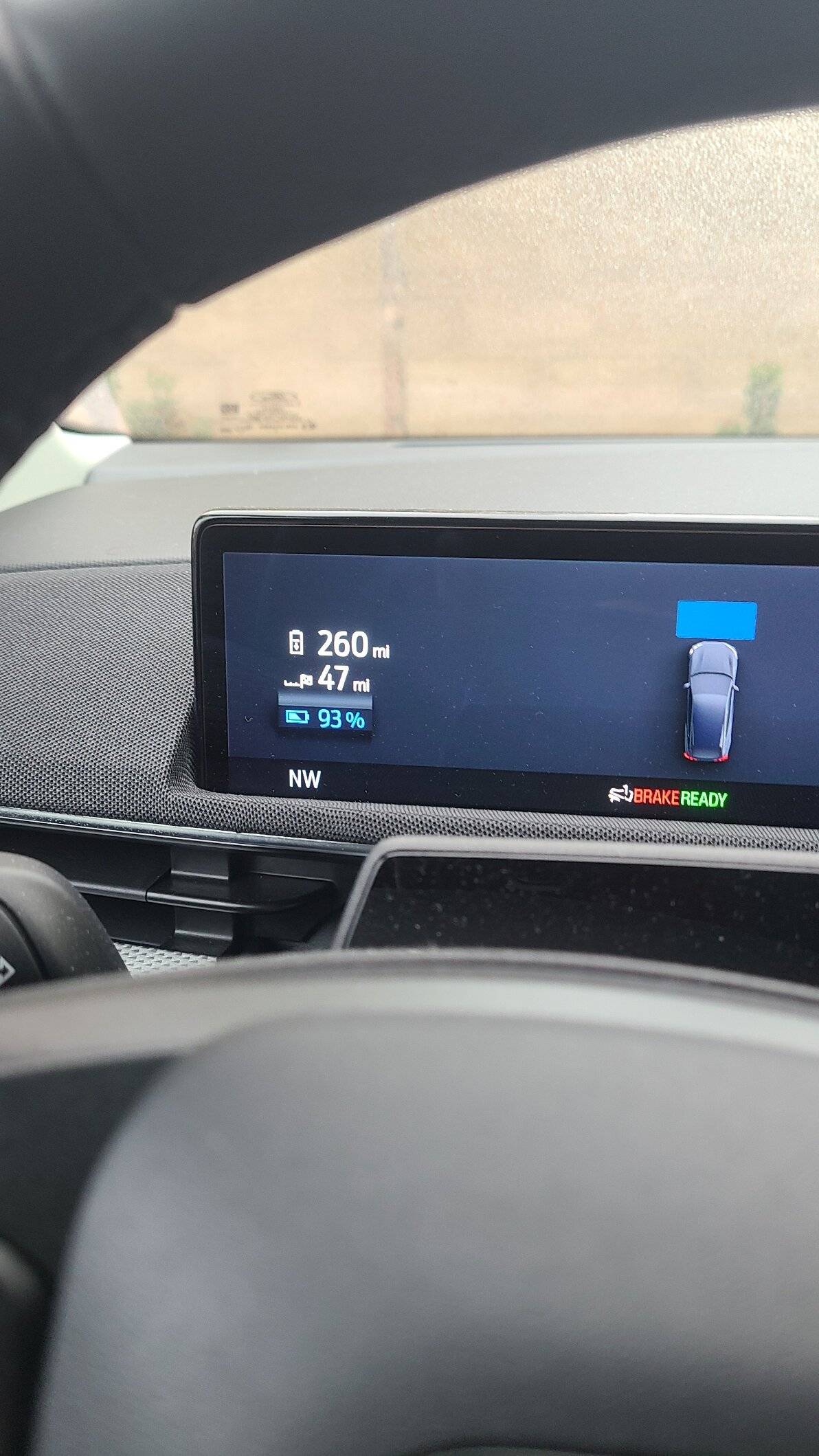

Hello All, Merry Christmas.
Went to the store this morning for the wife, needed eggs for cookies =)
Anyways I noticed an indicator I haven't seen before and cannot find in the owner's manual or google search.
Hoping you all could help me out.
The little battery symbol to the left of the range with the arrow pointing down?
Also, I don't have any destinations or charging saved in my navigation but the flag with the remaining mileage is showing.
How do I get rid of that?
Thanks in advance for your help.

That symbol is intended to help communicate the top number is estimated range to empty. The lower symbol is intended to communicate the lower number is distance to destination.
Several cars experience this glitch from time to time but we usually see 1 mile to destination instead of 47. ???
At any rate.....program a destination and then cancel it and the display will return to normal.

Thank you. I will try that.
