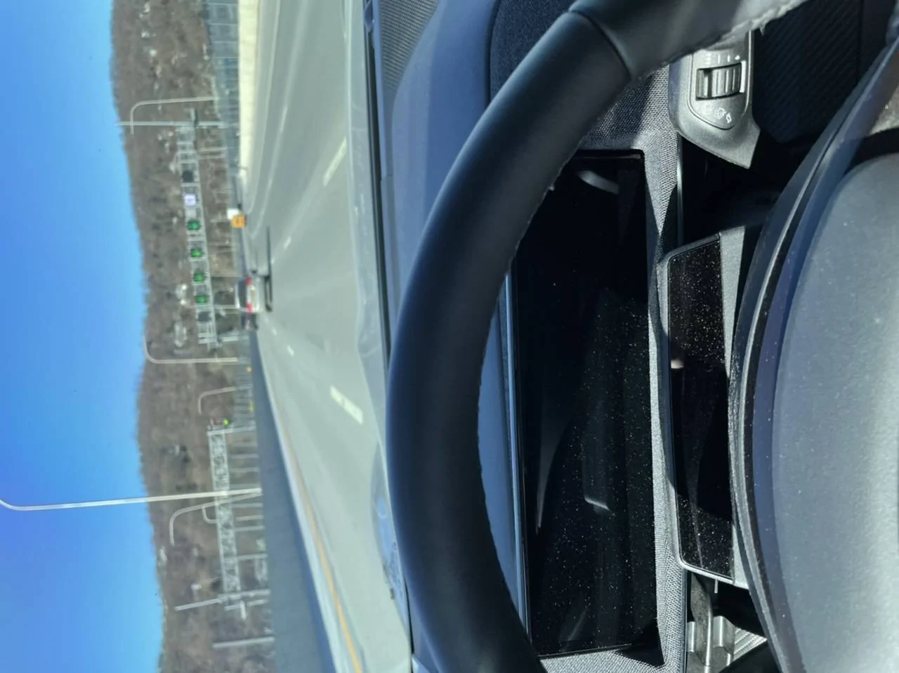

Ford Mustang Mach-E Instrument Cluster-BLACK 1F93C85F-4405-4B3C-A25B-175D422C2704
Happens a lot for me. Every time it happens I just wait it out. Leave the car off for like an hour or two it’ll come back half the time. On other occasions I have had it come back after a full day.
I went to the dealer and they even saw it but there’s nothing they can do as they told me there are no codes. Lol.

Out of curiosity, still going on? I've had my Mach-E for about one month and just today the instrument cluster seemingly would go off at random. I first noticed it when the car started up, it seemed to be fine but then it would cut out for seconds to minutes at a time, seemed to get worse as we went. When I got home and looked it up I did try the reset that people mentioned here, but also as mentioned, that only reboots the main screen in the middle of the vehicle; it doesn't impact the instrument cluster.
Not reassuring to hear that even taking it in for service might have no effect. At this point I'm hoping that the car being off for 12 hours will fix it and that I'll never have the black screen again, that maybe it was just a software glitch, but...
