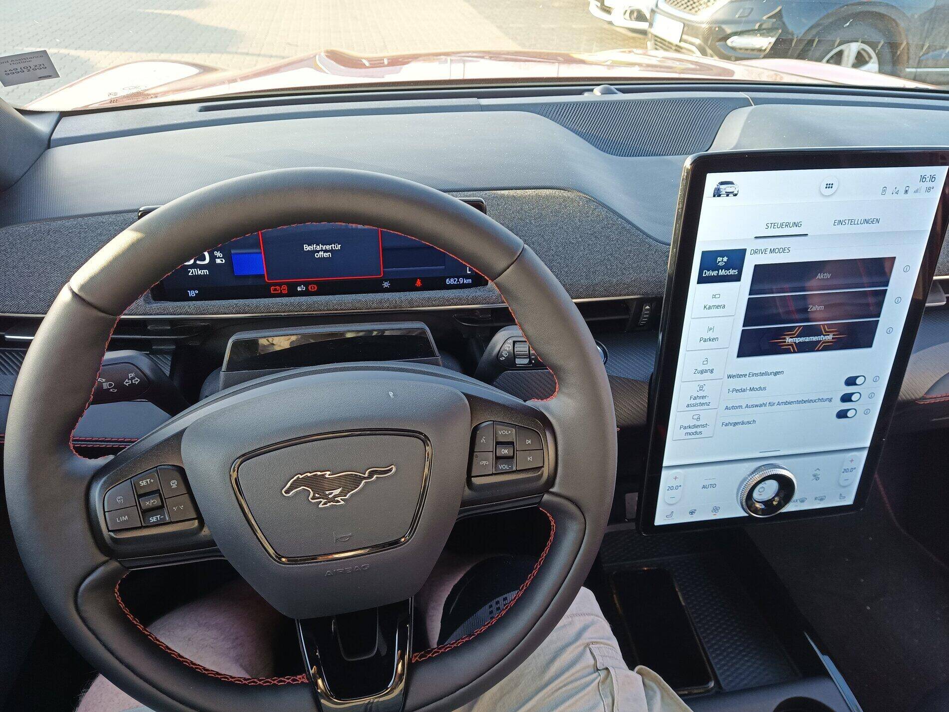

Ford Mustang Mach-E Instrument Panel Air Vents issue? (FIXED) 1614277811300
By the way, for those wondering where to find the shutoff wheel for the center registers, the driver-side center shutoff wheel is shown in this photo (stolen from the German owners thread), just to the left of the touchscreen. The passenger-side center register has a shutoff wheel just to the right of the touchscreen.
