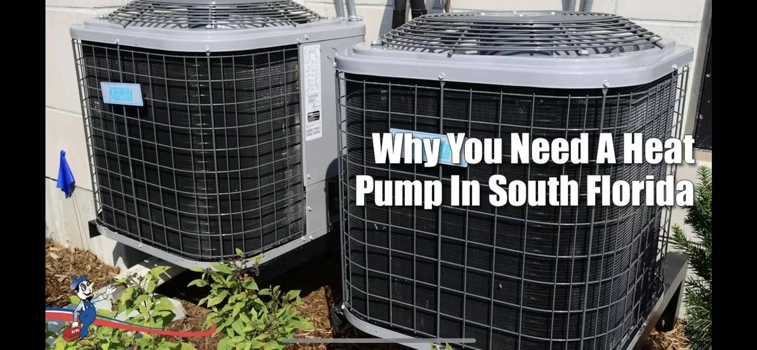

Lol yeah, I wouldn’t expect his heat pump to look or work anything like mine.
Mine looks like this and is just outside above ground-

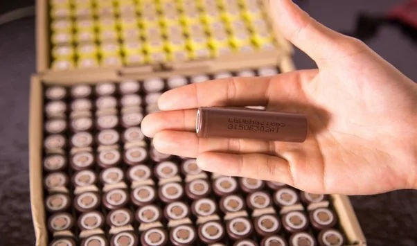

Flawed for sure, but one thing I learned (and makes me feel kinda dumb) is that our battery packs are basically thousands of AA batteries!
In my mind they were larger cells and looked nothing like something I put in my TV remote.

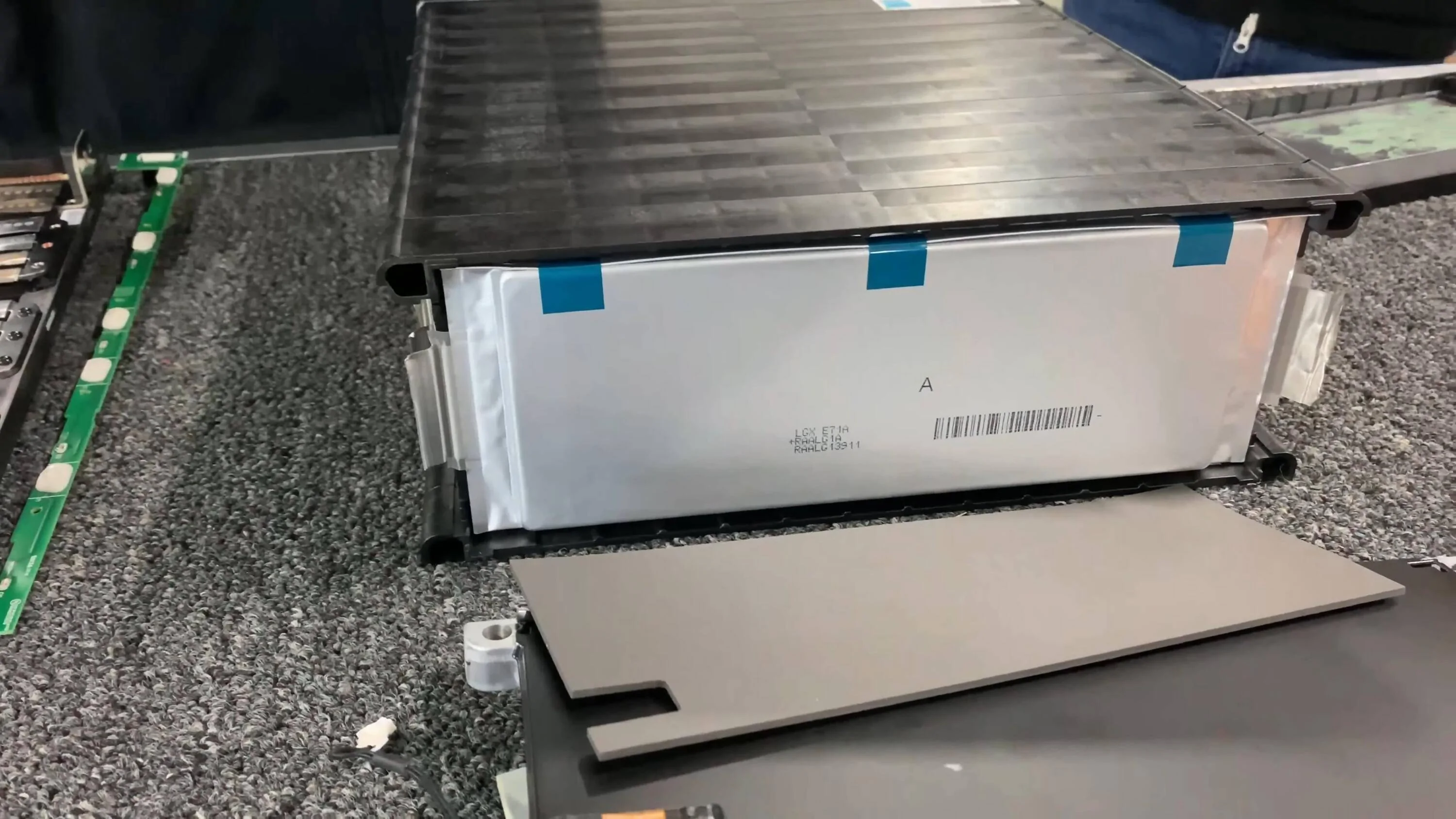

Mach-E batteries are actually pouch cells, not individual cylindrical cells like Tesla:
