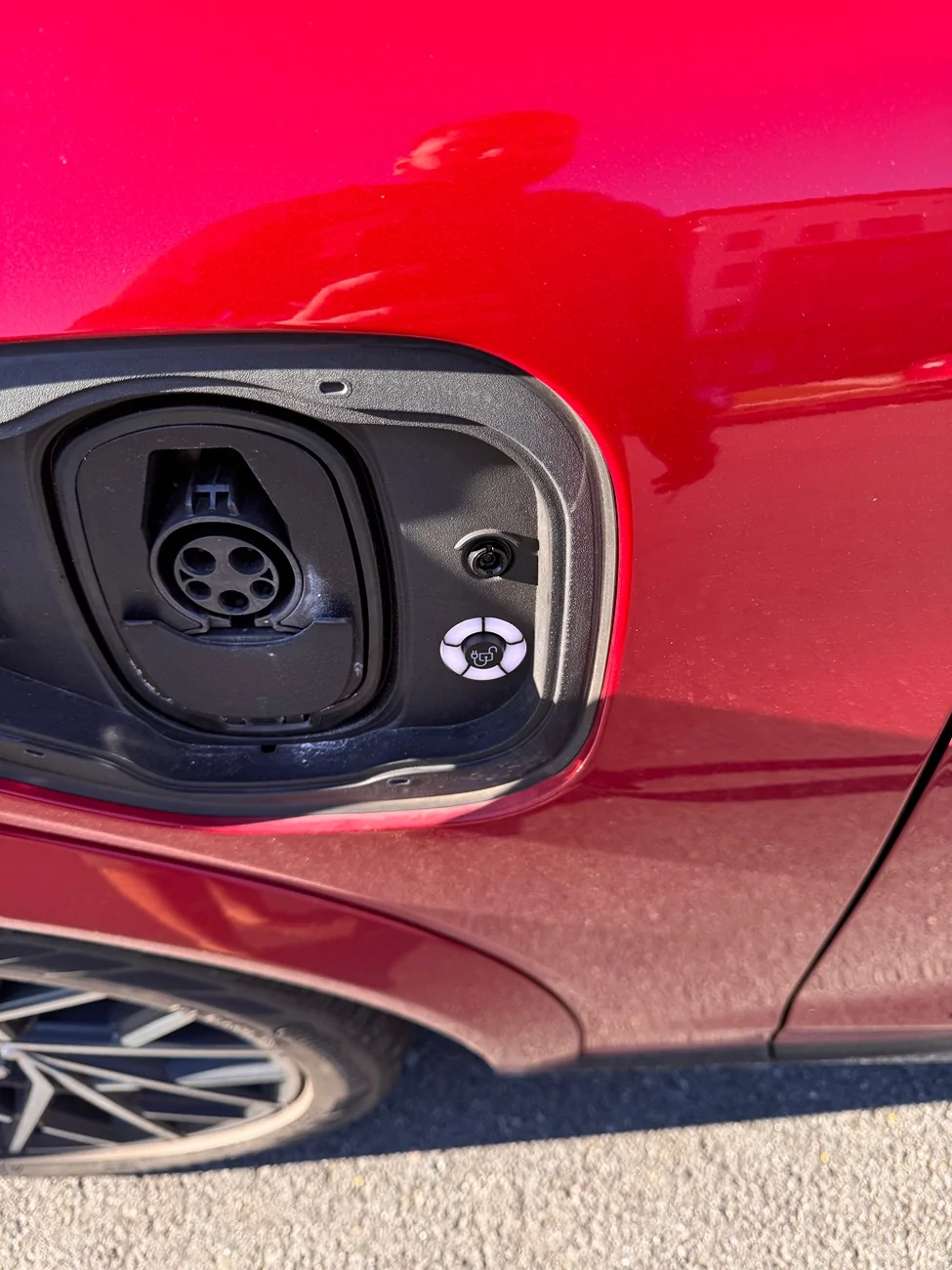

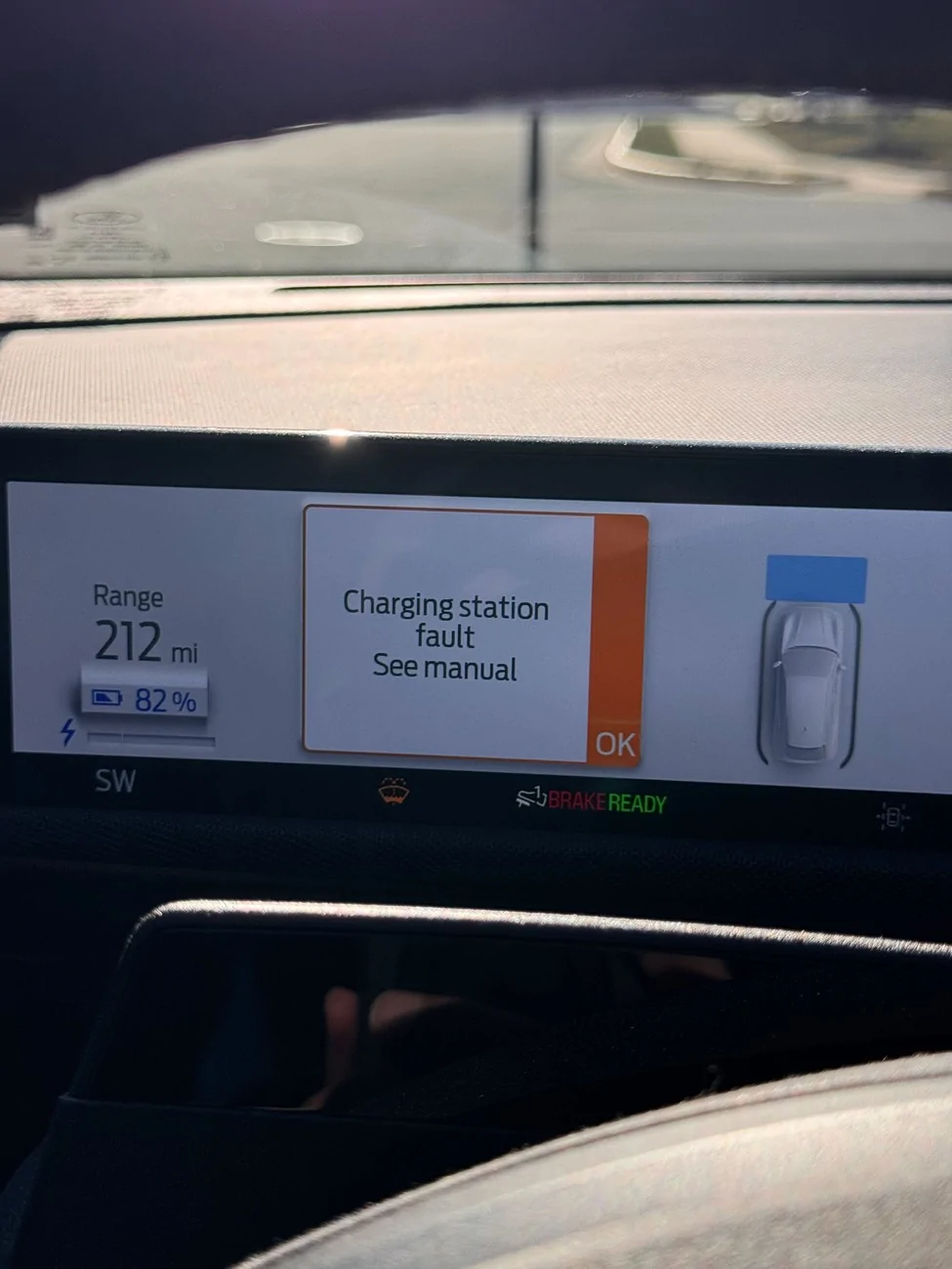

My Ford charger that came with the car is clicking for 3-4 seconds as soon as I plug in and then I see this (image attached). I have a NEMA 14-50 outlet. I tried swapping the plug on the charger to the 110V one and connecting it to a normal outlet and still the same issue.
On the car, it is flashing red on the charging lock icon. Hoping it is just the charger and not the car!

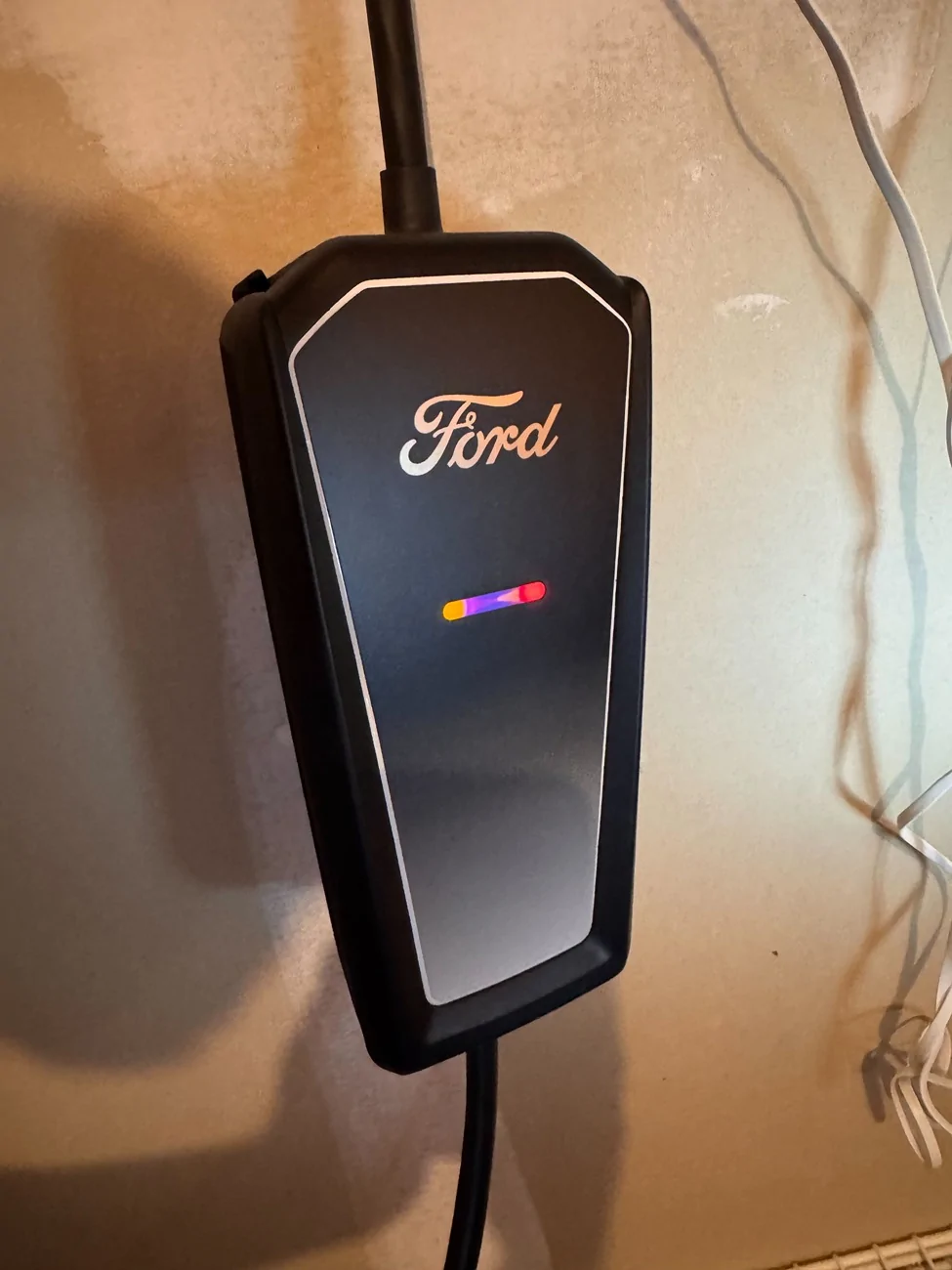

With the charger not yet plugged into the car, it must have a blue light. Otherwise, it has a problem.
Doesn’t show anything on the charger while unplugged. When plugged, it flashes amber

That is the car. What lights are displayed on the charger when plugged into the wall, but not the car?
The Amber flashing lights are when it was plugged in and it is trying to charge.
Just tried charging at a nearby Chargepoint and it worked. The Ford charger makes 3-4 clicking sound as soon as I connect it to the car. I'll check the lights in a bit since I'm out now but def seems like a charger issue.
I even tried a standard 110 outlet and with the charger and get the same behavior.

I recently purchased a 2022 Mach E from a non Ford dealer. They said the charger which came with the car was broken. When plugged into either 220v or 110v, the charger showed a fault. I took it home anyway, called my Ford dealer and made an appointment. At home the charger showed a fault on both, 110v and 220v.
My dealer told me that sometimes the car will fault if the wiring of the source voltages are not proper. Using the 2025 Ford Mach E app, they connected the car, set the amperage to 40 amp maximum charge rate and charged my car using the charger. It immediately began working properly!
I took it home and it works properly at home now. All I can say is, my 2022 Ford App does not allow me the same screen as the 2025 app. I can't set the amperage but the same app used on 2025 Mach E's can.
