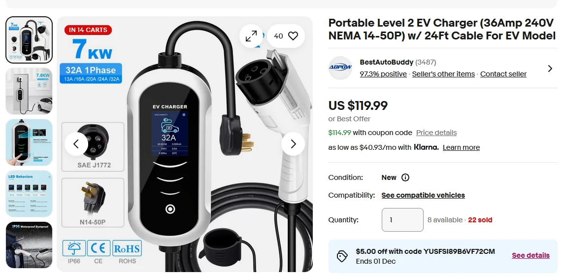

After 4+ years of trouble free service with the Ford Mobile Charger I purchased the below unit and put the Ford one in the trunk. The Ford EVSE never gave any problems other than throttled throughput when it got hot. The new one works just as well and didn't cost an arm & leg.
Ford Mustang Mach-E Is my Ford charger cooked? 1764541429993-ja
