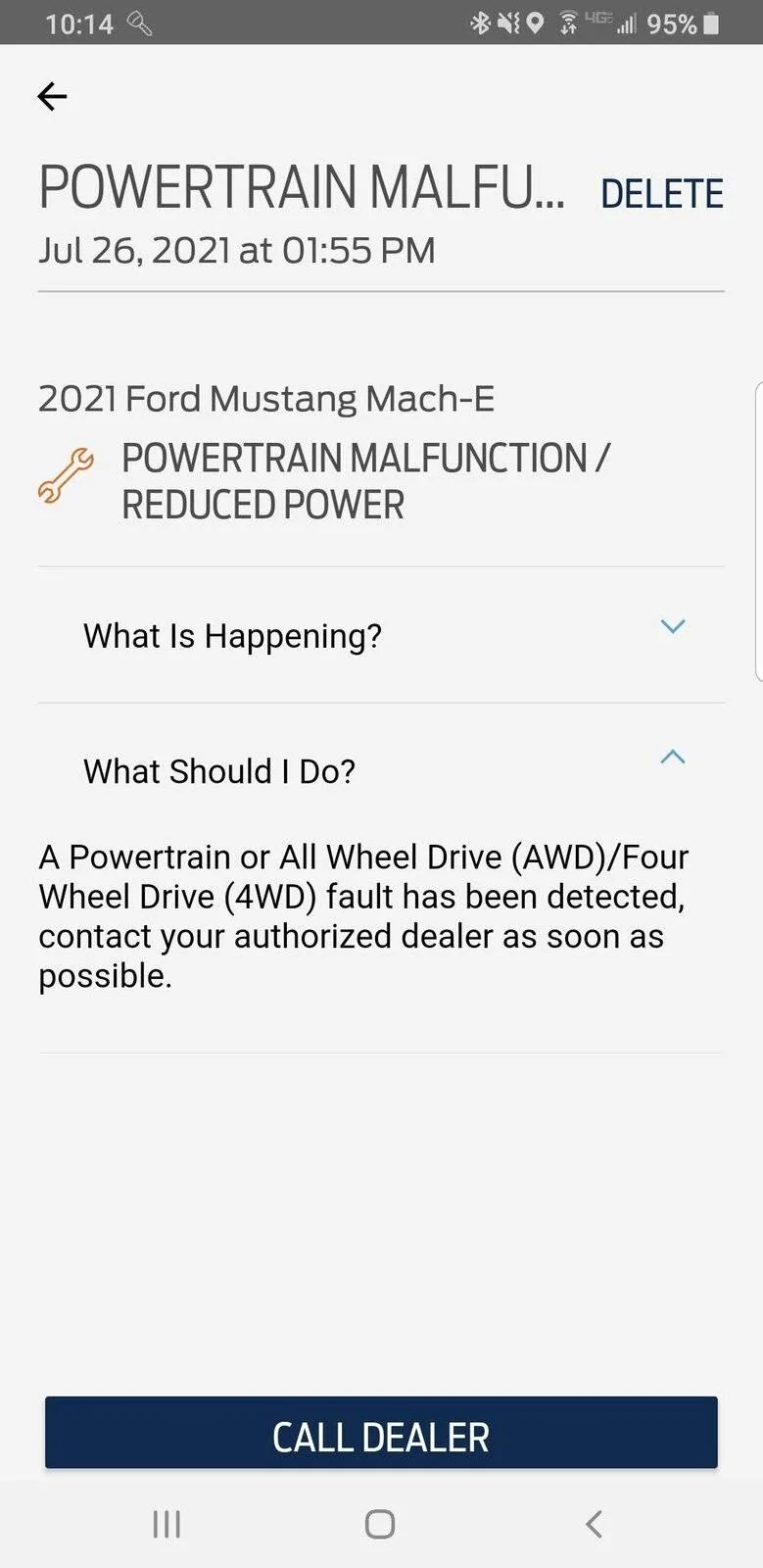

I got this error the day I picked my car up. No symptoms that day and no issues since then. I chalked it up to a glitch in the matrix. YMMV.
Ford Mustang Mach-E Issues Coming Up Before Accepting Delivery Screenshot_20210729-101441_FordPass
