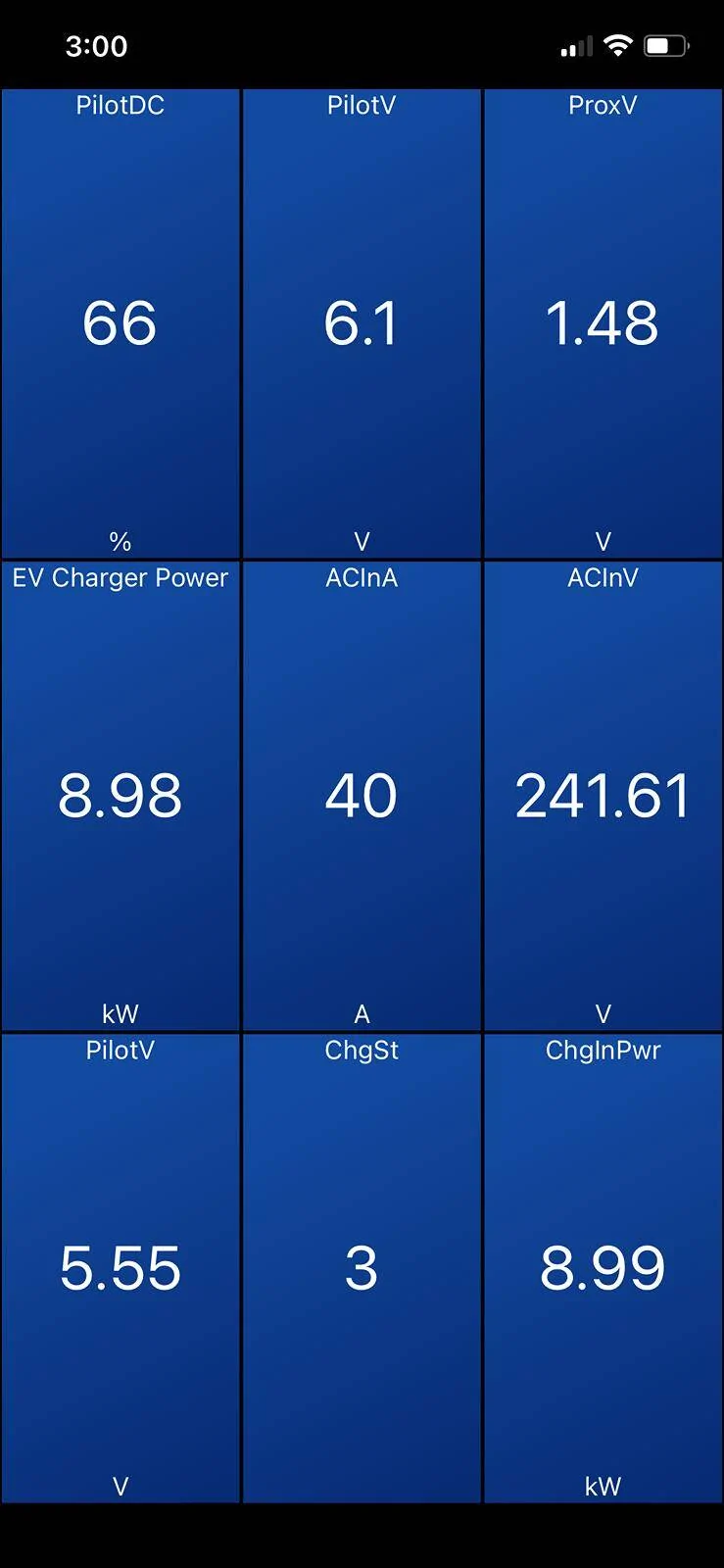

FYI if you use Car Scanner you should look at the relevant AC charging parameters, the window you were on is not that useful for Level 2. These are what you want and what it should look like while charging:
Ford Mustang Mach-E Issues during Level2 charging IMG_2917
They should all be relatively stable while charging. You'll have to see which number gets messed up first when it stops charging and that will be a clue.

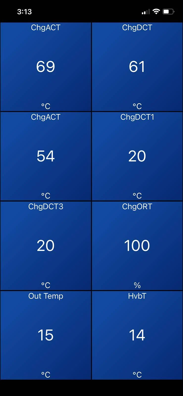

And the temps:
Ford Mustang Mach-E Issues during Level2 charging IMG_2918
And the temps:
I will re-test again in some EVSEs and get some screen recordings of those parameters.
