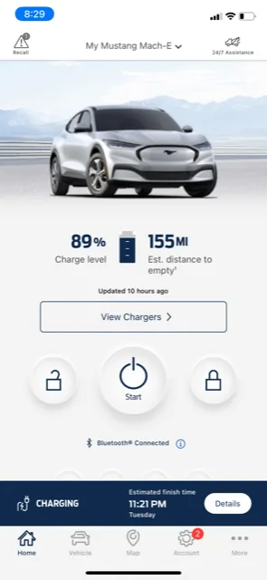

It's a little frustrating/annoying that I'm leaving my house with 75% charge instead of 90% despite it sitting in my garage, plugged in all night.
Are you saying that you charge to 90% overnight and then when you unplug in the morning the car says it’s at 75% state of charge? That’s an entirely different problem than what you initially described and isn’t normal behavior.
No, because he shows a picture with 89% and 155 miles.

Also, the 90% dropping to 89% may in fact not be loss, but "rounding". I sometimes see this change when I back out of my garage, and I haven't used 1%.
In addition to rounding, I’ve found this is also an artifact of when preconditioning stops vs. how long the charge is running. For example, if I pull the plug in the middle of preconditioning, the charge hasn’t completely kept up with the preconditioning process, and 90% rolls to 89% really quickly. If preconditioning is complete and I’m a few minutes late getting out, the charge has replenished back to the “full” 90%, and it takes a while before I see the drop to 89%. This is similar to leaving it plugged in for a 90% charge and then taking it out in the middle of the day without the preconditioning process. If it’s not particularly cold, that 90 to 89% roll-down happens slower than if I caught it in the middle of a preconditioning cycle.

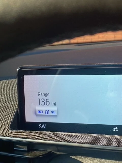

The OP is saying that at 90% charge he used to get a displayed range of 190 miles, and now gets 155 miles, a reduction of 18.4%. He's in Massachusetts, it's now cold, and this is due to the GOM sensing the colder weather, nothing more. He shows how it's accurate saying he then drove 19 miles, and the range is 136 miles, 81% 155 - 19 = 136.
At 100%, that 155 would turn into 172 at 10)%, with his Select AWD.

I get that. But then I don't understand this comment about an ICE car leaving the gas station with a full tank.
A lack of understanding. His battery is still at 90%. His RANGE is predicted to be less due to the cold. Identical to an ICE vehicle with a tank at 90 or 100% full, but it's now cold and it has winter gas. A 20% drop in performance for an ICE vehicle in winter is totally normal also. Same level in the tank, less MPG.
Exactly, basically the reduction in range is merely the MME predicting that based on the cold, I can only get 155 miles instead of the 190 I got before.
Right.
Your ICE vehicle doesn't take into account things like temperature. It looks at your driving history, and predicts the future. So if you drive in the city and get 15mpg, then it predicts based on that x your tank (assuming you drive a few 100 miles). If you drive on the highway and get 30 mpg, it predicts on that.
The EV uses things like temperature and altitude, as well as history, to predict in advance. It assumes the worst, and then you go an prewarm the vehicle on house current, or use less heat than it thinks you will.
As stated often, the best predictor is to drive in the conditions and note your miles per kwh, then do the math for the future.
