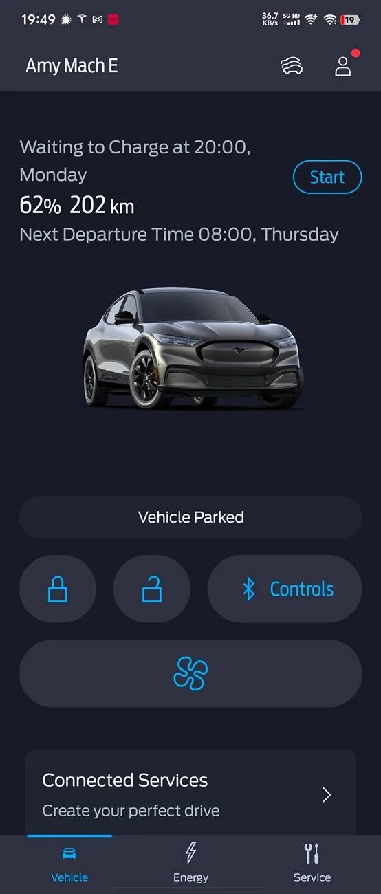

So I went ahead and plugged in the car 10min before 8pm came around, and it says getting ready to charge at 8pm
But it never started. I tried hitting the start charge at 8:15 and it wouldn't start. I tried waking up the car by changing the charging %, and start charge button still doesn't work.
